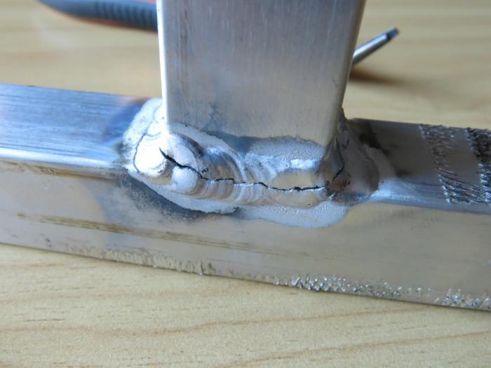

Hi,
For some time I have noticed I'm not getting full penetration on aluminum tube.
The settings;
200+Amps AC, 25% Cleaning (or 75, Kempii is backward here), 120Hz rounded squarewave.
12 LPM Argon, electrode 2% lanthanated 2.4mm. Filler Rod 4043, cleaned of course.
Aluminum is 6261 - slightly stronger version of 6061. Cleaned. One inch square, 3/16 wall thickness. Actually 25 x 5mm.
The side faces were bevelled, the fillet joint not. I've tried gapped, bevelled, plain, plain gapped. All the same.
Yes - I did have a little oopsie and dipped the electrode. The electrode is running OK, tip kinda rounded, purple when cooled. The puddle looks OK, no cracks post weld. Some small bubbles in the weld after "disassembly".

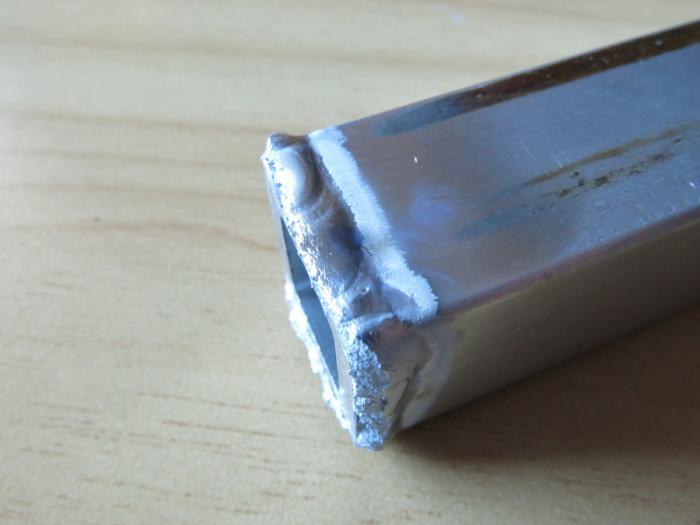

The problem is that when I had to take some frames apart I noticed the penetration wasn't very deep. To get them apart you have to beat the daylights out of it ie. it's not really lacking strength. By day lights I mean big vise, 4lb hammer, many strikes.
Any thoughts ?

Thanks. I see it that way too, while the AL is shiny and liquid when I start adding filler, it's not deep. I'll try a 3.2 electrode shortly.
Hi Gavin,
Couple things that I see -
I think the welds are a bit cold for that joint and thickness, don't forget heat is being disbursed in three directions. Preheat may help, so would more amps and/or the addition of helium. Bevelling the joint would assist penetration.
Changing to 5356 filler would be a better strength match to your parent metal.
Finally I think those welds are under sized, put another run over the top and that should solve the shrink cracks you have there.
Rounded square wave can also limit penetration, try straight square wave if you have it.

Try 4943, its known to be stronger than 4043, especially in fillet welds.
I think you need to bevel more and bring your amps down, 200 A is too much for 3/32" Bring the bevel in so its a 3/16" thickness instead of 1/4" or whatever it is.
If you need to get 4943, call Hobart and ask for a sample of their maxal TIG, stuff is fantastic.
Its odd that your cracking in the center of the weld, I only ever really see that when I fusion weld aluminum which I don't really do because it almost always breaks once the joint cools and looks similar to that.
I think you might be bridging the weld so instead of welding into the joint, you are creating a blob that hits the top piece and then bottom piece but not penetrating the root. You need to wait for the puddle to generate and since your metal is so fat, you don't have to worry about burning through, so put the heat to it after beveling it, wait until you see that puddle before adding filler, you should be able to SEE the 2 pieces joining at the root.
You don't get full penetration on AL. If you did it would all drop out on you. I think you're dipping in the keyhole and bridging the weld instead of fusing the two pieces ad then adding filler(re-enforcement). Wait for the two puddles to fuse into a point and then dip. Like Coldie said, looks like your welding cold. You should have an instant puddle ...no waiting...turn up the heat.

I can't get 4943 in New Zealand - just get blank looks.Olivero wrote:Try 4943, its known to be stronger than 4043, especially in fillet welds.
Agreed about bridging. I probably have two puddles which I bridge. I've always had trouble with fillet welds, perhaps this is why.

Those cracks are not hammered cracks they are hot short cracks (shrinkage) caused by undersized weld with insufficient heat.
5356 filler is the best choice for this joint for strength.

They aren't hot short cracks, it looked fine before I beat it to death. If you look at the vice marks you can see how hard it was to break.

I see in the original pictures a complete lack of root penetration. I also saw a comment that you can't get root penetration without the weld dropping out.
That's nonsense. I see in the broken weld picture you didn't even nick the edge of the tube. You're building a weld bridge, not making a weld joint. The root must break the edge of that tube if you want strength in the joint.

I realise I'm not getting root penetration, but the comment about the weld dropping out wasn't mine. A work in progress.
You've gotten all the right information, but its scattered all over the place within these posts...
- 200 Amps is low for the wall thickness, especially on an ally joint. Bump it up.
- Probably, your tungsten is too far away from the joint when you hold the cup into the notch. Lay your filler wire along the joint, place your cup, then look how far away it is. Ideally, it will be just farther than the filler thickness.
- Preheat both pieces to establish a puddle faster.
You can experiment with these settings by tacking. If you can get the weld to be more concave than convex, you're getting it deeper. 1"x3/16" square tubing is a fright to weld because the heat accumulates so quickly that you can not loiter once you get your puddle, but you have to get the puddle right first. Start away from the corner, then back up to it, or weld from the middle of the face around the corner to the next. Starting and stopping in the middle and tie-ins in the middle. Easier to avoid blowing out your tubing if you are welding fully around the tube.

All that makes sense. If I join the faces first and extend the weld a little around the corner I get better results on the fillets. I'll try starting in the middle on this. I've only got 230 Amps, so that will have to do.
In the past I've ended up with concave welds once I got things hot enough, needing a second pass.
