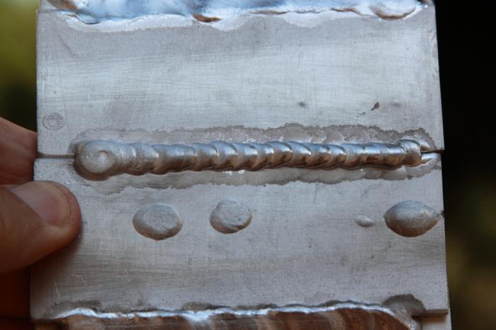

Here's a butt weld from today.

Gene.243 wrote:I'll agree it's too hot to be outside much.
Only be constructive, not critical: I suspect that joint is pretty weak and has insufficient penetration. Examine the backside of it. And occasionally, bend the piece in your vise to test your welding.
The reason I assume this is because your bead is tall and narrow, not flatter and wider. It's an indication of a cold weld. That can be too little amps, too much filler added with too fast a travel speed, or simply being new.
The lap joint bead shows a lot better technique for travel and heat to my eyes. But whenever you're making those "shiny worms" in a butt joint, you're probably not getting the penetration you need. But your lap joint looks really good!

cj737, Thank you for your reply.
I agree it is a tall cold weld. I was happy to have somewhat evenly spaced beads and a button instead of a crater at the end that I posted a picture. I still have a long way to go and I plan on getting there. Can't do it without help.

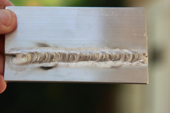

Today's lap looks like...

Here is one after washing yesterday's butt.
You can laugh at my jokes but not my welds.

Today's butt.

And for today's lap joint proudly welded at 125 amps...

Gene.243 wrote:And for today's lap joint proudly welded at 125 amps...
I see progress.. Doesn't it feel good when things start to click? :D
