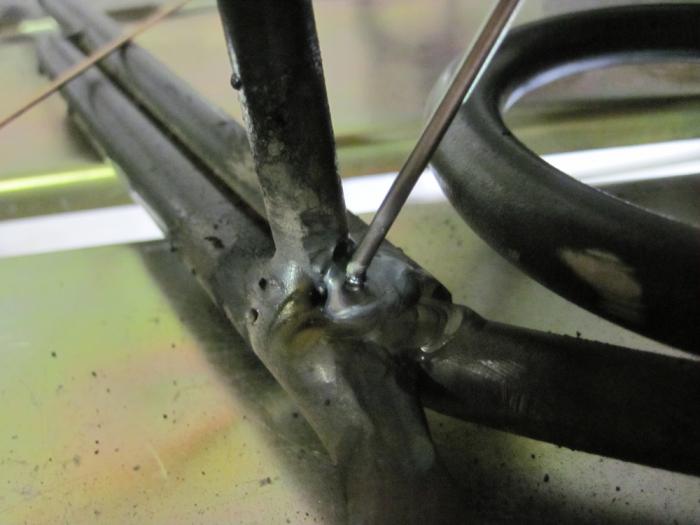

I think I figured out what a contaminated weld puddle looks like. This would be tungsten contamination.

Today's contaminated pool is a 309LW failure.
Leaving the wire stuck in the puddle isn't contamination. It's something I do regularly. I use it as a location to taper of my arc as I reposition. Then I just light back up on the wire.

Yeah yeah That's what I meant.... I always do that on purpose. :lol:
cj737
    Thu Sep 29, 2016 8:59 am
And doing that also protects the filler wire from contamination from being exposed to the atmosphere. It's commonly intentional for stainless pipewelders to do this. Now, if it were your tungsten, that would be a different story... :o
Gene.243
    Sat Sep 27, 2014 8:43 pm
    Southwest Oklahoma
That was the "W" in the failure mode. At one time I had 2 tungstens and a filler at the same time.
