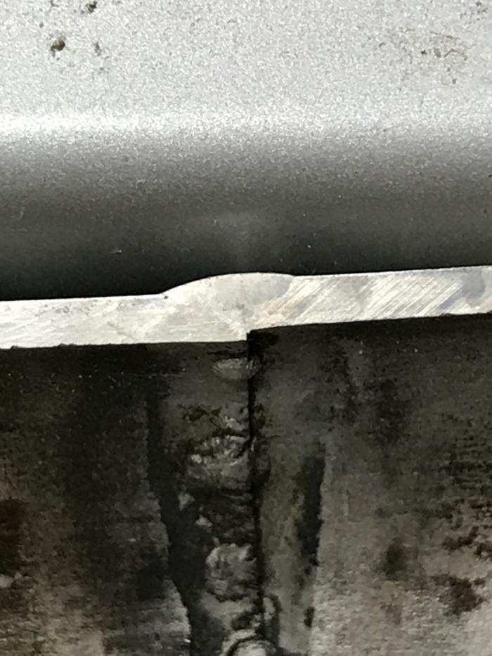

About 18 months ago I designed a serpentine cooling coil for an industry colleague that was subsequently passed to to dedicated stainless shop for manufacture as it had over 800m (2600ft) of tube in it. 25mm x 1.6mm (1" x 1/16") 316L seamless tubing.
My colleague rang to say it sprung a leak at one weld joint and that he engaged a local welder to do the repair as he didn't want to bother me with such a small repair. I asked him to instruct the repair welder not to attempt to repair the weld but to cut a piece out and weld a new piece in so as to preserve the faulty weld for inspection as there are many welds in this coil and we need to know what we are up against.
I retrieved the cutout, here it is:
I sliced it in half with the bandsaw in vertical and prepared for macro inspection by polishing with 1200 grit wet & dry.

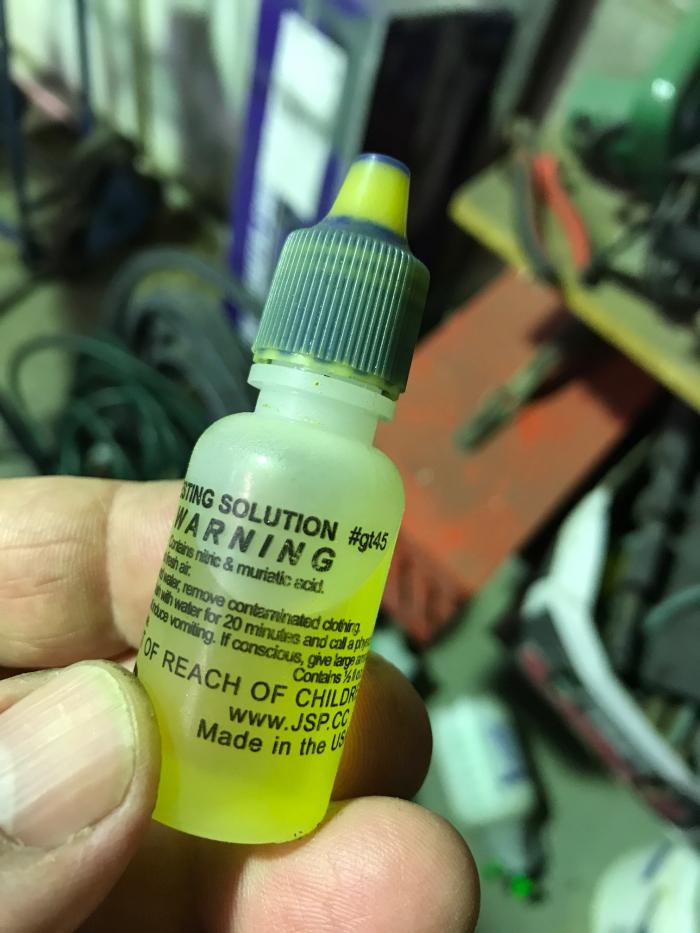

Taking Otto's advice on muriatic acid I used the following etchant I had on the shelf:
Here are the macros:
Based on these what we see here I recon the chances of getting more leaks are high. The customer has told my colleague there better not be anymore leaks.
Don't know where this is going but my guess is it's not going to be pretty.

What was the criteria specified for these butt welds?
Full pen.?
Partial pen.?
Any WPS written by or furnished to the company doing the welding?
Any setup/test coupons required before production?
Any post weld inspection criteria?

My involvement ceased after design and took no part in the procurement process and installation so I can't answer most of the questions.
The design called for full penetration weld, purged with 100% argon. Pressure test to 3000kPa, and compliance with our pressure piping code AS4041. This code does not have any prequalified procedures so the there should have been a manufacturer's WPS in place for this project if it was to comply.
What actually went down is unknown to me but it would not look good for the manufacturer so far.
If it's subject to the stresses of cycling temp change. As a cooling coil I'm sure it is. Then it would indeed need to be full pen. Or reasonably close to that. But from those macros I'd say your Spot on that the money they saved on the install will cost them lots more in the future.

Scary stuff. We reworked about 250 welds like that in sch. 160 stainless, where the builder just butted and crowned them just like your macros. This was hydrogen gas service with a MAWP of 8800 psi :shock:
Crazy thing is, the client swore it was a 10% x-ray job, but couldn't find the documentation. I know not one weld on it was x-rayed, because not one weld in the system would have passed.
