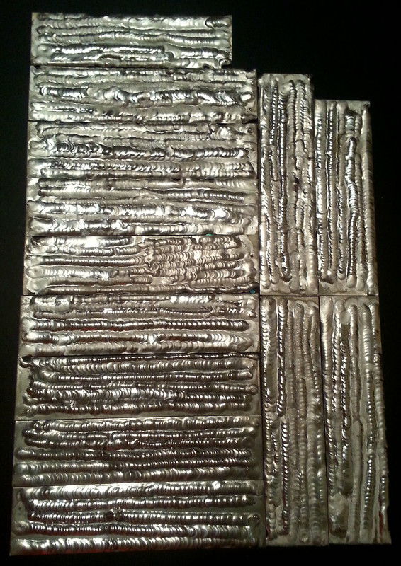

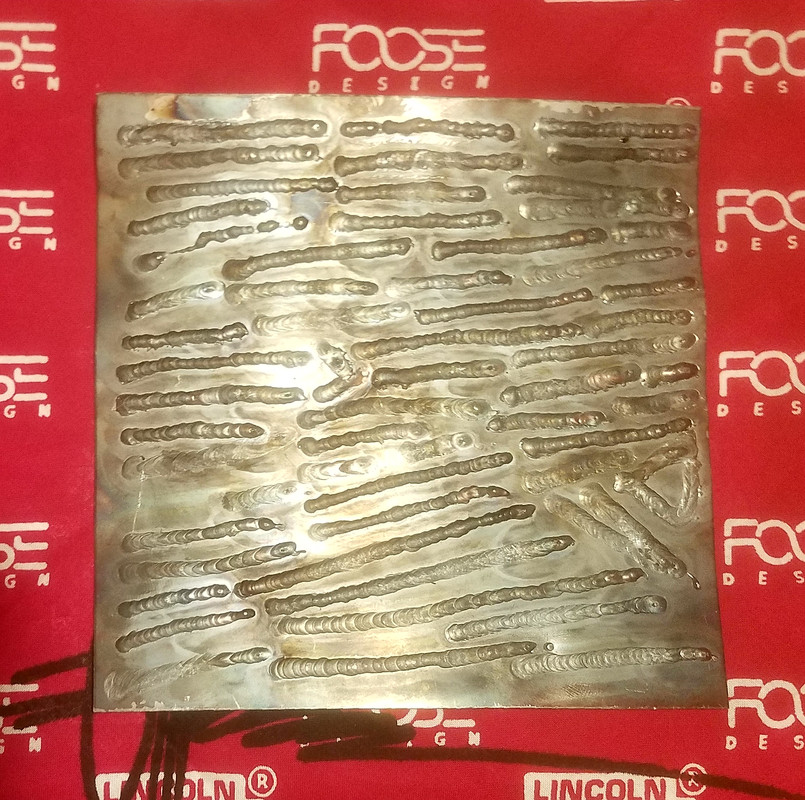

Time to start working on penetration.
Ran a bunch of beads on 1/16 inch steel with the home torch. Cranked up the amps. Did these non-stop, so the metal got very hot. Got penetration, but have a way to go, before making good dime stacks on the back of the weld. Usually, if I get good penetration, the bead isn't convex enough on the top. Will keep practicing.
Kodokan
    Thu Nov 04, 2021 2:05 am

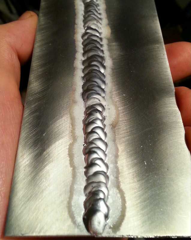

If you look at the last pic of aluminum practice, there's no cleaning/brushing off the oxide layer. Takes longer than welding, so I was skipping it. Didn't realize how important it is.
On tonight's aluminum, I scrubbed everything. Wasn't going for good looking beads. Just wanted to work on penetration. Went from 65 amps to 100 amps on 1/16" aluminum.
Feels like I'm on the right track.

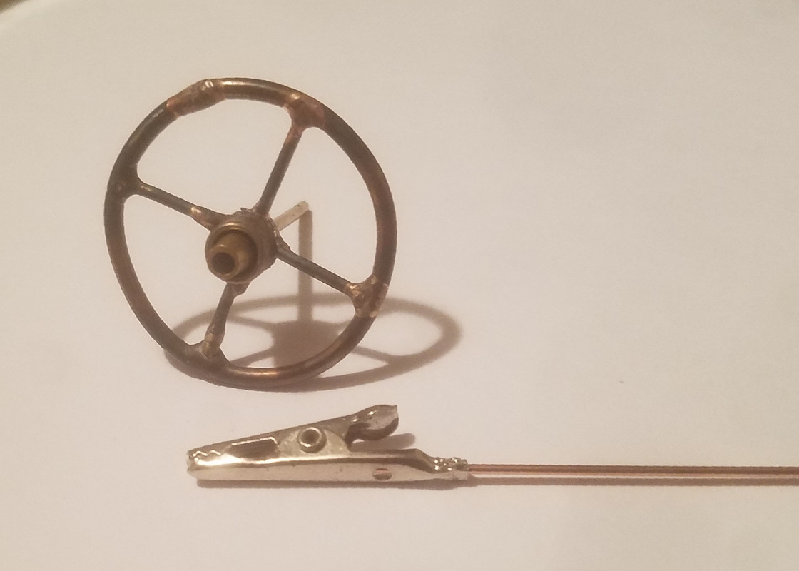

Burner frame for the hot air balloon, and a third hand which I simply hold with a vise-grip. I rest the magnetic cricket on the vise grip so the small piece being held is grounded.
Made a jig to hold up the burner frame while I TIG braze the struts to the basket. Then, I'll remove the jig and braze to the frame.
tweake
    Mon Dec 18, 2017 4:53 am
    New Zealand
nice going, keep it up :D

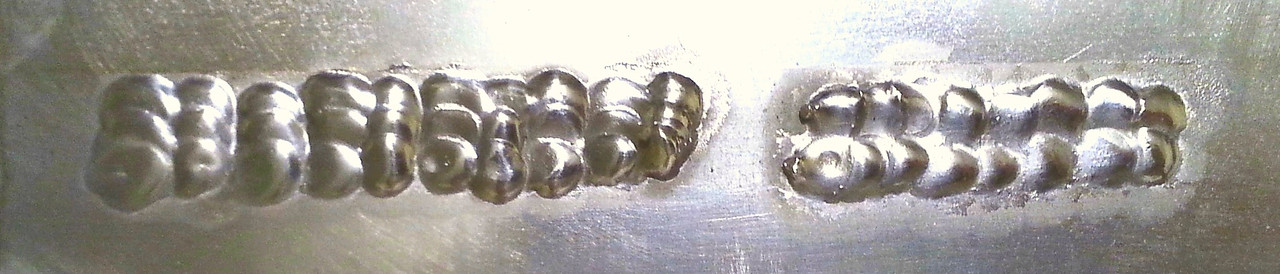

Only laid down 3 beads last night. Here are 2. Starting to get some decent penetration.

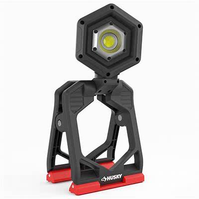

Looking for a small rechargeable fan.

This is the fan I've been using. Works great!

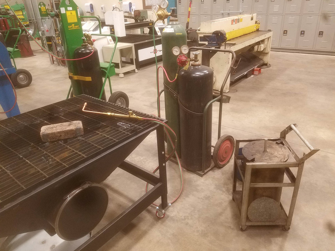

Yep. Was watching a "Forged in Fire" marathon that day. Found a couple of rusty scraps in the garage to use. Took about 1 1/2 hours. Sharp on both sides. Never tried anything like this before. Did all the brazing with the TIG torch.
So long as it doesn't blow away the shielding gas, looks nice and compact!
Kodokan
Yeah. When I lower the shield, I turn the rechargeable light on, and the fan off.
Before I raise the shield, light goes off and fan goes on.
Light is awesome, but don't look at it without protection. It's super bright!
Husky 1500 Lumen LED Rechargeable. Highly recommend it.

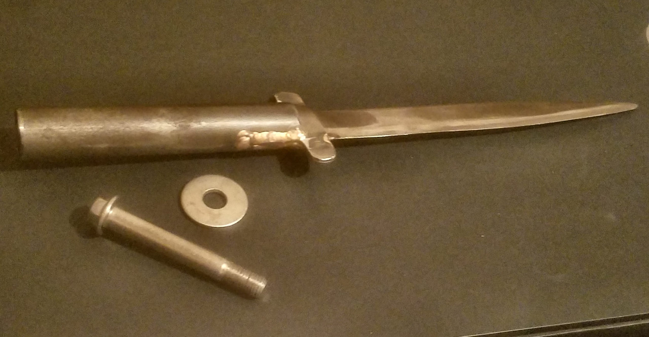

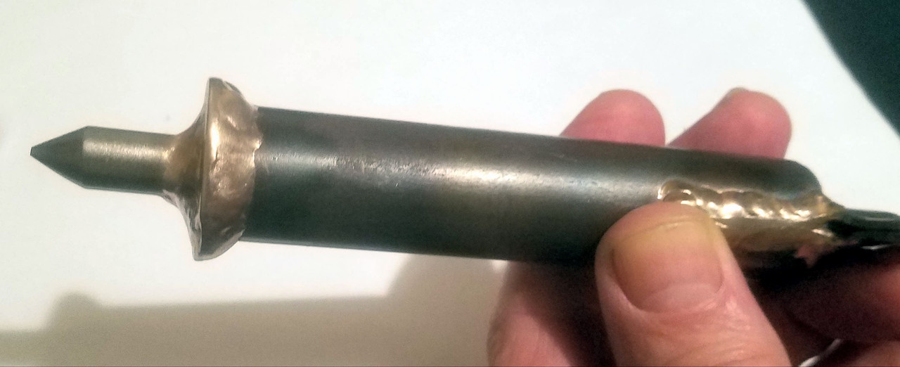

Dug out a washer and bolt from my scraps for the skull crusher. Not a traditional skull crusher, but cool for my prison shank style.
Came out okay, but I realized it's too long, and could get stuck in a zombie skull. :mrgreen:
Cut it down to a more traditional size.
This project will never be a keeper. It was a challenge to see what I can do in one class. Now, I'm just having some fun with it. I don't have a clue if this mild steel (I think) is hardenable steel, but I might try a quench, using an O/A torch.
If I had anticipated doing more work on the shank, I would have welded, instead of brazing. Just chose brazing because it looks cool.
cj737
    Thu Sep 29, 2016 8:59 am
You’re running too hot on your SilBr which is why your beads are indistinguishable. So either lower the heat and move more slowly, or stuff a lot more filler in (even upsize the rod if needed).

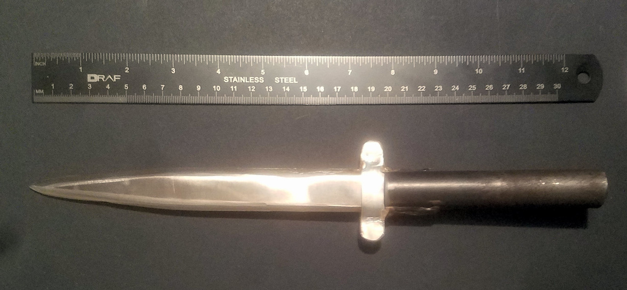

Kodokan
Yeah, you're right. I was practicing TIG brazing beads for a while, but lost some technique when I had almost a month off.
When my beads on this look janky, I've been using the TIG torch like am O/A torch. Been running the torch a second time over the beads and smoothing out the bronze. Thus, no dimestacks.
I was rushing because I wanted to complete it in one class.
I'm having fun with this one, and it would be cool to try to make a nice one with beautiful bronze dimestacks. Need to get more basic practice in first. I'll keep your advice in mind, thanks! I could definitely use some larger filler rod.
Kodokan
Heated the blade to that bright salmon color with a rosebud tip, and quenched in oil. Not sure what type of oil was in the quench tank, but it was very light and clean, like vegetable oil.
File skates over the blade, and makes a nice high-pitched sound. I do believe it worked! :mrgreen:

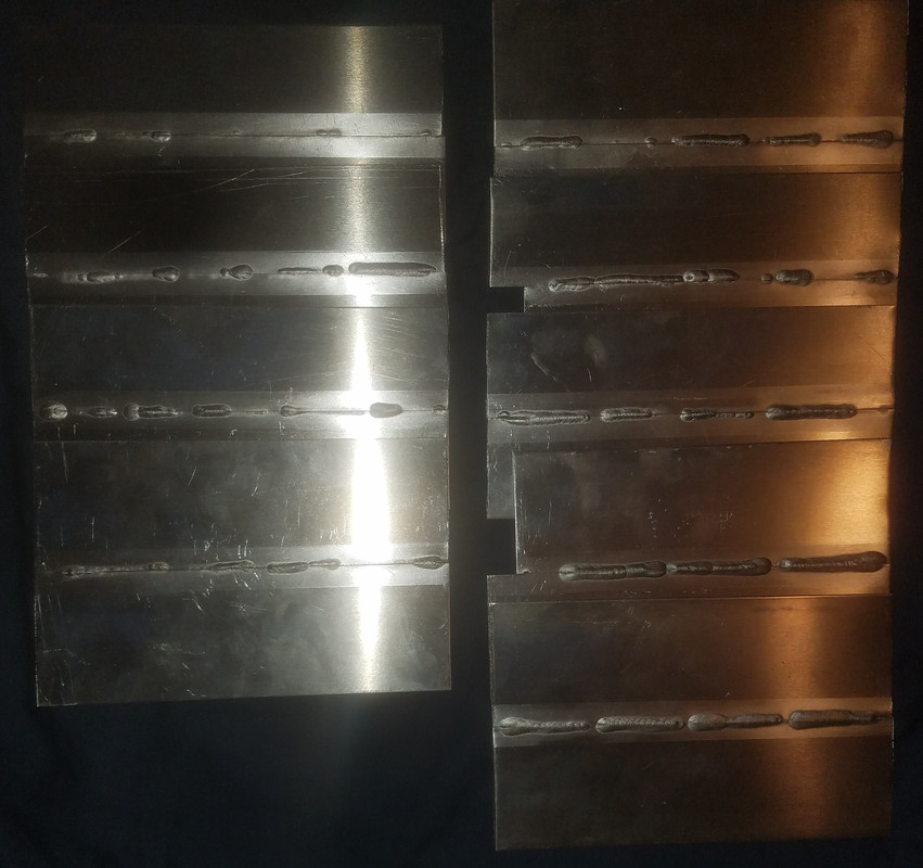

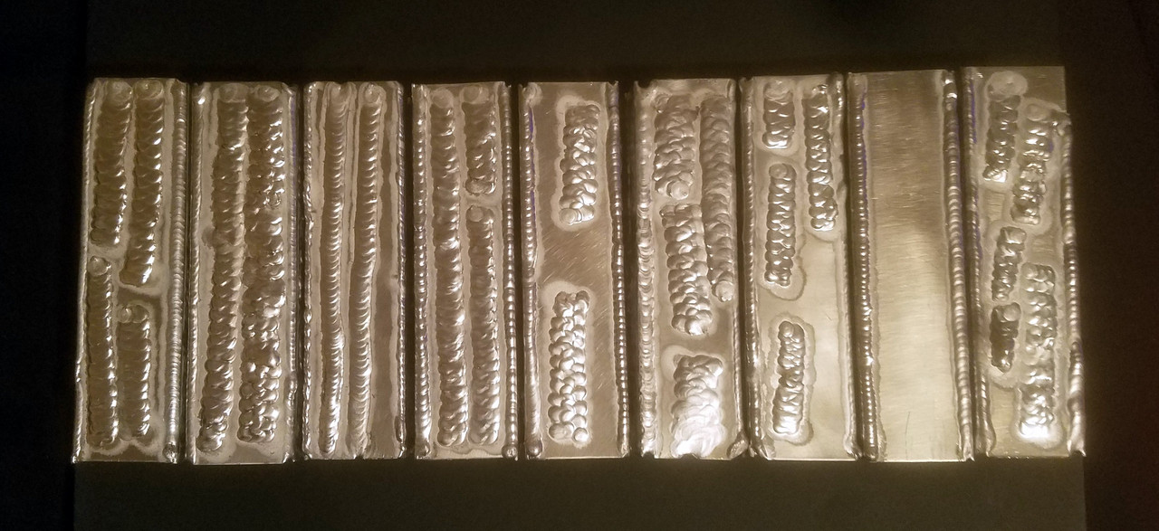

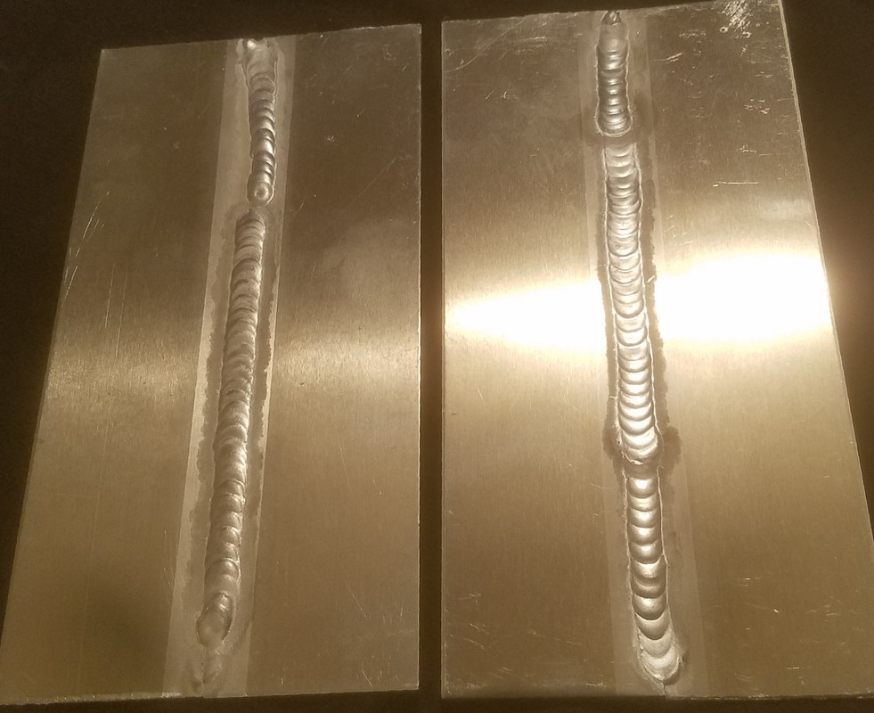

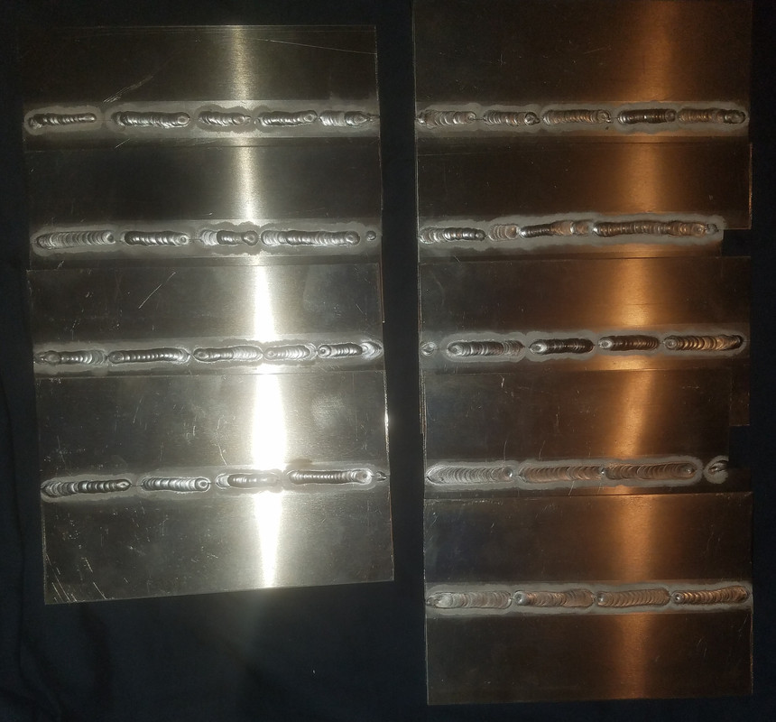

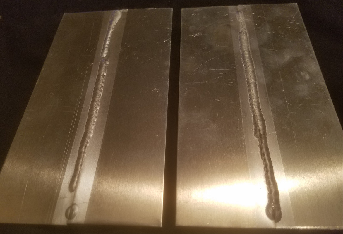

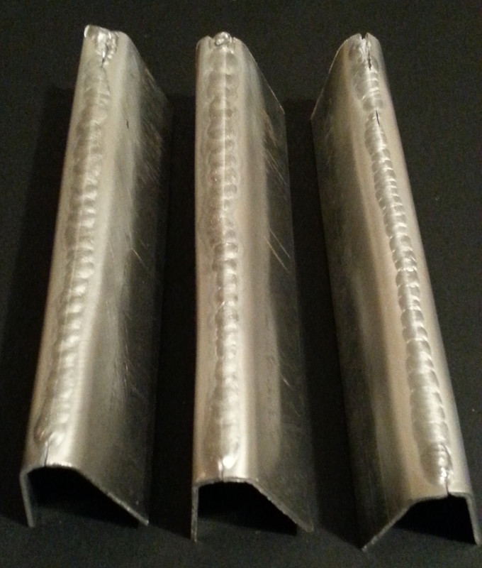

Getting back to basics. Started doing some aluminum butt welds, focusing on penetration.
Have a long way to go, but improving slowly. Was able to go non-stop, start to finish, on about half the beads- that's new. Still have to stop and re-start sometimes to adjust my torch hand, or the filler rod.
Got some penetration on all my welds, but need to work on consistency. Also, my starts, stops, and spot welding need a lot of improvement.
Got a mix of convex, flat, and concave beads. I started noticing a small divot in the weld pool before it sinks down. That helps. Also getting better at filling up the depression fully with filler before moving on.
My travel speed is definitely too slow. Having decent results, but I'm sure the coupons would be very warped, if I wasn't using a welding/purge fixture.
Getting better at staying on-line, and not veering off in the wrong direction.
Front sides:
Back sides:

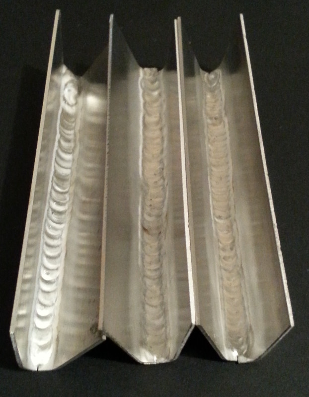

cj737
Don’t need a purge for aluminum, only Ti and other exotics.
Convex beads are an indication of insufficient heat (too low on the pedal or too fast with your travel- you decide). You can weld aluminum slowly, in fact it’s better. Take your time but control the heat so when you add filler, loiter until the puddle gets to the width and height you seek, then move. Lots of people make the mistake of getting a puddle on aluminum and then tearing off because they forgot to reduce/fade the heat while welding.
If you were to weld 1/8” coupons that were 4” long, I’d set my machine for 150-160 amps. I’d get my puddle and dip, get my bead right, then dip and move and wait. By the 6th dip, I bet I’m down around 105 amps to keep my puddle and beads under control. A sinking puddle is good indication you’re getting the penetration you need. Better to gap the joint slightly instead of trying to drive filler all the way through. For practice I get why you’re doing it, but in reality, for material that thin, full-pen is not likely. For full pen joints, you’d be thicker and beveled edges (or gapped joints). Just saying… don’t fret not being able to do something that isn’t “real”.
Your latest pieces look really good and would certainly be suitable for use in the real world.

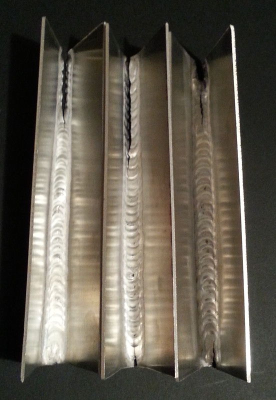

Thanks, cj. Will definitely take your advice. Should mention, I was just using the purge fixture to hold the coupons, not actually purging with argon.
I think the reason the instructors are big on penetration is because most students are focused on certification. I guess it takes a strong weld to pass the tests.

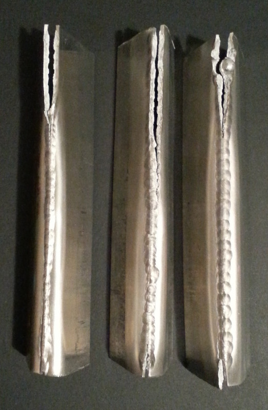

I've got a stack of aluminum coupons with various quality of beads from my practice. Thought I would test some, and see how they hold up. There's a big press they use. I think it's 20,000 lbs of pressure.
I throw away the worst beads, and save the better ones. For testing, I started with the worst ones that I kept.
First 3 pretty much just snapped in half.
Next 3 ripped apart on the weakest part of the welds.
Last 3 held together pretty well.
Still hanging on to my best ones for a while. Functionally, they're probably okay. Need to work on consistency, and better appearance.

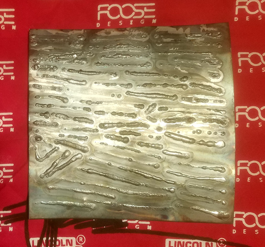

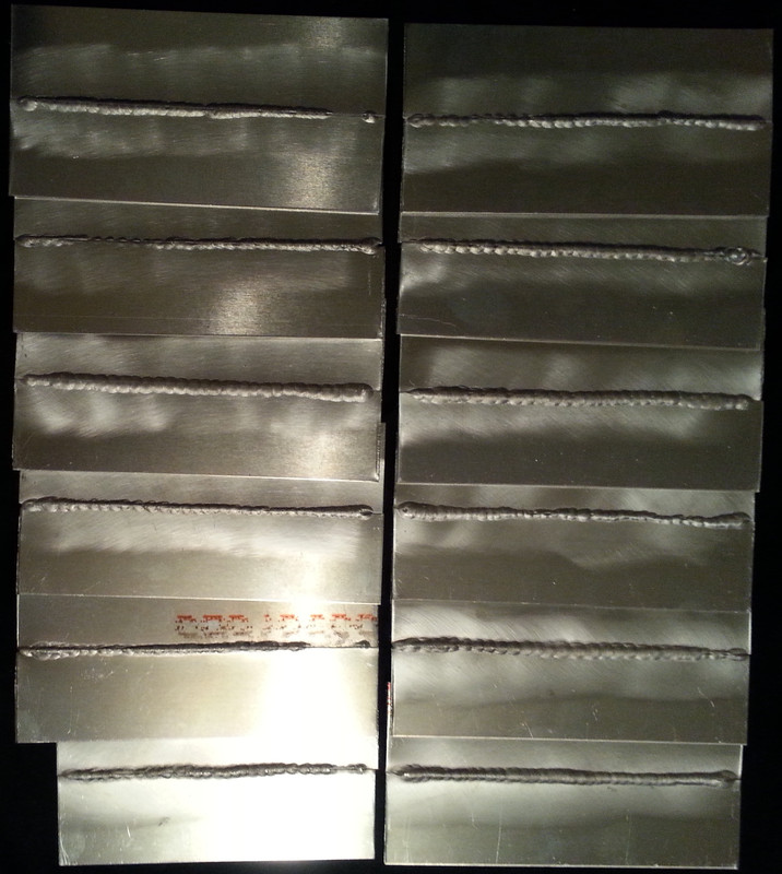

Trying to figure out some better technique. Did some padding on aluminum sheets last night. The sheets are 1.5" x 6" and I covered at least 7 sheets. I was looking at the beads at the end of the night, and realized I welded over 25 feet of aluminum. The welds aren't beautiful, but should get better if I do more of this.

Still have to try fun stuff, once in a while. First try weaving a weld. Need to tighten up the dimes, they're hardly overlapping. The double and triple weaves were done in one pass. Not good, but it's a start.

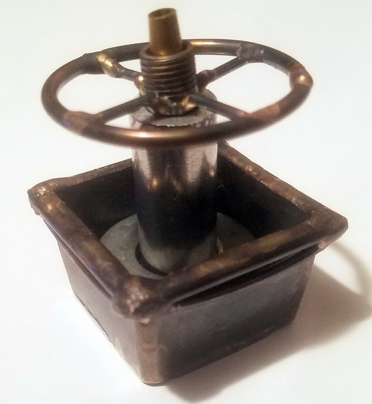

Still trying to have fun with welding.
First try weaving a butt weld.
First try weaving a butt braze.

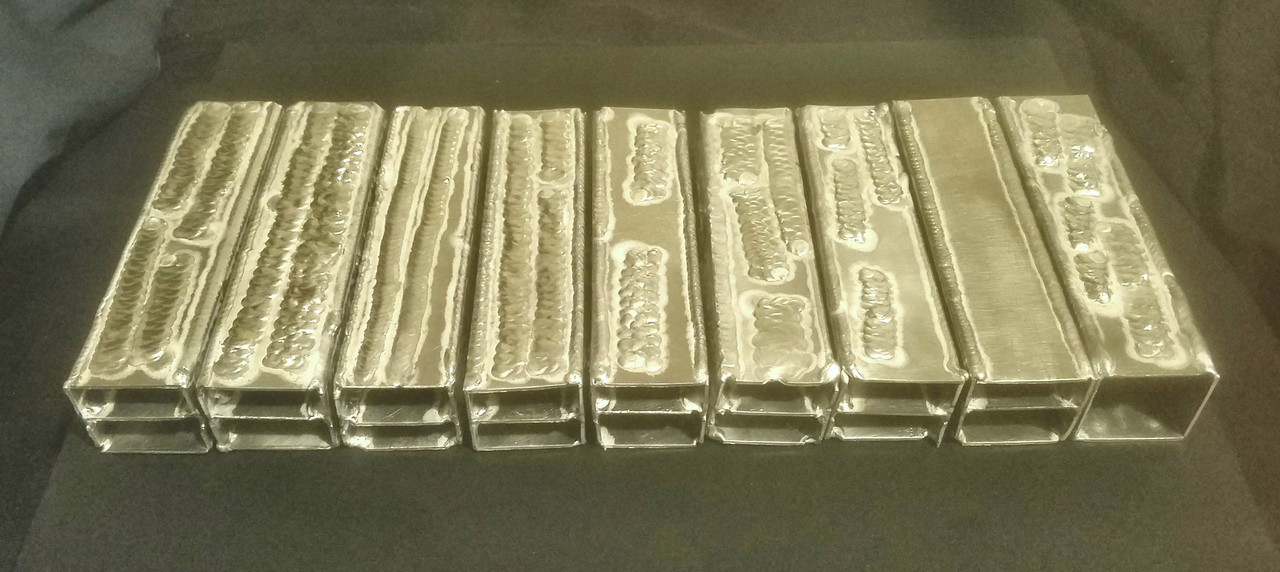

Lately, I've been using (5) 1.50" x 6.00" coupons to make these pieces. (4) fillet welds + (4) outside corner welds. Then, I run beads or weaves on the sides.
