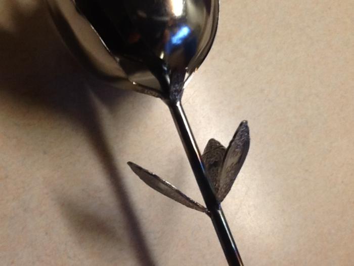

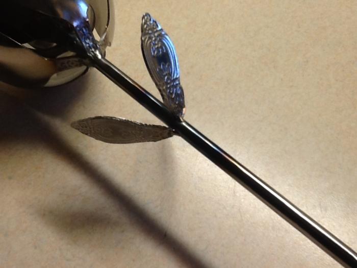

Made a few of these for some freinds sorry for the crappy pics.

WAAAAY to artsy and clean, wheres the dirt and dust?
I take it there's a shortage of T spoons at work this week?
Came out quite nicely.

I like it. Well executed. The ladies will love it.Welder kurt wrote:Thanks Spoon flowers aren't my usual thing but for a couple of women I think I can make them
It would sell, too.
Hell, it just inspired chillrich to make his first post here.
I'll admit I've been sneeking on to the etsy web site. They get some unreal prices for some of the decorative metal work. I've even started to play around with the scrap art. It's no joke. Welding some test pieces on scrap is one thing but turning it into something some one will pay for takes some real skill.

chillrich wrote:What settings are you using for the spoons? Do you have pics of the weld?
Thanks guys, I used my dynasty 280 DX, 45 amps using the pedal, .045 308 filler. The easiest way for me to do them was to dab a small amount of filler on the stem section them hold the spoon next too it then blast it with a quick tack weld to join the two. After their all in position I just welded them out. The they didn't like the stainless colors so I polished the welds a little. The pics were with my I pad and the camera is lacking.
