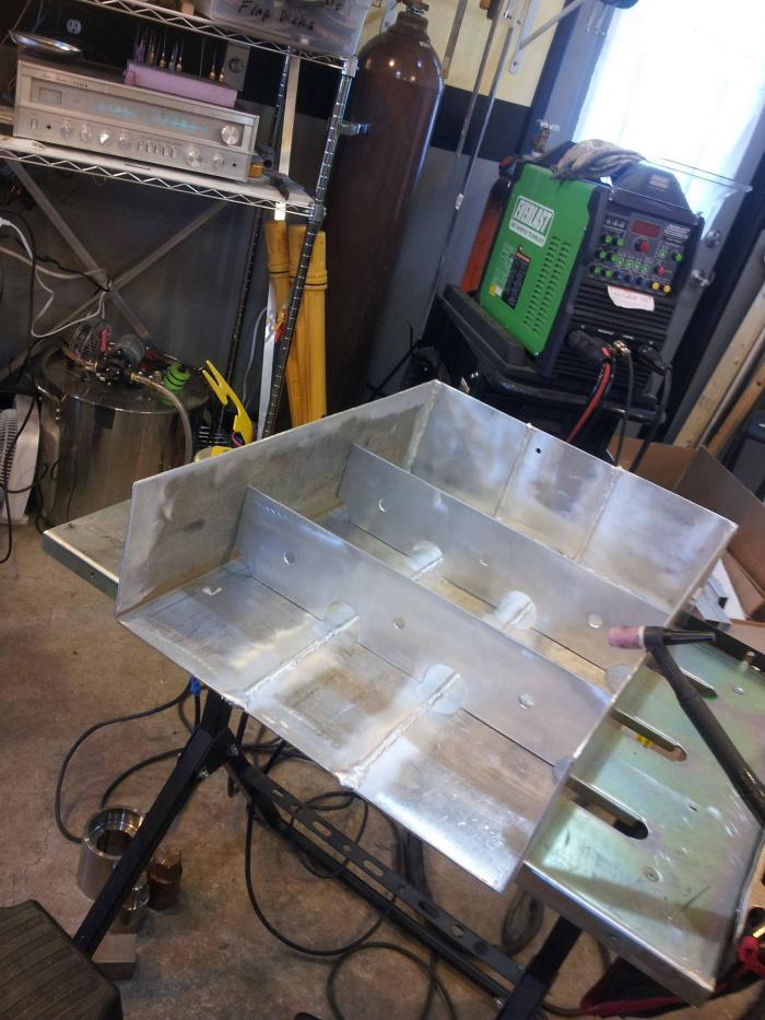

More practice. Started building a new tank for an old genny . Got a bunch of 12" box bins from my buddys scrap yard, 5052 , gauge says it's 0.128 " 3.3mm . I had to do a lot of this left handed and contorted ...sometimes difficult to see . Welds aren't too pretty and the beads are too big ! I did add extra filler at the ends of the long seams, I figure it'd add strength and wont see it anyway.
I made some ugly welds but I don't think I've got any porosity ...and it holds water .
Gonna try to make nicer looking welds on the outside corners. IT IS TOUGH welding inside something !
I also had some trouble with butterfly distortion soon after starting the long bottom seams.
I haven't welded the outside seams, outside corners or top yet . This was my test piece for when I weld the outside corners

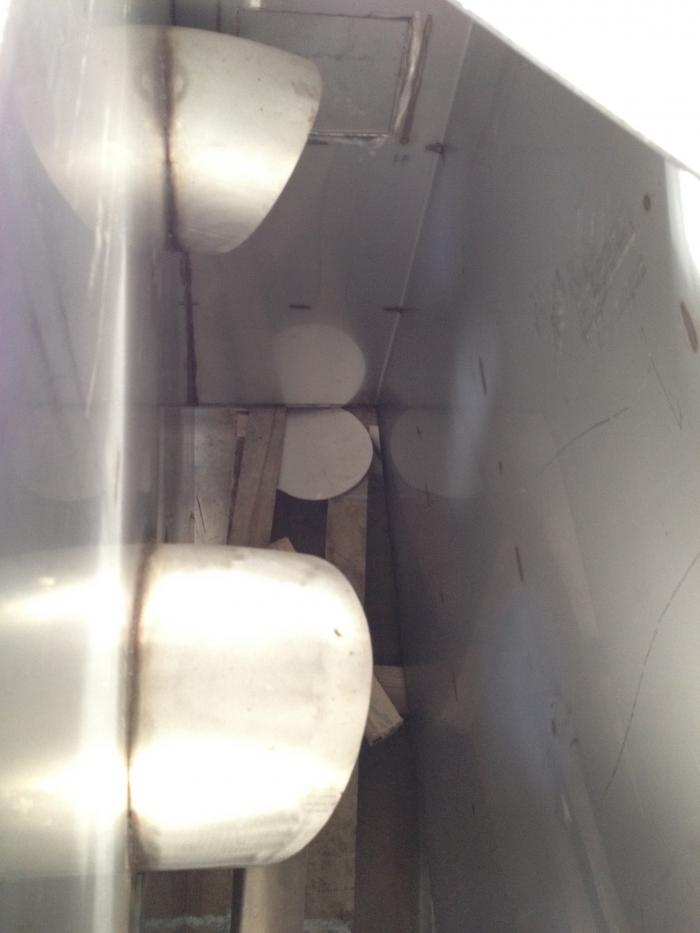

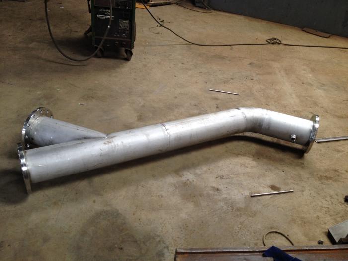

Hi,
I remember that day, it was a big panic I have to do the job ASAP but life shows something different
It meant to be for some water treatment plant, at first there was not enough of material (shitting), then I found out there is missing parts like sockets and flanges, despite it my boss wants me to do whatever I'm able to do with the materials we have because there is customer coming in two days...
and guess what...
nobody came to see it ever and it is steel sitting in the workshop...
about 4 mts hehe.
and some pipeing
It's another usually story in my workplace and the life is still going on

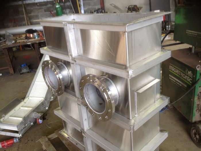

Thanks, the gasket surfaces warp about .015"-.030", so they get face-milled flat after welding.subwayrocket wrote:How do you prevent distortion ? How thick are the sheet parts ? Real nice stuff man !
.375" flanges, .125" sheet

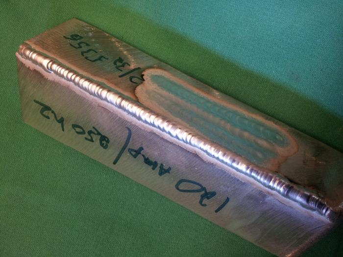

Mr.Aaron congratulations very impressive , I don't think welding can be better than this , could you please tell me how you do it a, all of your settings and if you manually grind the tungsten tip or you grind it by hand please . This sample is the best I have ever seen

No, the only time I ever use the pulser is on stainless tubing (exhaust headers) when no filler rod is used.big gear head wrote:Yes Aaron, that is beautiful. Are you using a pulse setting for that?
Aaron@6061.com
- Aaron@6061.com
Joined:Thu Jan 14, 2016 10:16 am
I chuck my tungsten in a handheld drill and spin it as slow as possible while grinding it to shape on a bench grinder with a 6" wheel.ESENTI wrote:Mr.Aaron congratulations very impressive , I don't think welding can be better than this , could you please tell me how you do it a, all of your settings and if you manually grind the tungsten tip or you grind it by hand please . This sample is the best I have ever seen
Weld settings:
60-350 hertz. Doesn't really matter... I get tired of the same sound so I change it around. Just make sure your puddle isn't shaking around a lot. One time I had it at 145 hz and it did not like that for some reason... The puddle was shaking all over the place. I changed it a few HZ and it stabilized.
200A EN
150A EP
80% balance
15CFH gas flow (for indoor welding with zero air movement)
Other than maximum amps (and hertz for the reason mentioned above), I honestly never change from these settings. I think people over-complicate all the settings. I use these setting for all aluminum projects. Thin, thick, dirty cast, clean, etc...
If I'm welding thin stuff that only requires 20 amps, I'll set the max amps to 20, but all the percentages and ratios remain the same:
1/8" aluminum projects, 120 amps:
If I am welding really thick stuff, I set the max amps to 350 and keep all the percentages the same and bump the gas flow up to about 18 CFH if I'm having any issues with weld appearance:
