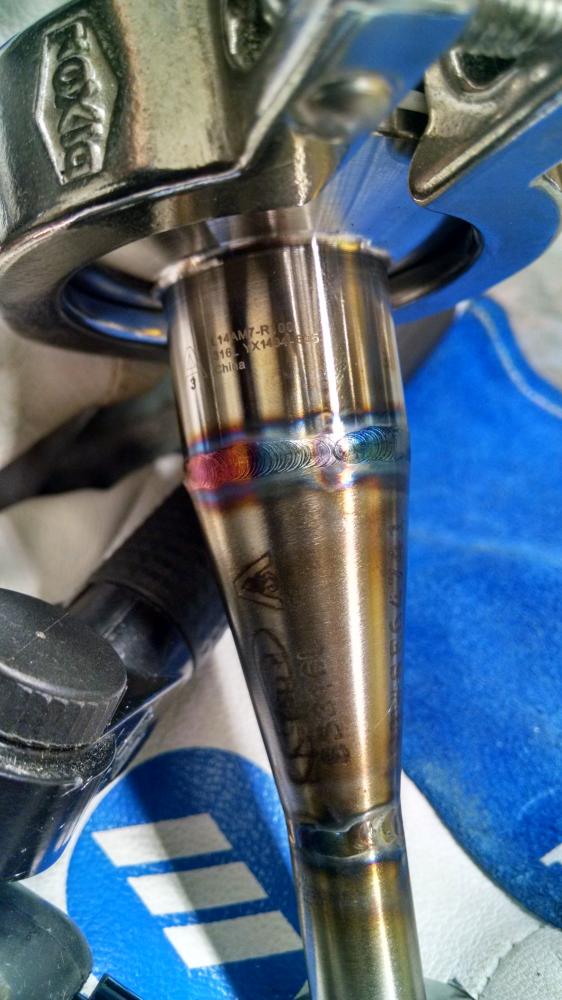

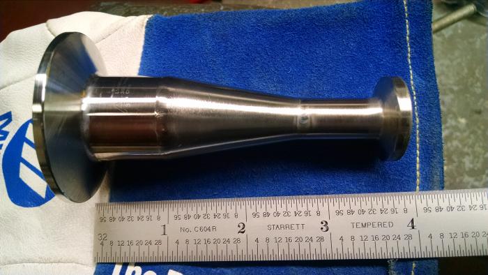

1/2" 316L Sanitary piping, full pen, back purge, yadda, yadda
- IMG_20160214_242025287.jpg (50.92 KiB) Viewed 2736 times
- IMG_20160213_230649742_HDR.jpg (80.79 KiB) Viewed 2736 times
- Inside
- IMG_20160213_232408005_HDR.jpg (52.83 KiB) Viewed 2736 times
- Heres the entire section, made to fit around a piece of existing framing
- IMG_20160213_211602410_HDR[1].jpg (49.04 KiB) Viewed 2763 times
- all pickled and polished
- IMG_20160213_205532062[1].jpg (50.06 KiB) Viewed 2763 times
- raw....
- IMG_20160213_202722178[1].jpg (74.5 KiB) Viewed 2763 times
