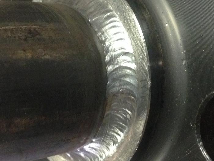

dmcnally wrote:I'm senior citizen learning to weld. I have been practicing running stringer beads, but I promoted myself to lap joints this morning. I ran about 50 inches this morning. I was having a really hard time getting the C (or keyhole) puddle shape. I reread the textbook from the intro welding class I took and adjusted the torch angle. After fiddling with the angles a bit I finally started getting the C (or keyhole) shaped puddle. FWIW: 1/8" mild steel, 3/32" 2% lanthanated tungsten, 130amps DCEN controlled with a foot pedal.
Sadly, this is one of my better beads from this morning.
Dave
Sweeping the torch from the top of the fillet to the bottom will give you that c shape that you're after. Just don't neglect to make sure that you tie into the root of the fillet. Sometimes you have to sweep the torch forward to get that to happen if you don't have a little bit of extra amperage on tap. Being able to give the joint a little extra blast as you move across the center will burn it in. Several ways to do it really.
Getting a flex head torch will help you out a lot because you won't have to struggle with holding a proper angle and will be able to focus more on the weld itself.

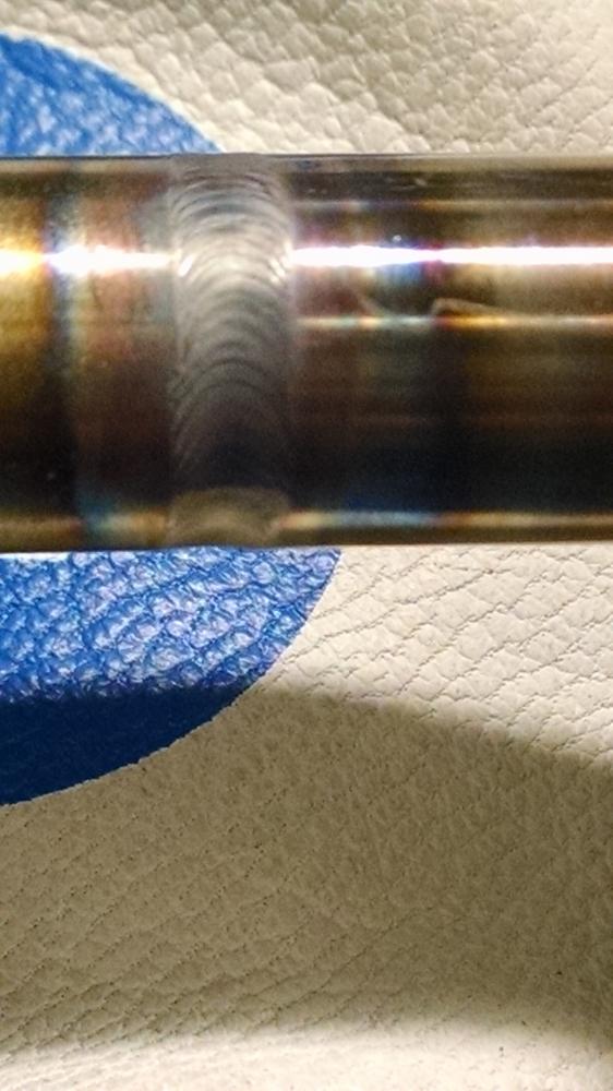

I have been applying Ricks pulse advice for my sanitary welding and I'm enjoying the results. 40A 75% on 25% background at 25% current.
Tube is 1/2" diameter .065 wall 316l stainless.

Looking good...I just did some 1/2" 316L on Maxstar 150, no pulse % adj set at 50%-50% ran 40amps, 2.5pps. weld fast heat builds up quick...
ScottFc3s
    Thu Jul 09, 2015 8:31 pm
Rick_H wrote:Looking good...I just did some 1/2" 316L on Maxstar 150, no pulse % adj set at 50%-50% ran 40amps, 2.5pps. weld fast heat builds up quick...
Awesome stuff as always. Ain't that the truth. The little tube can be touchy but at least it's mostly ferrules being welded. It goes in pretty quickly with a little bending.
