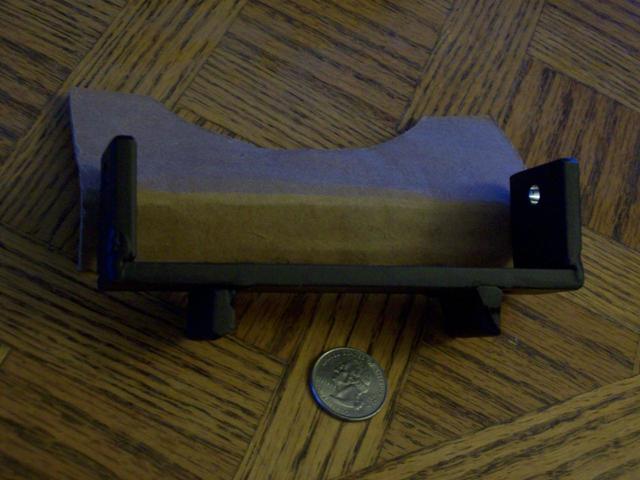

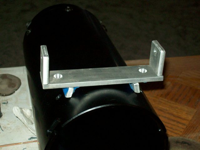

My astronomy club is adding an extension to the pier that holds the telescope. It didn't come with a bracket to hold the controller. I had some 1-1/4"x1/4" aluminum bar in the garage and decided to make something to hold the controller.
Pieces cut and drilled:
Parts mocked up:
Welded and painted:
I'm still learning to TIG. The welds are pretty rough, but this was a good chance to do a useful project.

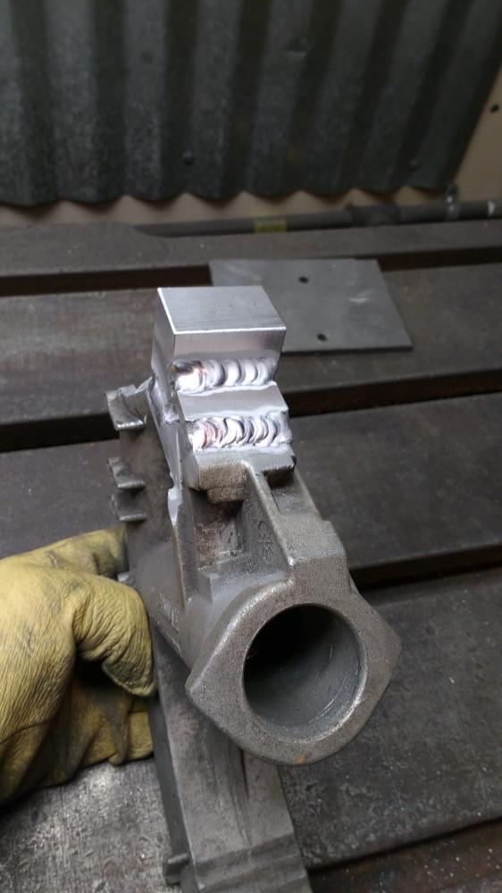

A week ago I posted on Facebook that I want more practical experience so if my friends need stuff welded, to bring it on. The cost is a large Starbucks and possibly your parts being scrap (ie I guarantee nothing so if it's important, pay an "expert"). It sightly backfired as I was expecting to fix small doodads or weld up brackets. Yesterday I shortened a driveshaft (which I somehow managed to do with less than 0.25mm runout) and today a mechanic friend said he is in a jam where they took out an engine out of a customer's car which to fix a leak but it turned out to have a cracked head at the valve cover stud. Not only did the customer not want to pay for a new head but he didn't even want to pay to have the head removed and disassembled.
I agreed to help but for the future I'll add a clarification that you bring your stuff to ME, and you have to do all the cleaning and burring out of cracks.
Turned out pretty well. They'll have fun levelling it back out but they sounded confident they could. *shrug*

Well done Dmitry.
Hard to believe the customer couldn't see the benefits of removing and dismantling the head, but I've seen similar...some people just aren't willing to take the time or pay the money, and they are willing instead to risk any of the risks that might come with tackling the job in situ.
You've done a great job. It would be interesting to see if they manage to do as good a job of levelling/finishing as you have of welding. Nice rig by the way!

Thanks Kym! Yeah agreed on all counts. I almost want it to fail so he can learn his lesson but if they can level it out it will probably seal fine. I actually brought my small bosch router to try to level it out and it was actually going rather well but as I was inching the dept down I just didn't have enough fine control over it and it ended up digging too far, so I had to build it back up. Their old timer said he'll be do it no problem... ok if you say so.

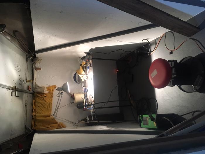

Attached is also a photo of my welding area. It's the stair well for my outside basement stairs. I put the wooden stair on wheels and pull them into the basement when I want to weld.

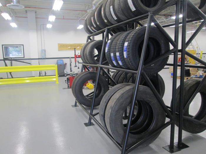

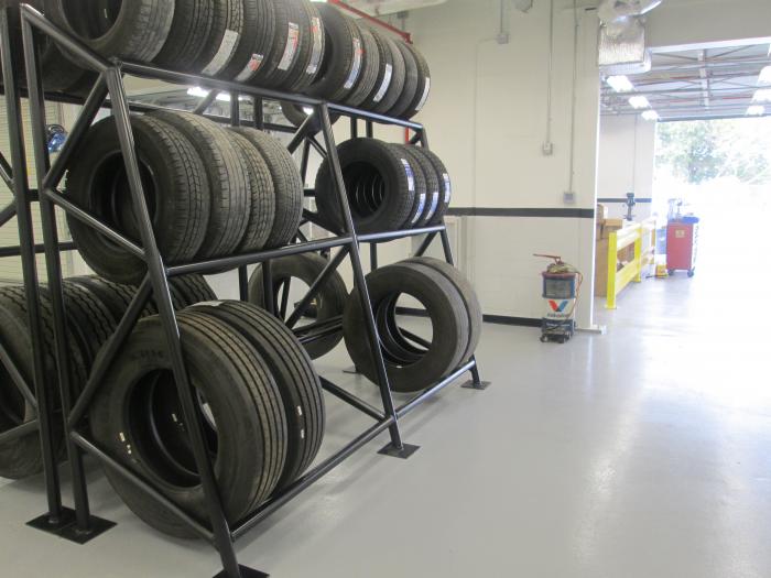

Here are some pictures of the last thing I built.
It was painted and moved in place yesterday or the day before I believe.
It's all 2" schd 40 pipe, I was using my stick welder and a co worker was cutting and Migging whenever he wansn't cutting.
Took a lot of messing up and fixing as I am no master of squaring unfortunately I don't have the magic sight of knowing where to weld to re-square :lol: Built the 3 center pieces first with all the angled supports and then laid them all on an uneven floor (as they were painting their shop floor) so we had to move the show outside on an asphalt sloped driveway :lol: :lol: :lol:
Then did 2 of the center peices and tacked in the cross pieces, then tried to stand it up and it all broke apart :lol:
Then I redid all the tacks, lined it up "squared" it up and did a halfway weld on every piece to keep it from breaking, then added the 3rd section and welded half of all the joints, stood it up and considered going home...
The whole frame was tilting to the side :cry: Ended up having to cut must of my tacks up and pulling straps across the frame to try and square it up, broke some pipe off pulled the strap in such a way that I could jump on the strap when it was tight to try and stretch the frame to go where I wanted. Every time I jumped you could hear a squeak and the frame would shift and shift right back, someone walked by and said it sounded just like their wedding night :lol:
After 4 hours of resquaring, It finally squared back up. Welded away for the next 6 hours until it was 6 AM :lol:
Grabbed the forklift, picked it up, dropped it twice and then figured out how to pick it up without dropping it and moved it inside, put it down, checked the feet and level, went outside angled the sloped ends so the feet could stand flat and welded plate onto the feet with the frame on the forklift.
And she was done.
