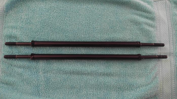

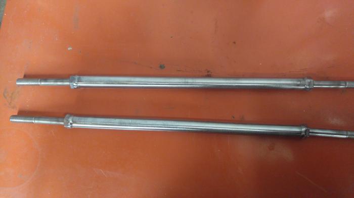

Sometimes I think I need to advertise locally due to low quality of work the welding shops put out in the area. A local dealer needed this part made due to modifications on a unit they sold it is used for sway bar linkage, center section needed to be 11 5/8. Local welding shop made one 11 1/8 and other 11 3/8. Besides getting deminsions wrong they look like shit do to grinding marks and generally beat all to hell.
Here is local welding shops work they sent out.
I was contacted and asked if I could make something that looks better and is the correct dimensions. Told them yes and after a short time gave them these.
Mine are also considerably lighter, both of mine doesn't weigh as much as one of his. My version was made from 5/8 X .083 wall 4130 tubing. The welding shop made there's from solid rod don't know grade.

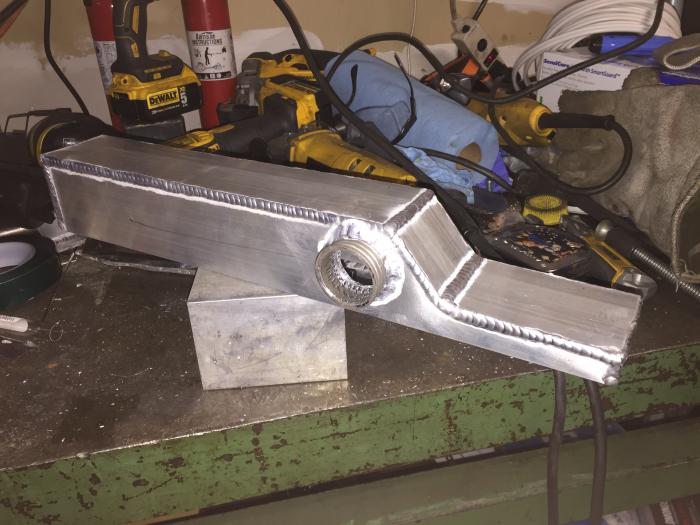

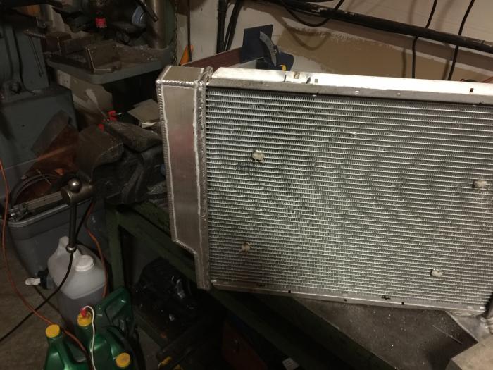

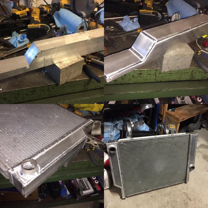

Part of my AN plumbing conversion project will be a nice custom PWR core so I don't need my stock one anymore. I'd always wanted to try building a radiator out of a core, for myself and as a service to offer. Ripped out the plastic end tanks and started making my own using some 1/8" plate and harvesting the barbed nozzles off my thermostat housing.
Went really well but the stock plate is maybe 060 in addition to being dirty crap so when I went to weld the tanks onto the core it was quite the shitshow but turned out ok. Going to try a few things on the other side to make it better. On the next one I will use 3/32 wall or even 1/16

Finished product, well just need a drain petcock

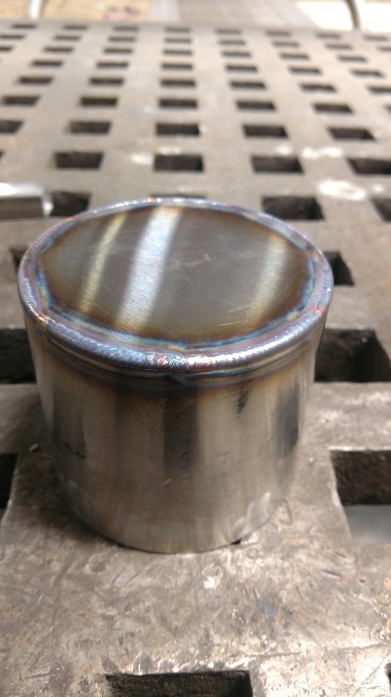

I know you guys will be shocked it's stainless..Lol 316L .083" wall sanitary tubing, with a .0625" bottom.

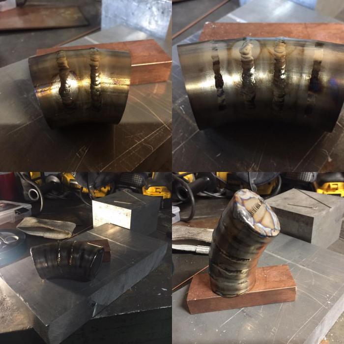

Got my titanium sampler kit from Ticon industries and gave it a shot. I'm an instant fan. Was nervous at first but it actually went quite well once I got comfortable. I used high speed DC pulse, made it quite easy. Welded 3/4-1" at a time letting it cool, with a Furick 12 and 20-25cfh. It's definitely argon hungry but you just need to not get carried away with long runs, with too much heat soak outside of the argon coverage, and it's easy peasy.
For those interested, this is a kickass way to get started, cheap and quite extensive:
http://www.ticonindustries.com/products ... ample-pack

Not bad BigD. We were going to to get some titanium donated to the school by a local business but we still don't have a 300 amp torch and we were concerned about ventilation. So:
How many amps did you use?
Did you feel sick afterwards breathing it in?

Why would you need a 300a torch? Most people welding titanium are doing sheet metal parts for weight/strength ratio and can be welded at 20-75a.Ryan_82 wrote:Not bad BigD. We were going to to get some titanium donated to the school by a local business but we still don't have a 300 amp torch and we were concerned about ventilation. So:

I had peak set to 90 but I didn't use full jam except when I did the fusion welds and used pulse.Ryan_82 wrote:Not bad BigD. We were going to to get some titanium donated to the school by a local business but we still don't have a 300 amp torch and we were concerned about ventilation. So:
No, why would I feel sick?
