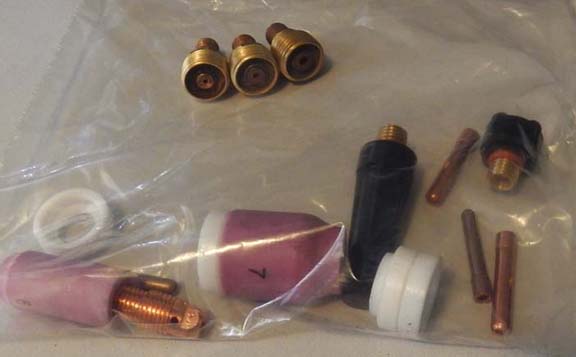

    Sat Dec 03, 2016 9:22 am
You know,
During the course of this thread I've decided to do away with my #9 torch stuff, and I've got a little baggie of the stuff you're talking about on my desk.
Anyway, here's a pic. The gas lens sizes are .040, 1/16", and 3/32", I believe. There's some other stuff too. So, if you think you can actually use 'em, just sent me a PM with a street address and I'll send 'em to you!
[/quote]
