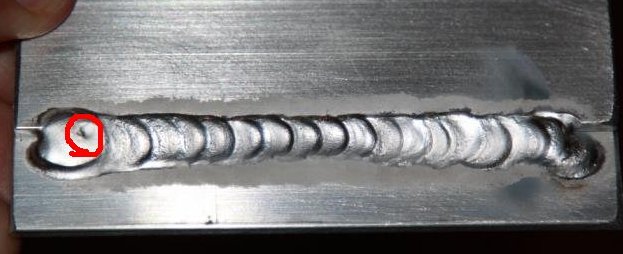

Many of my welds that I don't photograph get wide at the end. There is a point after about an inch that sometimes I remember to back off the pedal a bit. Sometimes I can get a button on the end, right now I am pleased if it does not crack as it cools. Yesterday I narrowed the width of my lap joints to about 1/4". Getting close. Today, Fido's butt.

Found this on the inside.

Back to my normal place to improve from.

That one looked a little cold so I tried 95 & 100 amps.
cj737
    Thu Sep 29, 2016 8:59 am
Try reducing the amount of filler rod you add each dab, and increase your travel distance between dabs. This will help even out your beads and flatten the fillet some.
A trick I've found helpful when approaching the end of a weld, is to begin tapering the foot pedal so I have to hold longer to get the same penetration. This does 2 things: it greatly reduces the cratering at the end, and it keeps the puddle from spreading out too flat due to accumulated heat in the base metal.
You can practice this on flat beads. Just make a 3-4" bead, get the start hot, dab, slide, dab, slide and when you reach the approximate end, ease back the pedal and make yourself hold there until the bead soaks in to be as wide as the rest of the bead. It's a very good practice drill to help with aluminum welding.
Your latest pictures show a tendency of over-filling and I would suspect that the root of that weld is probably cold or even hollow. You're melting the top of the plate (upper toe) which tells me you have lots of heat, but your arc length is either long, travel too slowly, or you're not pointing the arc into the joint. Or all of the above :) But you are doing pretty good work for being self taught on challenging alloy!

cj737 Thank you for your input. That was very constructive advice.
I'll give those things a try.
I can't take credit for being "self-taught," I did take an evening class at the vo-tech and the teacher still gives me advice.

Welding 1/8" aluminum will require more than 100 amps, at least to start. If on the pedal, crank up the amps to 150, get your puddle, then taper off until you feel like the puddle and your travel speed are comfortable for your coordination. There's no requirement to weld fast unless its stainless steel!

I have a feeling your're not actually using the whole 100 or 95 amps, but I could be wrong. Are you babying the pedal or actually giving it full throttle to get the full listed amperage?

I ramp up quickly right after getting an arc started. Then move along at full throttle for an inch or so then start backing off to maintain bead width. At least that's my plan.

I did about a dozen of these today.
Gene, defiantly doing better, looks like you started slow, (metal was room temp) as you went an inch or so the puddle narrowed (good thing) as the plate warmed up and you got into a rhythm (looks best at this point) at the end maybe you're snapping off to quick, and/or your keeping the tungsten at one spot. When tapering off try moving the electrode in a small circle as you finish the weld

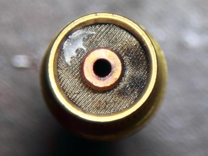

I just watched one of Jody's videos (on tungsten grind angles) and his torch angle was not anywhere close to straight up. He was pointing into the lap at about a 45-degree angle.
cj737
Gene.243 wrote:I just watched one of Jody's videos (on tungsten grind angles) and his torch angle was not anywhere close to straight up. He was pointing into the lap at about a 45-degree angle.
That's a good point to make: people always say 90* but that refers to the angle of the tungsten to the joint, but with a lap, you need to be at 90* to the "seam" or 45* away from horizontal while maintaining 90* to the puddle.
And by the way, if ice soothes your scorched skin, you're not welding hot enough! :D I did a bunch of thick aluminum Friday-Saturday, and the darn stuff was so hot the sweat pouring off me vaporized as it hit the aluminum. Sounded more like I was MIG welding with the sizzle of sweat. And yeah, it didn't smell great in the shop either :oops:
