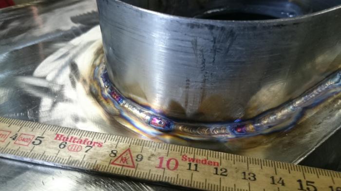

I think I know which one you mean. Had another look at it this weekend and I noticed I moved as fast or even faster. I did some more practice yesterday and slowed down a lot to get better consistency, to my surprise the color was still quite good. I used the torch switch on and off frequently to control the heat with help of the downslope ( increased it to 3s).Mr. Moose wrote:AndersK,

Better?Superiorwelding wrote: I would suggest working on your actual welding technique rather than focusing on the coloring. I still see inconsistent beadwidth and spacing,
- DSC_0446[1].jpg (40.74 KiB) Viewed 1466 times
This weld run all around for 450 mm. I was welding 1-2" each pass and jumped around (wording?) to avoid distorsion
AndersK,
What an improvement!!!! That my friend is very acceptable! Good job on making those transitions. The fillet is hard let alone a rounded fillet. Keep that up!

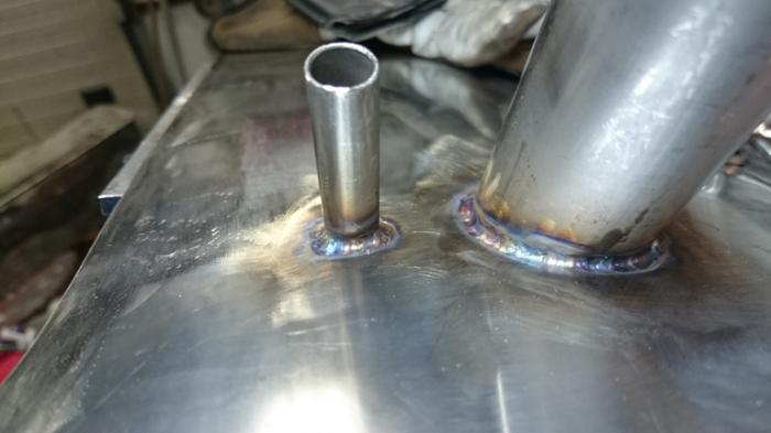

Added a cap so there are outside corners to weld
Some angled tubes. A 9 torch felt big between the two...
