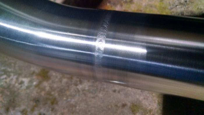

I just started welding Stainless today, whatcha think
In all seriousness this I welded with my Jumbo CK gas saver (1-1/8"), 1/16" tung, 60amps 2.5pps 50%/50%, travel speed is fairly quick, full penetration with a back purge. Your doing fine, lots of good guys and experience on this site that will help point you in the right direction. Practice, Practice and more practice
- brushed...
- pipe2.jpg (26.94 KiB) Viewed 3710 times
- just welded 316L
- pipe.jpg (57.73 KiB) Viewed 3710 times

By George I think you got it! Looks good, keep burning only way is up from here.
I got a new Lincoln auto darkening welding helmet. What a difference from my old harbor freight darkening. Also got the cheater lens.
I can now see the puddle and the arc clearly. Being able to see lets me get the arc much shorter creating much less heat.
Weld shown is thin walled tube to 10 gauge plate. The only post weld treatment was a light wire brushing.
