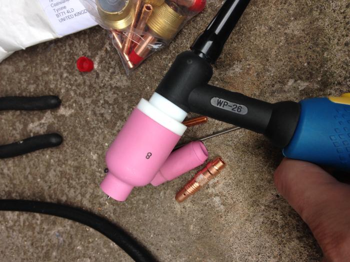

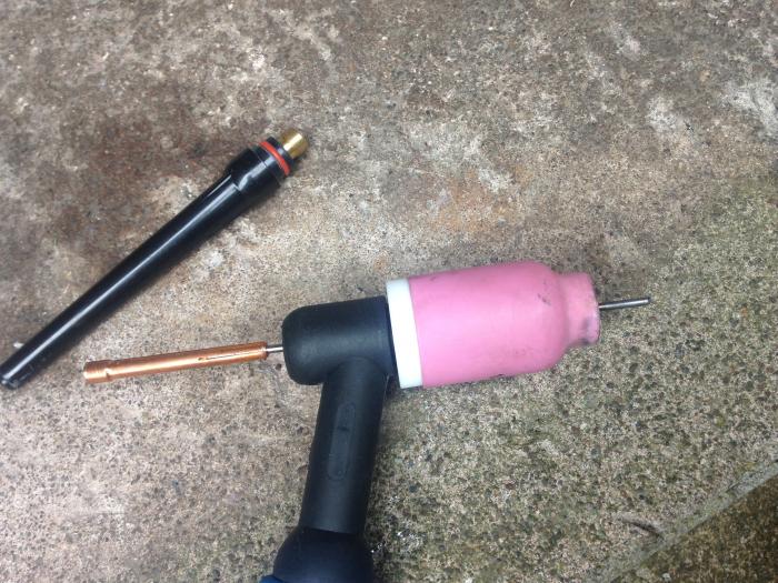

disassembled torch
torch is dressed with rubber,
and holding both sides blocked, feeling quite good gas pressure (definitely no leaks)
stock torch

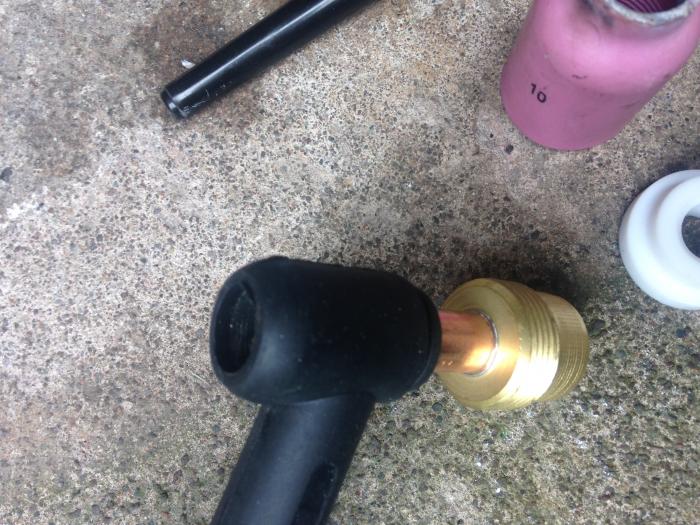

cleaned really deep
wiped,brushed

There is enough crud on that gas lens that it needs to be replaced. It is very likely it is not flowing shielding gas the way it is supposed to. Looks thoroughly clogged. There is definitely a gas delivery issue, which is the cause of the black soot (presence of oxygen in the welding arc).

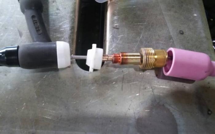

Depending on the torch-side configuration of your teflon insulator for the large gas lens, you might indeed need the original stock insulator in place for proper sealing.
Here you can see the inner "lip" on my large-gas-lens insulator.
It prevents proper sealing at the torch body because it lines up with the rubber on the torch head, and does not slip nor over nor under the rubber edge.
BUT, it does slip inside of the stock insulator like so...
Assembled, it creates a nice tight fit that upon tightening down the cup, the insulators are pressed together and against the torch, and to the cup from having tightened it down. This is with full thread-engagement of the collet body within the torch head, as I can feel it bottom-out.
Although, now I do an issue where, from the picture, it seems like you're also getting the same results with the stock collet body/cup(?). If so, then the gas issue is elsewhere and likely not at the torch, since the single insulator is enough in that case. Are you positive you are getting an AC welding arc? I know you set it to AC, but are you getting an AC arc? Can you hear it "flutter" compared to DC welding?
Also, I just noticed you mentioned this earlier: "been welding with mig for a long time,and its looks like gas issue, ", Are you sure your supplier didn't give you a bottle of C25 used for MIG welding?

genuine Weldcraft TIG torch replacement Gas Lens Gasket Insulator. Suitable for all 17, 18 and 26 series TIG torches.
http://store.cyberweld.com/wegaslegain5.html
I just wanna add, that is an insulator for a medium gas lens, not a large gas lens. Not that it was implied any other way, just saying.Kevin_Holbrook wrote:i believe it's this oneColdman wrote:@SouthpawWould you have a make and part number for that middle heat shield please?soutthpaw wrote:Most gas lens collets are assembled like this0226161259a.jpgSent from my VK815 using Tapatalk
HTP sells a 1pc insulator for medium gas lens for 17/18/26 torches, as well. I like it.
That one for the medium gas lens setup, I know I got mine when I ordered my gas lens kit for my wp17 torch. I'm pretty sure they can order this stuff in bulk and package it up. I think it might be worth calling and asking. Perhaps tack it along with more things to get free shipping.Coldman wrote:Thanks Kev, I will give them a go.

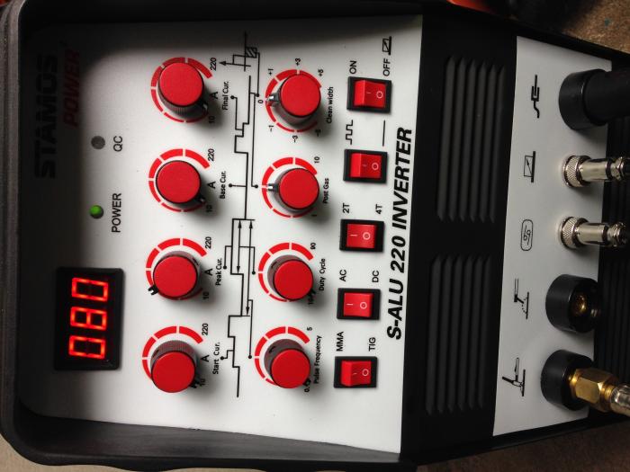

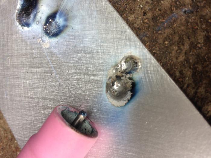

so finally got my tungstens posted,
first attempt,
why it started cracking ??? ( it didn't cool down to quickly )
so after all frustration, I pull all levelers down and finally got really nice melting process.
what you guys think, which levelers I need to try adjust more,and which I don't need at all??
and I did try with extra insulator, didn't make any difference...

How thick is that aluminum ? And do you know what kind it is? if it is leftover scrap material where did it come from. That may help figuring out what kind of aluminum it is and if it's contaminated. If you shut off your gas tank how long does it take for the gauge to read zero pressure?
Front panel is basically OK except AC balance is set on 50 /50 again so your going to fry tungsten - average setting - 2-1/2
without knowing material thickness cannot comment much on amps except if it takes more than around 3 >4 seconds to puddle it's too low & if if does then your trying to learn on way thin material which is very hard especially without using the pedal that is just complicating matters - as I think was previously mentioned get something like 1/8" & start around 130amps till you see how your machine behaves also as Poland308 mentioned try to get a known clean sample to try out on
insulators look correct now but lack of etch zone & slight smoke residue still suggests gas cover issues - but on the bright side you have a quite clean looking weld on the last few tries so you have virtually cracked it - only thing that would help is to find someone close enough to you that would give you some tuition & maybe try it on their gas to rule out that variable - I'm fairly sure there are at least a couple of fellow Paddy's on here - maybe look them up ?
The cracks I would think are on the backside burn through of a run without filler which is normal - aluminum does not autogenous weld any sense.

To me it still appears to be a gas coverage issue. If I try and figure out what is happening, in my mind I can "see" the wind blowing your shielding gas away, then the wind stopped and you finally got to lay a few good beads in that last pictures. The bead suddenly started looking decent so I know you couldn't have reached over and messed with the setting while you were welding---so that says that something else was at play. I don't remember if I have asked this before: Are you welding outdoors where there are wind drafts (even the slightest)??
All things do point to gas - that model has no pre-flow so maybe that's what happens if you don't use the post flow to get gas cover before starting - initial arc / puddle has momentary lack of gas & oxidizes / contaminates - this floats along for a short distance then gradually cleans up ? - hard to really judge without seeing what 's going on - a video might get to the bottom of it - seems odd there is no noticeable etch zone despite him using 50/50 AC balance - or we're all missing something .
Where's that milky looking smoke coming from? The only times I see anything do that is when welding galvanized or when I welded that cast aluminum a couple of days ago.

that's the magnesium burning from lack of shielding gasRamboBaby wrote:Where's that milky looking smoke coming from? The only times I see anything do that is when welding galvanized or when I welded that cast aluminum a couple of days ago.
most likely the cup was too far away from the puddle
