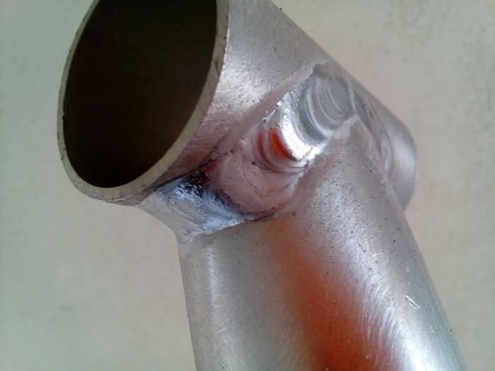

Damn you are good , tell me that you started like this
feel free to comment ..as it is my only source of feedback for improvement
is this an indication of over current?
Is this right or over penetration?
failure is a great teacher

Bisdremis K. wrote:Damn you are good , tell me that you started like this
Everyone starts there man!

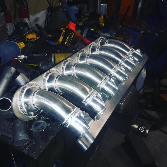

Finished the flange side of my intake manifold. Next need to mount the fuel rail and then wait until the engine's back in the car to figure out the plenum dimensions

vey jealous!
nice job!

BigD wrote:Finished the flange side of my intake manifold. Next need to mount the fuel rail and then wait until the engine's back in the car to figure out the plenum dimensions
Very nice, Dmitry,
I'm going to have to look you up on Instagram.

Thanks a lot guys!

Wow BigD...very nice!

exnailpounder wrote:Wow BigD...very nice!
Thanks man!

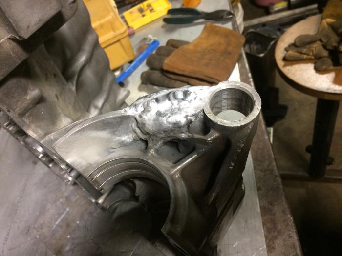

Busted bolt hole and a missing chunk of metal. Going to start smoothing it down and flattening it out before it gets sent to be machined. Then they will have to redrill and tap the hole.
