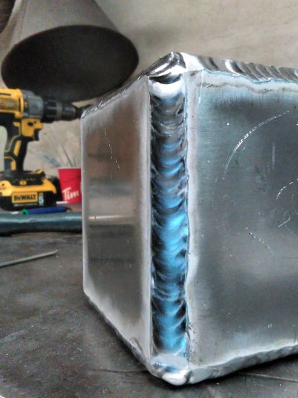

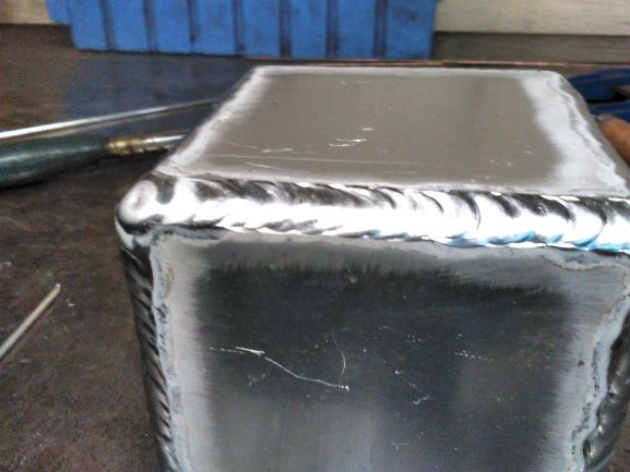

Here's a little cube I made up last weekend for some practice.
Material was 1/4" aluminium, can't remember which alloy as it was just a piece of bar laying around the shop. Joint setup was a outside corner, all welds were done horizontally.
Machine was a Miller Dynasty 400 set @ 275 Amps A/C, No pulse, balance I think was about 75%, frequency if I recall was at 120hz ish, 1/8" 2%lanth tungsten.
Please criticize and give me some pointers. Also first time putting images up so let's see if I get it right.
I'll try again cause it didn't appear to work, think they were too big.

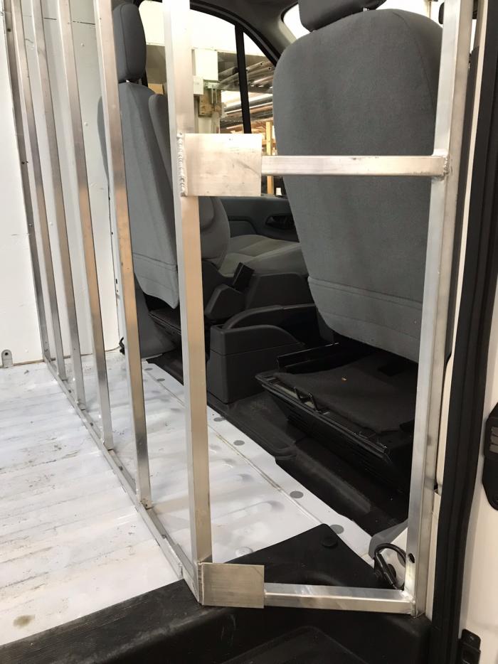

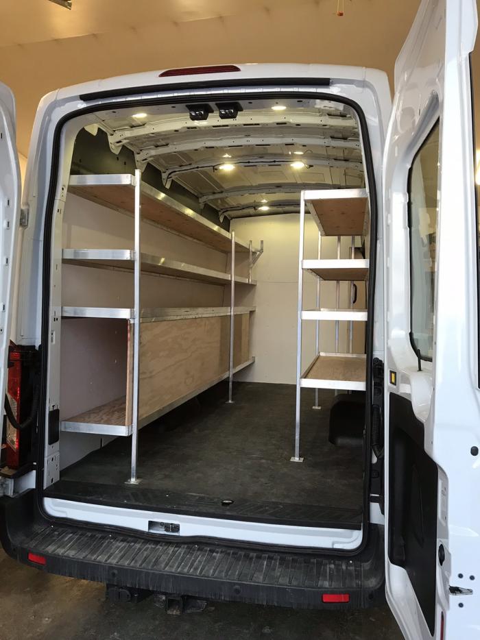

A little project i did for my old mans work van.
- IMG_0001.jpg (95.02 KiB) Viewed 7684 times
- IMG_0003.jpg (74.33 KiB) Viewed 7684 times
- IMG_0004.jpg (68.72 KiB) Viewed 7684 times
- IMG_0005.jpg (74.55 KiB) Viewed 7684 times
- IMG_0008.jpg (83.87 KiB) Viewed 7684 times
- IMG_0009.jpg (85.67 KiB) Viewed 7684 times
- IMG_0010.jpg (67.82 KiB) Viewed 7684 times
No photo, but your not missing much.
