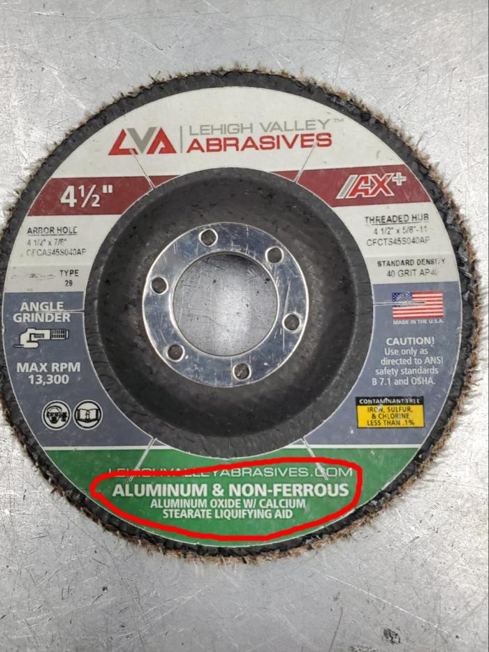

On the back side it looks like you may have used a hard disc to grind the weld, judging by the harsh grinding marks. There are flap disc specially for aluminum, the advantage is they don't clog, and a flap disc will leave a better finish
Yes I did. I need to pick up a few of those non ferrous flap discs. It was a quick and dirty type of job. I had a time limit on it. (Wife is pregnant and wants Long John Silvers.) But yes I will plan on picking some up for the future. At least at this point that chair can be used for sitting and not just a foot rest. Thanks for the tip @LtBadd.

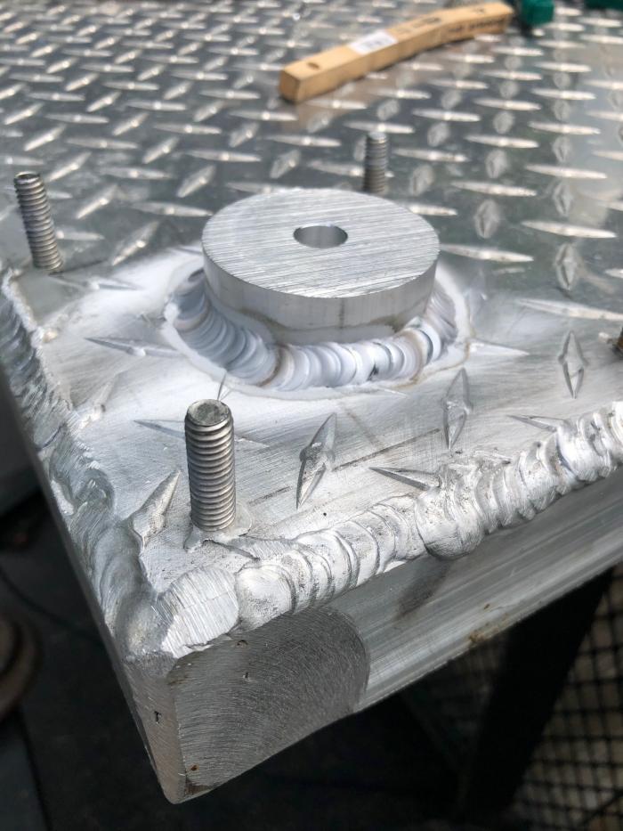

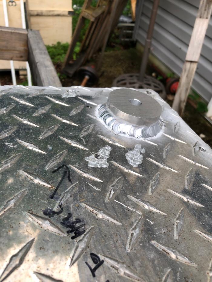

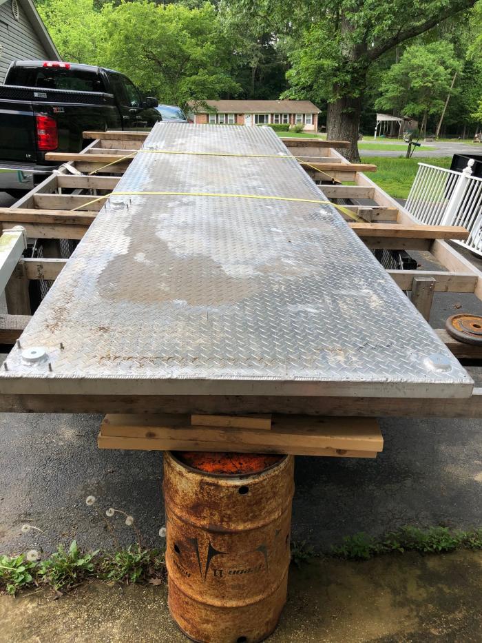

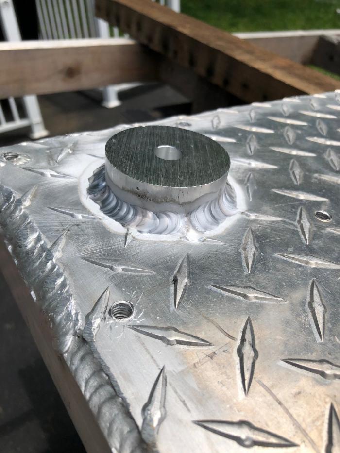

Pro bono job for the local PD. Riser standoffs for some sort of huge mezzanine cover plate. 3/4" thick by about 2.5" wide 6061 hockey pucks welded onto thick tread plate. Dirty material that's been sitting outside for a long time...the edge welds on the frame are not mine. Humid, windy and rainy all day...and nothing to prop on (which I need to fix). Fun fun. Only managed to get one done in between the showers. :lol:
7 more to go.

Curious which cup setup you were using. Looks like you was getting good EP cleaning. What was it set to?
Spartan
    Fri Mar 06, 2020 8:59 pm
VA-Sawyer wrote:Curious which cup setup you were using. Looks like you was getting good EP cleaning. What was it set to?

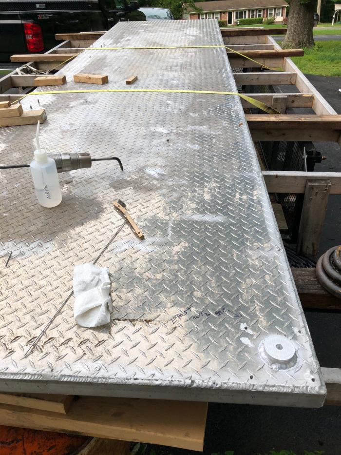

The wind was really screwing me up. Really more of a gusting breeze at 8-10 mph, but enough to be a real pain. After some problems with that and experimenting, ended up using a #8 GL with the argon bumped up to about 22-25 CFH, and just a little bit of helium cut in. Things went smoothly after getting that sorted. Cleaning sweet spot was at 37% EP after starting at 40% due to the dirty base metal. A lot of acetone scrubbing and wire brushing. 300 amps on the pedal, but probably only using 260-280 of that, I would guess.

I understand about trying to Tig in the wind. I believe the 'i' in Tig stands for 'indoors'. Doing repair work means we sometimes have to do things the hard way.

One could always setup a wind block with a cardboard box...

Yeah, I tried some wind breaks, but the gusts were kind of whipping and swirling around so didn't do much good.
Have 6 of them done now...but more showers coming through have given me an excuse to take lunch before doing the last two.

Done. That was a real PITA. A free PITA :lol:

Nice work, Spartan. Looks like ya had to get some serious engineering going on to anchor those assemblies down. I'd be in a jam due to being short on one end and couldn't reach across. I'd have to climb on board and lay flat... :lol:
Spartan
BillE.Dee wrote:Nice work, Spartan. Looks like ya had to get some serious engineering going on to anchor those assemblies down. I'd be in a jam due to being short on one end and couldn't reach across. I'd have to climb on board and lay flat... :lol:
Thanks, BillE.Dee. It was a challenge indeed climbing up into that wooden framing on the trailer to get to the welds and with such limited positioning. Luckily didn't need to get on top...was just able to do it all from the sides. The customer routed down the high-spot treads in the areas where the pucks sat, so that made it easier for positioning. Just held them down with a huge 15 lb. third hand tool to get a couple tacks in.
