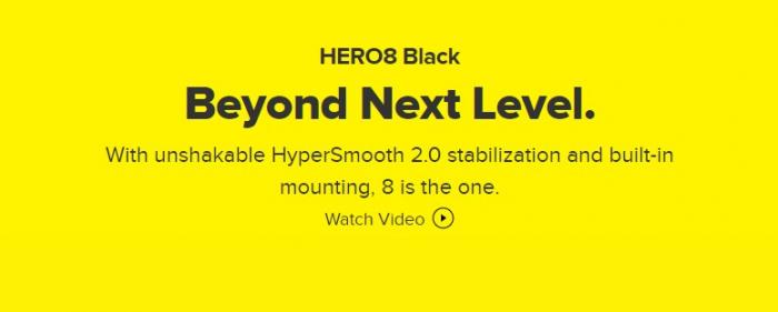

From the gopro website
Screenshot 2020-09-16 181726.jpg (15.74 KiB) Viewed 10628 times

I bought it with that in mind but I can tell you the videos with it mounted in my car are unwatchable. And that is using the hero 8 black kit mounting hardware.

Try the warp stabilizer in After Effects (Adobe). That'll fix that no problem.

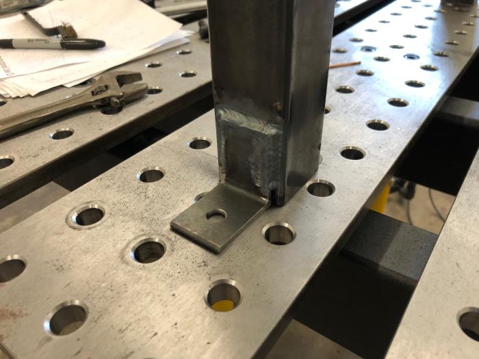

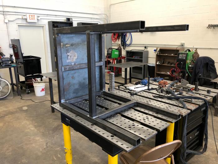

Transformer stand. Apparently one transformer will slide underneath and another will sit on top. About 43" tall. 2" square tubing, 11ga wall. 1/4" thick plate for the top. Asked the customer if they would like to save some money if I could re-use some old jig plates for the top, and they were quite agreeable to that. That's why you may notice some grind marks on the bottom of the top plate.
Intended to only do the tack-up with TIG, but wound up running TIG on everything. Because TIG rocks!
Looks good Spartan

Spartan wrote:Transformer stand. Apparently one transformer will slide underneath and another will sit on top. About 43" tall. 2" square tubing, 11ga wall. 1/4" thick plate for the top. Asked the customer if they would like to save some money if I could re-use some old jig plates for the top, and they were quite agreeable to that. That's why you may notice some grind marks on the bottom of the top plate.
As a TIG newbie I’m trying to learn as much as I can.
One of the challenges I face is moving too slow.
Videos tend to be sped up so getting a real sense of speed and timing is hard.
@spartan not sure what the right terminology is but how quick are you moving on the welds?

I try to move absolutely as fast as the puddle will allow, so long as it is whetting in nicely. But sometimes it's not always quite fast enough. As you can see in the pic of the bolt-down foot for the leg. Was doing those welds with a torch switch and out of position, so it was a bit slow. The result is a fine weld, but a bit grey and dull looking.
When you think you're moving fast enough, strive to move even faster. So long as you're getting good puddle whetting and penetration into the root. That's most important.

Do you find that moving fast leaves too sharp of a tail/teardrop at the rear of the puddle?

I think it can, especially if you're moving fast, hot, and not making pronounced pauses with the torch. I think the biggest part of getting that crisp, circular dab stack is making sure to have that marked and even pause duration with the torch at set intervals as you dab. So it may not necessarily be only speed/heat dependent, but more dab frequency and duration dependent relative to speed.
So considering my pic above of the tubing tri-joint, there is just a bit of a teardrop shape to the puddles there, but to me it is minimal and acceptable. If completely circular dabs were needed I would probably look at doing a pulse configuration, but that's just me.

Personally I find when I’m moving too fast there is too much filler/tungsten interaction. :D
