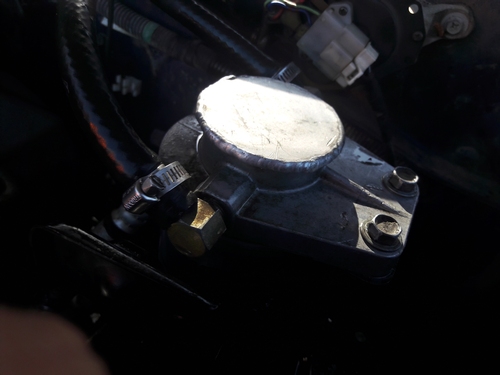

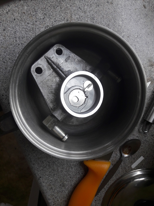

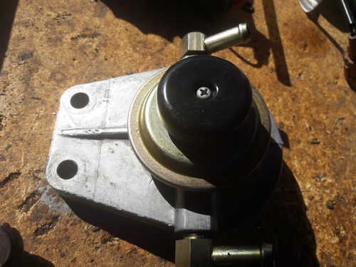

tweake
    Mon Dec 18, 2017 4:53 am
    New Zealand
diesel fuel primer. cut the plunger off, cook then weld.
Spartan
    Fri Mar 06, 2020 8:59 pm
Fuel tank mod. Customer needed the top center cut out which housed a traditional fill port, and replaced with a plate and a 2" pipe nipple to serve as a hose-connect fill port. 10 gauge 6061.
I do very little aluminum, and a lot of it was a bit awkward to position, so not the prettiest beads, but I think it turned out ok.
BugHunter
    Sun Apr 19, 2020 12:54 pm
Looks good Tony!
Jody will be happy with the shameless Tig Finger plugs! :lol:
BugHunter
Hey Tweak,
What's going on with the primer gizmo?
tweake
    New Zealand
BugHunter wrote:Hey Tweak,
the primer is leaking at the plunger and they are not repairable as the top is crimped on, factory replacements are $$$$$.
got a 2nd hand one in but thats leaking a little bit, which is pretty common.
these engines suck fuel up from the tank and with a leak it sucks air in and starves it of fuel.
so cut the top off, boiled it in an old saucepan to get the diesel out of the alloy.
then welded a plate across to seal it off.
its been installed and in use for a while now and is ok.
using a boat style plunger/primer down at the fuel tank.
Spartan wrote:Fuel tank mod. Customer needed the top center cut out which housed a traditional fill port, and replaced with a plate and a 2" pipe nipple to serve as a hose-connect fill port. 10 gauge 6061.
Looks good and the customers happy, so it's a win - win
