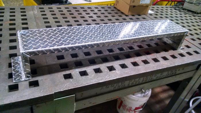

Made a small platform the other day for my fathers boat, this way he doesn't have to kneel or prop on the motor. I don't get to weld alum as much anymore so I really enjoyed this! 6061or I would have bent it.

Nice job Rick. I'm impressed !

Nicely/neatly done, Rick.

Beautiful, Rick!

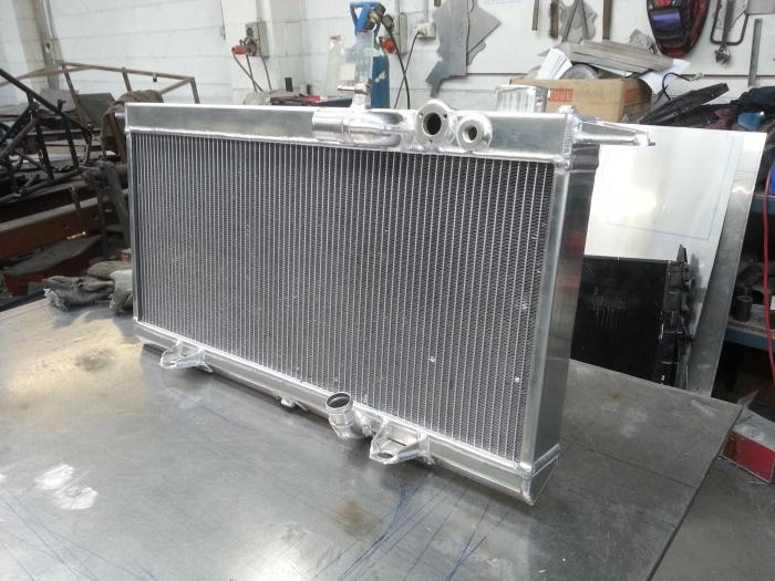

Again something a bit different for me.
This one is an Aluminium copy of a mid 70's Lamborghini Espada radiator.
I can't say work is ever boring :lol:
Regards Andrew from Oz.

Awesome! Beautiful job.
