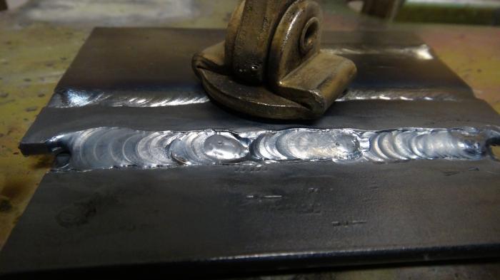

Alright so I've done every Amp range +/- 10 and I absolutely can not get a shiny piece IF I'm running a straight bead on this Home Depot steel I bought. My range is 80-160 but around 110 seemed to be the closest for shiny.... Now if I run 140 Amps on this 1/8ga steel for a lap joint, I get an amazing beautiful color. Catch is I'm not using rod. I'm really starting to think my "Blue Demon ER70S2" rod is screwing me on those beautiful colors. That's cool honestly.
So I've done three lap joints now and with each one I can bend the piece all the way to the opposite side without a break. Before I get there though, I've got this very beautiful blue hue to my laps without filler. Without the filler yes I can bend the parts in a 180 degree bend and I have no complete break but it's about to give. With 3 attempts I had consistent blue giant star blue coloring across my welds without ever using filler.
Once I used the Blue Demon filler using the same 140 Amps I had used for every lap joint, I got immediate dull grey. Now granted I could kick it up but when I tried to break the joint, I seriously bent the crap out of the metal using my heavy vice grips and a Home Depot pipe wrench with multi-set angle adjustment (VERY heavy duty). I was able to break the two welds with these tools but it took a full 180 degree bend (no filler) and then a back bend which finally broke the weld.
Using the filler rod with the dull finish, I can't really break this thing. Sure I can with heavy manipulation and back/forwards force but I've got a series of pics that corroborates my whole story. I'll do my digi-dude process and put all that together but before I even go that route, should I really just expect this Blue Demon filler to give me dull, but exceptionally strong results? I bent the shit out of this plate (I've got a whole series of pix) and without some serious pull, I will not break this filler lap joint no matter the machine, vice, brake press, etc.

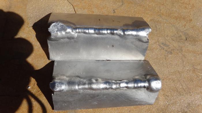

Well I figured out how to get color at least more often than never. It was the filler rod too! I used a scotchbrite pad lightly on the filler rods before I used them and it made a fairly noticeable difference. I also went back to pulsing the pedal on the steel and my beads are looking ripply again too.
I did a few lap joints still pulsing the pedal which seems to be very helpful all around. Turned out good enough for me since they're my first. Had a few inside/outside corner joints as well which were generally satisfactory to me as well. There really is a comforting difference between running beads and joining metal as you called it nailer! I'm still liking my 130 to 140 Amps especially with pulsing the pedal. 120 does the job, but I'll stick with what I'm feelin.
Poland's suggestion on breaking the welds was a fun step too. Basically do one lap, not both sides, snap, look, and re-weld! That only worked with autogenous though. When using the filler, the weld wasn't breakable with a heavy wrench and vice grips. Bent the crap out of it, then flattened it mostly out on the shop press for more laps! The weld was strong enough that I'd need real force like a chisel and a 4+lbs hammer to separate or perhaps a shop press and chisel. It was a real weld!
Did an aluminum outside corner joint which turned out good enough for my first minus the lovely hole I burned at the end. I also learned what happens when you forget to switch back to AC from DC. More holes! I did fill those in with the AC pass at least minus that last hole. There wasnpenetration on the other side but it wasn't pretty but eh, I think it was a great start!
Now I'm having real fun and that's all that matters

- 1st autogenous lap
- DSC03700 - 1st Lap Autog.JPG (30.45 KiB) Viewed 2396 times
- 90 degree bend 1st autogenous weld to see penetration
- DSC03723 Broke Weld to See Penetration.JPG (40.74 KiB) Viewed 2396 times
- 1st Lap with Filler
- DSC03724-1st Filler.JPG (30.36 KiB) Viewed 2396 times
- First lap with filler bend results. Did NOT want to break :)
- DSC03728 With Filler.JPG (33.25 KiB) Viewed 2396 times
- 3rd "repair" on lap joint
- DSC03739 Repaired again.JPG (26.69 KiB) Viewed 2396 times

They are starting to look like welds! Your travel speed will have a lot to do with the color that you get but remember....you are working on technique and not color right?
When you get into higher amperages, you won't get any color for the simple fact that lower amps and faster travel speeds introduce less heat into the base metal and higher amps introduce much more heat so don't chase your tail too much on this. The ultimate result you are looking for is simply NOT cooking your base metal. The number one reason (among others)for cooking base metal is too low of amperage and waiting for a puddle which, in turn, heat soaks your piece. I bet you can see this getting simpler, can't you? Mild steel is very forgiving of mistakes and is the best thing to practice with so that when you turn to other metals that aren't as tolerant of mistakes you won't fall apart. There is a reason that welding schools all start students out on mild steel.
I am glad you said you are having fun because you should be. Some people get the notion that they need to get really good at tig...especially tig aluminum...and the world will beat a path to their door..you will be disappointed. I am pretty decent at aluminum and get very little work coome in for it. I do alot of stainless work on kegs and such for homebrewers so you need to find niches like that to be able to make a few bucks to support you new addiction..lol. You will find that in every day work, you will most likely NOT use tig and use a simpler process. Day to day I mostly mig but when word gets out to a specialty group like homebrewers that there is a guy that can weld on their kegs...you get the point right? So in order to pick up a few bucks, and the self-satisfaction of being able to do specialty work, you need to have the ability and knowledge to do it so thats why I am riding your ass on pedal control and amperage and travel speed. When you get those things you will be able to light up on anything with confidence. Even if something comes along that is a first time for you, you at least have the skills to not destroy a workpiece because you can control your foot. There is much more to tig welding that what we discuss here but you need to start at the right place. I still go back and watch Jodys videos and I have been at it for awhile and I STILL see things in his videos that I missed the first time because I was overlooking them in the quest to get to "tig welder" status. You will look back at all this one day and laugh and a year from now you will be here giving tips and advice to other noobs and wonder why they don't listen sometimes

I finally got one perfectly consistent bead on my aluminum last night! Not the best start or stop but everything between was perfectly even. I've dropped to 110 Amps for max and still using the foot pedal for the 1/8. My joints are going very well and look pretty for the most part and I'm running 120 for those. The 110 vs. 120 on a basic bead does pool in about 2-4 seconds for the 110 and about 2-3 seconds for the 120. The big difference there is controlling the pedal becomes more difficult to satisfy tapering off amps since the range between the potentiometer points is a lot larger than the range when you're at a lower amp i.e. more control. Now could a better pedal vs. my Everlast basic 22k Ohm (I think?) one that came with the unit help out a lot more when doing this? Probably...
I noticed in the beginning and now I'm feeling for it, that I need to quickly ramp the pedal to full floor but still ramp not mash, and a lil pool will start. Still not ready though! I let it expand to the size I'm wanting and then start feeding and traveling pulsing the whole way. With about every 1/2 inch I find I have to continue dropping the pulse I'm applying till I'm around maybe half pedal for my fill and about 1/3 to 1/4 for my travel. The best bead profile I got involved backing up the torch a bit too as Jody suggests. This helped a lot and seems to avoid most chances of dipping or stabbing your tungsten. I don't think it's any simpler though if not more complex vs. Jody saying it's easier since you're only doing one thing at a time. YMMV I suppose applies here too.
Still learning but with all the suggestions what I've experienced so far seems about what I should expect and how I should be treating this.
I'm still against using the machines pulse settings but I'm also the guy who puts every game on the hardest level and will die a 100 times till I get it right. Only difference here is there really isn't a reset button, grinding just gets you close
I do listen to music a lot and subconsciously I think I use it for some timing too. My music has erratic patterns so having to roll back to some Elton John might be necessary
I hope not though and really might give the metronome a shot or just find some tracks I got with a calmer, more steady flow of rhythm. If I told you the music I listen to and if you looked at most of my beads you'd probably blame my music for the bead "rhythm"
P.S. It is NOT dubstep

Ha ok fine!
I'm in AZ so it's about 101F today but it was 110F yesterday. I'm really thinking about a 10 degree difference is making about a 1-2 second lag on my puddle. Part art of is how hot the part is too but I'm seeing this on my first start with the part cooled to ambient temp. If it's over 200F everything I do looks baked. If I let it cool around 160F I can get a shiny bead running 110 Amps and I can get a puddle in 3 seconds or less.
If it's around 100F ambient and it's my first start 110A does not make a puddle till probably 5 seconds and even then it's barely formed so I just stop. If I kick it up to 120A or just started with that I can get a puddle in 3 seconds or less. When it was 110F yesterday and the day before, I can use 110A and I did get a puddle in about 3 seconds. If it's any cooler though it seems I need 120A. Again, once I get the part heated up running 110A is a good go to with several shiny beads i.e. less often baked. 120A I'm usually getting a baked bead almost always. Not so true with the joints though. So I'm almost thinking if it's 100F or below outside and it's my first start, I should run 120A for maybe 2 seconds then stop. Switch to 110A and start again (I'm hoping no cleanup??) and then maybe I'll get a puddle in good time.
Only reason I'm not wanting to stick with 120A is there's a blatant difference to the arc/heat when say at exactly 50% pedal and moving to 80% vs. using 110A. Really considering getting a different pedal too since the basic one feels more like a clutch pedal than a brake/gas pedal.
In all of these scenarios I'm starting out with a ramping heavy foot on the pedal all the way to the floor until I get a puddle then I start pulsing with about 1/2 then 3/4 or 4/5 pedal and startin feedin n traveling. As I travel it's about 1" or 1/2" that I have to start tapering down my pedal to about 1/4 - 1/3 backing off, and about 1/2 to 3/4 on. Doing this is the only way I'm keeping the most consistent (for me) width and height. Seems to make sense since that's about what I hear everyone saying you'll learn with aluminum.
Below is that one bead that turned out pretty damn good in regards to consistency. I had a bad start and thought I was gonna lose this one but went with it. Got real happy with the overall profile and didn't give an F about the end, just wanted to stop because I saw I was about to lose control
- Bad Start AND Finish BUT this is one of the most consistent bead regarding overall consistency/cadence. A lil baked too.

Nice going. You are around that point where more goes right than wrong. That's a good feeling. Plus tig welding aluminum when it is 110f. Extra merit points to you.
