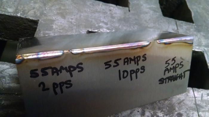

Ask and you shall receive....

Rick_H wrote:Ask and you shall receive....
Is this with the 25% background setting?
I do see the difference in the HAZ, in the coloring and ripples.
I do see the difference in the HAZ and in the coloring.
Yes 25% back, 75% peak

Ok. I'm gonna go try that on 16 gauge.

Ok, I'm a believer. I got in a hurry to try it and buggered up one of the tacks. This is way better than I can do with stainless, sans pulse. The heat input seems to remain constant rather than building up and it is definitely faster. You can definitely make much longer runs on stainless with these settings thatn you can without them. Two pulses/second definitely zipped up the seam a little faster than 10 pps did without any extra width to the heat affected zone.
You can see where I dipped my tungsten in the center of the run on the first image. I just broke it off and continued welding. It didn't seem to make one lick of difference other than the tungsten inclusion being there.
Two pulses/second ran faster and looks nicer as a finished product (in my opinion anyway).
This has been the most revealing welding experience that I've ever had.
Thank you very much!
10 pulse/sec, 75% on, 25% background, 55 amps, 16 gauge 304 stainless.
2 pulse/sec, 75% on, 25% background, 55 amps, 16 gauge 304 stainless.

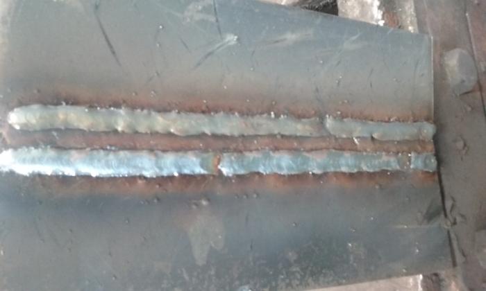

I don't think I did. This was the test and that grinder whooped my ass. This isn't the ugly one. 1/2" plate, open butt 90 degree v-groove with 1/8" land, 85/15 gas, 12" long, downhill That air grinder weighed about 30 pounds and it took forever to put those bevels on the plates. I was shaking when I finished and my forearms started cramping later. Old Lincoln Idealarc from the 60's that I had to get another guy in the shop to set for me because I couldn't figure it out. He set it while I was running a bead but it never did sound right. Didn't let the plate cool off nearly long enough and had metal dripping a couple of different times. Finally started using stringers because weaves were putting way to much heat in. I'll take a job if they offer me one but this really isn't my cup of tea. I seriously doubt they are gonna offer me anything.
Didn't take a photo after grinding and welding.

RamboBaby wrote:I don't think I did. This was the test and that grinder whooped my ass. This isn't the ugly one. 1/2" plate, open butt 90 degree v-groove with 1/8" land, 85/15 gas, 12" long, downhill That air grinder weighed about 30 pounds and it took forever to put those bevels on the plates. I was shaking when I finished and my forearms started cramping later. Old Lincoln Idealarc from the 60's that I had to get another guy in the shop to set for me because I couldn't figure it out. He set it while I was running a bead but it never did sound right. Didn't let the plate cool off nearly long enough and had metal dripping a couple of different times. Finally started using stringers because weaves were putting way to much heat in. I'll take a job if they offer me one but this really isn't my cup of tea. I seriously doubt they are gonna offer me anything.
Wow they made you bevel your pieces. What'd they cut it with?
What kind of work is it? Is it a fab shop?
Are they gonna cut straps and bend them?

It was just a test to see if I can actually weld. They cut 3" x 1/2" flatbar in a shear. Went through it like butter. It was a serious workout because those pieces took me anout an hour and a half to bevel with that heavy grinder. I was boiling sweat as if I had just stepped out of the shower.
They make a lot of heavy industrial structural and mechanical stuff. The robotic welder was kinda neat to watch. It was hard facing a 50' x 4' diameter screw for some type of wood silo.
You can see what they do here. Really nice people who politely kicked my ass!
