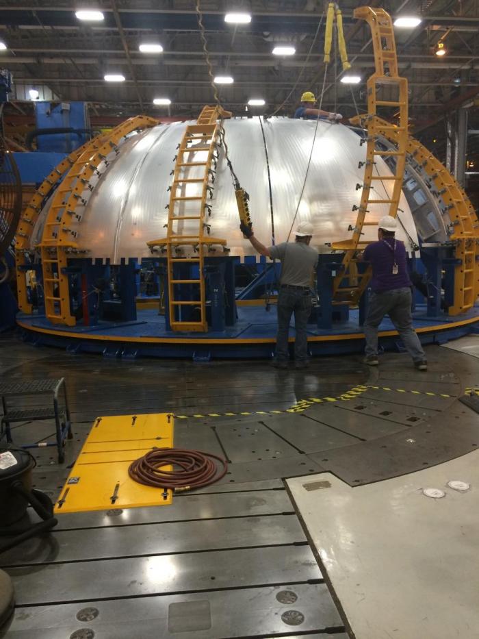

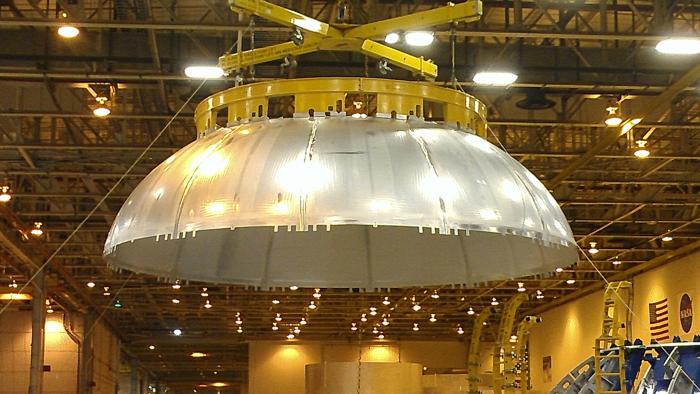

This is what I weld at work. Dome bodies for cryo fuel tanks. The bottom is 27.4' diameter. Height is 13'. All Conventional Friction Stir. The welds for each panel are 110" on .375" 2219Al.

- This is a finished build being lifted to the next weld tool:
- IMAG0400.jpg (57.45 KiB) Viewed 2974 times
- This is were we install the next panel to be welded (I'm in the LSU purple shirt on the right):
- IMG_1320.jpg (87.28 KiB) Viewed 2974 times

Amazing stuff!
