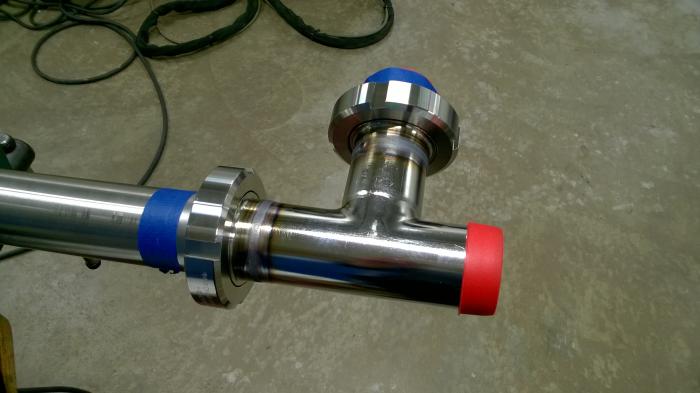

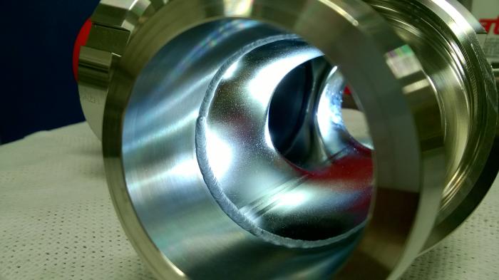

Well it seems that our thread has got out of hands :lol:
Anyway just a little job I did this week. I decided to walk the cup, because sulfur mismatch caused bit problems. Mainly undercut. Normally I would use pulsed current and free hand style with joint's like these.
-Markus-
motox
    Thu Nov 28, 2013 12:49 pm
    Delaware
super clean weld!
    Wed Aug 06, 2014 12:48 am
    Melbourne, Australia
Exceptional. Superb control. You'd be happy about those results.
    Thu Dec 25, 2014 9:25 am
    near Chicago
Beautiful work Markus.

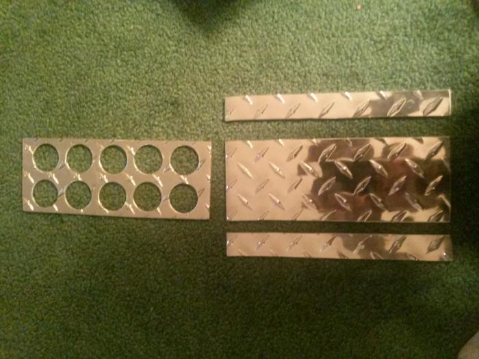

Nothing to great today. Needed some place to store a mess of 1-2 lbs of rods. Added on to the cart storage an area for 10 small storage tubes. Still need to build the tubes.
    near Chicago
Nice work...nothing prettier than diamond plate...your spoiled :lol:
dirtmidget33
    Tue May 13, 2014 5:22 pm
I am very very picky. You would prolly be surprised if I take a pic of the drawers and cabinet on other side how it is organized.
:D
    Fri Apr 01, 2011 10:59 pm
    Australia; Victoria
Very professional set up. I wonder zanks is that good, or will he have to copy yours.

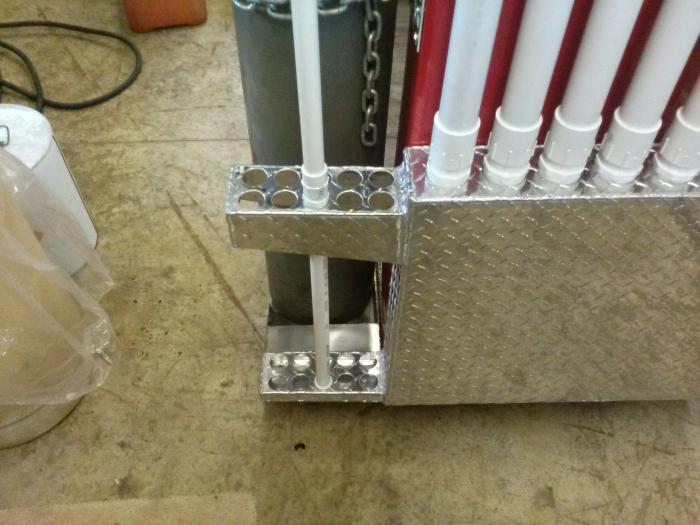

this is a follow up from an earlier post where I expanded some storage on cart. I finished the storage tubes and took a pic with them all in place.
    Sun Sep 22, 2013 10:14 am
    Minneapolis Mn 55407
Very nice
Everlast 250EX
Miller 250 syncrowave
Sharp LMV Vertical Mill
Takisawa TSL-800-D Lathe
    Sat Mar 30, 2013 11:49 am
    Sweden
Do you color code the used rods as on the storage containers?
dirtmidget33
AndersK wrote:Do you color code the used rods as on the storage containers?
As you noticed the labels are colored by type of rods. Tubes labeled depending on what's in tube the system works as follows
Yellow = steels example ER70-S2, ER80-D2
Blue = Stainless steels 308L, 309L you get idea
silver = titanium
Orange = aluminum
Red = aluminum bronze
Green = silicone bronze and copper (currently out of)
Black = magnesium
Now short used rods work a little differently I have 3 tubes that are 1/2 inch in diameter. These tubes mounted on other tube rack where excess rods go or stuff I don't have room for on cart. Short rods broken into three classifications and labeled accordingly. I can mix a few of these together cause there is a physical appearance difference plus all rod I get is stamped on both ends so one end is always marked.
First one is Steel and stainless steels grouped together.
Second on is aluminum and silicone bronze and aluminum bronze
Third is magnesium and titanium
Size of tube makes difference to
1 1/2 inch tubes hold 10 lbs except aluminum each one holds 5 so aluminum takes 2 tubes reason for the other rack excess rod
3/4 inch tubes used for rods that I only keep 1 to 3 lbs of
1/2 inch tubes are mixed tubes with used wire at most might be 1 section of each rod in tube.
