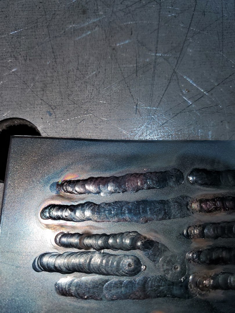

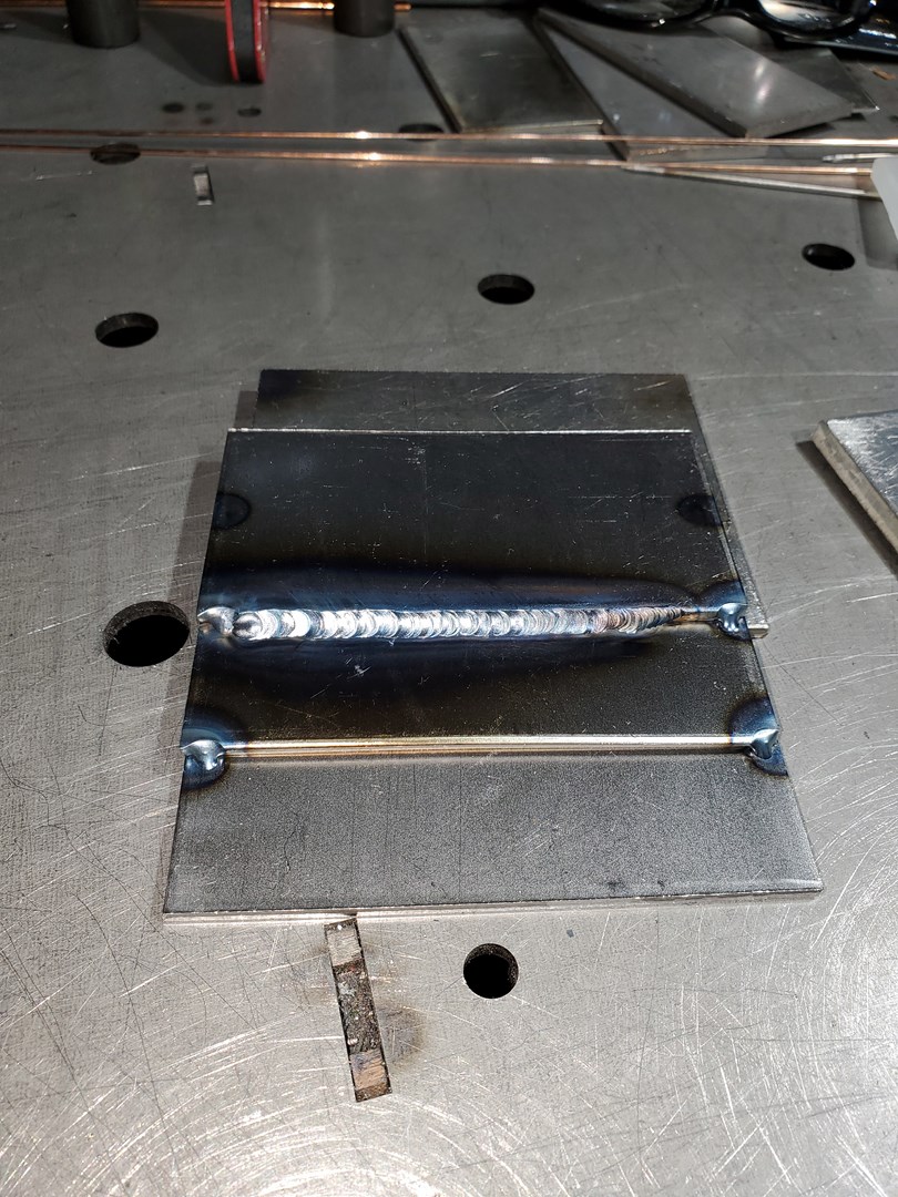

I'm attaching a picture of what I'm still struggling with. The question I have is about arc length. I think I remember correctly that heat input is a function of current and travel speed. What I can't recall is arc length and how it affects the puddle. With a very short arc length does the heat input increase? In the picture you can see some of the beads that start off fairly well, and then overheat and end up with the fisheye that you and Tweake mentioned. My number one problem is that I am having trouble "seeing" when that happens. I'm working on different positions for my helmet to see if that will help.
The question I have about arc length is what is bugging me the most. I am reasonable certain that I am keeping the arc length is fairly short. I think you may have mentioned in a PM to me, that with a sharp point on the tungsten, the arc will actually jump off the tungsten higher up from the point. In the case where I have a very short arc I'm thinking the point of the tungsten may actually be a lot closer to the puddle than what it should be (pretty close to touching). I hope it makes sense the way I described it. I was thinking if the arc is really coming from higher up the tungsten, then perhaps I should dull the point on the tungsten? Or, maybe I should just focus on a longer arc length? (I think I'm using too many words to describe this so I'll just leave it at this and if I left anything out, you can ask me to clarify.)

That’s a bit of a rambling post… so I’ll try to dissect what I think you were asking as it relates to what I see in your welds.
The welds are fine. They appear to be welded with a proper arc length. The overheating is a function of material thickness and time spent welding. The thinner the material, the less time you can weld on it before it becomes saturated. You then have to quench it (only during practice mind you!) or you have to wait until it cools naturally.
I admire your ambition to master the hard things first, but in reality you are causing yourself unneeded anxiety by welding with 0.045 and 16ga. Learn to weld on thicker material with thicker filler. For most hobby welding, 3/32 tungstens and 3/32 (sometimes 0.063) filler are the go to. I would wager that I weld about 12-15x more 3/32 filler than 1/8, and probably 45x more 3/32 than 1/16. You simply dab less in with larger filler and get the benefit of having puddle heat control if you need it.
As to “seeing it happen” on the heat saturation, that only comes from experience. The total number of things your eyes will see while welding are: puddle size, puddle condition (too hot, too cold, sluggish, etc) line of travel, width of puddle (joints) arc length, torch angle, and base metal heat condition (how close to saturation or blow-out are you). Oh, and the end of the filler wire and how much is being introduced each dab. The point is: there is tons to see, everything matters, and you can’t master all these variables at once.
So eliminate some of the challenges and give yourself a fighting chance to weld some joints, get some success, and learn in “real world settings”. Welding stringer beads on flat plate is decent practice for an absolute beginner, but you’re past that now. Put those spindly bits down and start gluing some 1/8” material together. Lap joints, butt joints, t joints.
You will discover how much closer to “capable” you are once you attack some joints and abandon the flat pieces. And FFS, who cares if your beads aren’t perfect like Instagram heroes? Those guys have doing this shit for decades, daily, all day long. As long as the weld is strong, that matters most. Aesthetics can be brought to bear later.
Now ditch the keyboard, drop your hood, and light that sucker up!

Jeff2016
    Thu Mar 10, 2016 4:09 pm
Hey Guys,

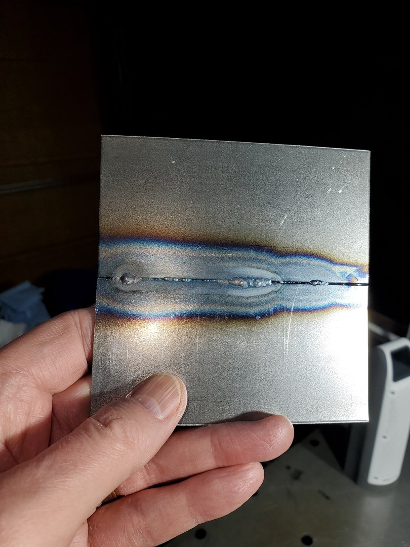

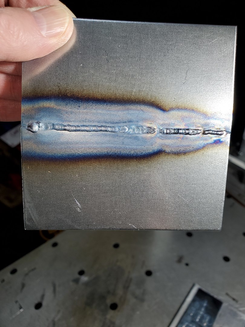

I did run a couple of butt joints on 16 Ga, since that's what I had out at the time.
I know it started off cold.
I know I got a little too much heat.
One picture is the front side, the other is the back. (Hopefully they will stay oriented correctly. The travel was from right to left.)
Thanks,
Jeff

actually its to cold all the way through, which is why the material overheats.
sounds weird, but travel speed is the biggest factor in heating up your part, and travel speed is dictated a fair bit by how many amps your running.
as the penetration sucks on that, your running the amps way to low, that means your travel speed slows down, which makes the material heat up more.
test your amps first by just by doing a few quick tacks. see if it penetrates all the way trough. up the amps until it easily penetrates. then weld and try and keep up with the puddle.
it just takes practise.
cj737
    Thu Sep 29, 2016 8:59 am
Try to create a very small gap in the joint when you butt weld. It will make getting penetration through the piece easier and make it easier to use the thicker wire to put enough heat in, and still control the puddle with dipping to cool it off.

I'm running 65A at the box. When tacking the coupons together, one end actually burned through. I probably backed off on the pedal intentionally to keep the weld from getting too hot.
What's a little confusing to me is that I recently watched a video that showed a 16 Ga weld that looked similar. It had a defined heat affected zone; but, it didn't have a continuous fusing between plates shown on the back side. I thought it was an example of a good weld for thin metal; but, I sure could have misunderstood it.
I'll try another couple of welds with more pedal this week.

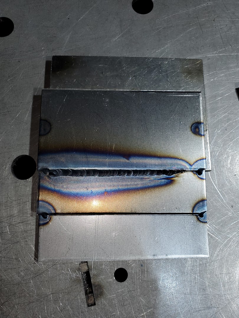

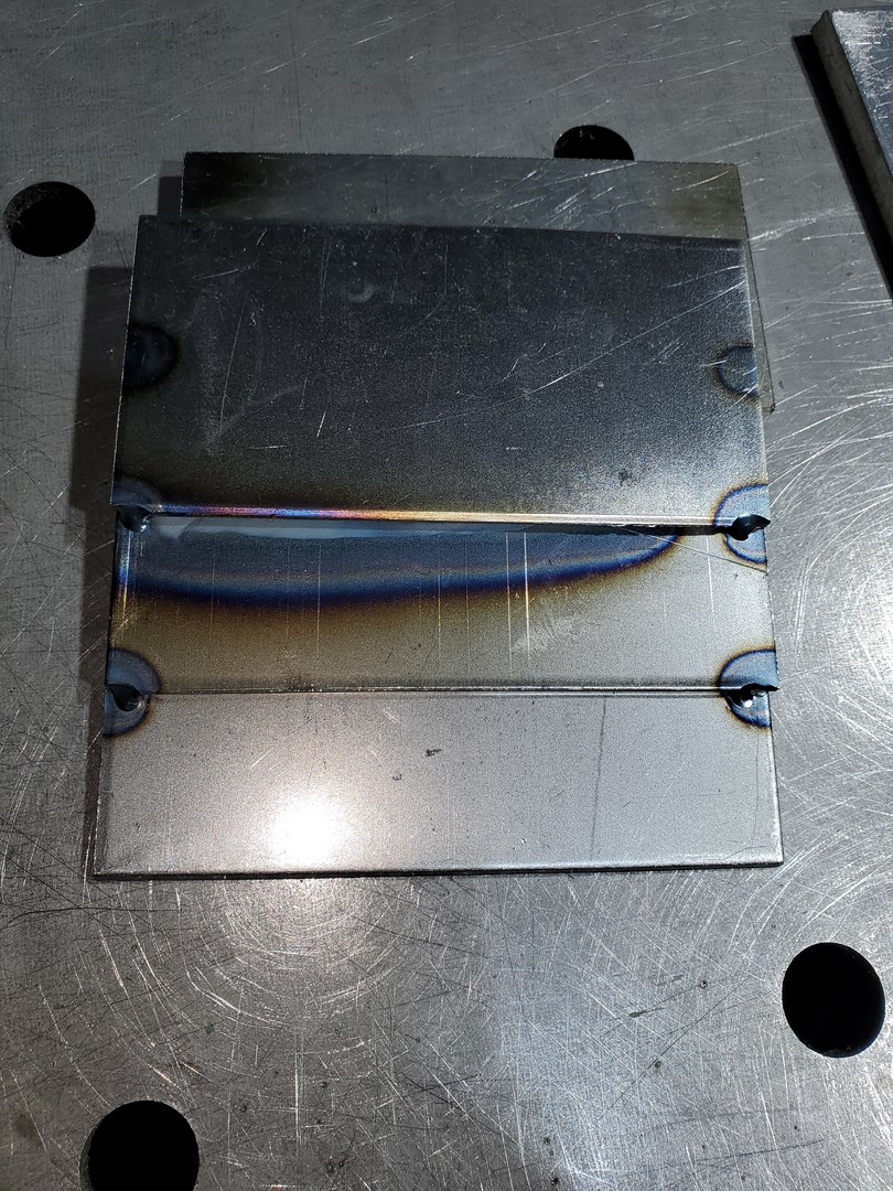

Attached are pictures of one of the first lap joints. 120 A, 1/16" ER70S6 filler, and 20 cfh of Argon.

For thinner material, like the 16 Ga, is it wrong to think that I can reduce the heat input by lowering the current along with increasing travel speed, or should I just work on really moving along with the amperage based on the rule of thumb (1 amp per 0.001")?
Moving along at a faster pace is what's really going to be a challenge until I get more burn time.
Thanks,
Jeff

Those pics look pretty good. Your starts and finish need just a bit more time.
The arc starts then you get a puddle with both sides, then you move at comfortable pace. When you finish double dab filler swirl and let button go or if using lift arc double dab filler, swirl, drag out of pool and snap out. Otherwise it looks ok. And your steel is nice clean and the weld shows it.
In regards to your other post on gas calc, i know that thread is over there but its too far to bother going there so I will mention it here :lol:
The bottles CfH total divide by what cfh your using should equal hours in a tank. Then I usually times that by .7cause I am only arcing 70 percent of the time Im in the shed at the weld stage of a project. Thats easy enough to get you a ballpark figure.

You can run slightly lower without causing too much trouble, but what you aren’t understanding is the filler is crucial to heat control. Every dab you make cools the puddle. So on the 1/8” examples above, with 3/32 filler you’d get better welds (better profile) won’t be starving the puddle for filler (risk over-heating and edge burn off) and you could run 120 amps under control without having to hustle to keep up with the smaller filler.
If you insist upon using 1/16 filler, stuff it in there about 2x as much as you do until the bead profile is fuller.

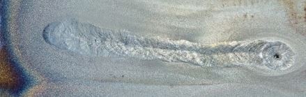

Can someone tell me what is causing the defect shown on the attached picture? Is it only because of the high heat (yes, I know it is much too hot), or could this also be due to the tungsten being too close to the puddle? (The line in the center of the of the weld is what I am interested in.)

When you get that line in the weld its a good indication that you need less heat or more filler. The fish eye at the end, regardless of other reasons is also an indication that you need more fill ans especially at the end. It appears your filler feed isnt keeping up with your heat, if you just moved slower it would be a right mess so you need to tune your heat to match your hand speed vice versa.
On a side note if you get that line in a mig weld then you need to add more amps/ wire. That line isnt devasting but it is a good indication that you are close to limit of how low your filler can be and vibrations on some parts can often lead to it cracking on that line if the underlying gap is too wide. Just a bit of info.
Going forward bro, drop amps and try again or move up a filler stick size.
The weld is what matters, all the guides make it easier to get a ballpark but you can modify guidelines as needed.
Thanks for your reply.
Your advice makes sense.
I'm running 63A on the welder and using the pedal to reduce the heat when it starts to get out of control.
I know that some of the guys here have good advice moving up to thicker metal to get good with first. I'm just determined/stubborn to be more consistent with the 16 Ga. Some days the coordination of everything just doesn't work...
Maybe just a bit of refresher... Does the height of the arc above the workpiece tend to establish how wide the bead is?
And, does a shorter arc (tungsten closer to the workpiece) generate more heat in the workpiece for the same amperage and travel speed?
Thanks again.
Jeff
cj737
Distance of the tungsten does effect the “heat affected zone”. It actually causes a hotter weld because the arc is less focused on the weld line.
The closer the arc, the more control of the heat, the less HAZ.
For thinner material, don’t “romp” on the pedal to create the puddle. Just enough to initiate the arc, then smoothly increase the heat to get your puddle started. Start adding filler, then watch when you can taper the heat (pedal) because on thin metal, it absorbs too much heat pretty quickly.
As an example, start with about 20 amps, get your puddle (around 50-55 amps), start dabbing and moving (60ish amps). After about 1-1/2” inches, you can probably start working back towards the low 50s on the amps. Finishing (eliminating the fish eyes) around 25-30 with one final extra dab.

Jeff2016 wrote: ↑Tue Jan 11, 2022 5:37 pmMaybe just a bit of refresher... Does the height of the arc above the workpiece tend to establish how wide the bead is ?
Yes, but that is also a function of time, and torch angle.
Jeff2016 wrote: ↑Tue Jan 11, 2022 5:37 pmAnd, does a shorter arc (tungsten closer to the workpiece) generate more heat in the workpiece for the same amperage and travel speed?
Thanks again.
Jeff
No, it generates less heat (because the voltage is lower and the heat input is related to the wattage, aka volts x amps), BUT don't confuse that with not being able to produce a molten weld pool; IOW it doesn't mean that it isn't as effective, because it is not significantly less, and the shorter arc length changes the shape of the arc cone (a little narrower), and thus it will be more concentrated over a smaller area, so the power density (watts per square mm²) can still be high enough to create sufficient heat to produce a molten weld pool. All that science talk aside, if you can maintain a consistent arc length equal to approximately one tungsten-diameter, you'll be fine for pretty much any scenario you will encounter.

cj737 wrote: ↑Tue Jan 11, 2022 7:52 pm Distance of the tungsten does effect the “heat affected zone”. It actually causes a hotter weld because the arc is less focused on the weld line.
That's great information. Thanks for all the detail. The last paragraph is especially helpful.
My work is picking up, so I'll need to make sure to carve out time on a regular basis to keep working to get better.
Thanks,
Jeff
