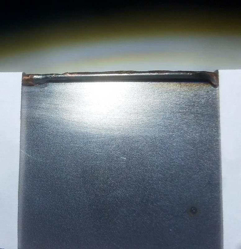

Above the corner weld (penetration) on the backside, there is a gray-looking bead with a small bit of sugaring. That was done without purge Argon.
Nothing to see on the outside. I used filler rod on the corner, but didn't get much penetration. So, I went over the corner again with a fusion weld.

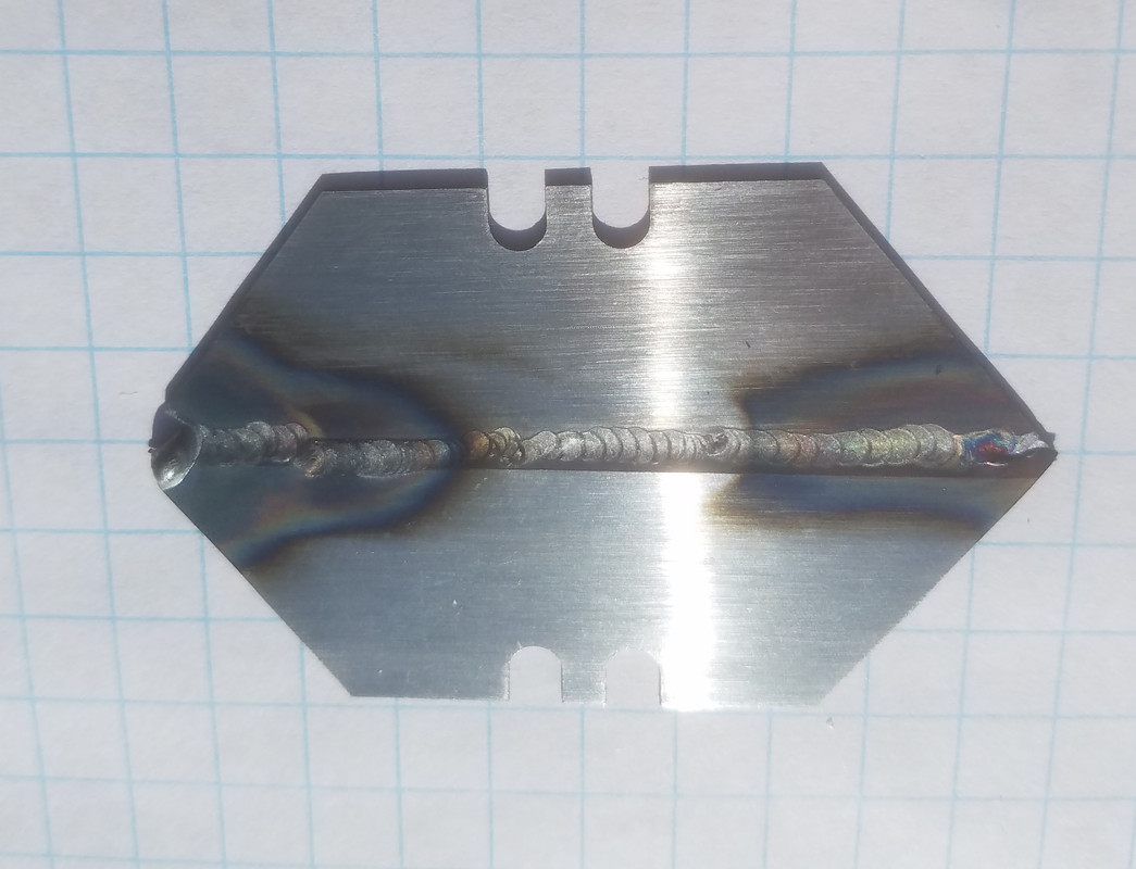

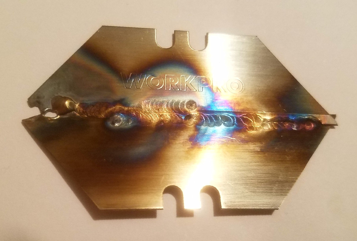

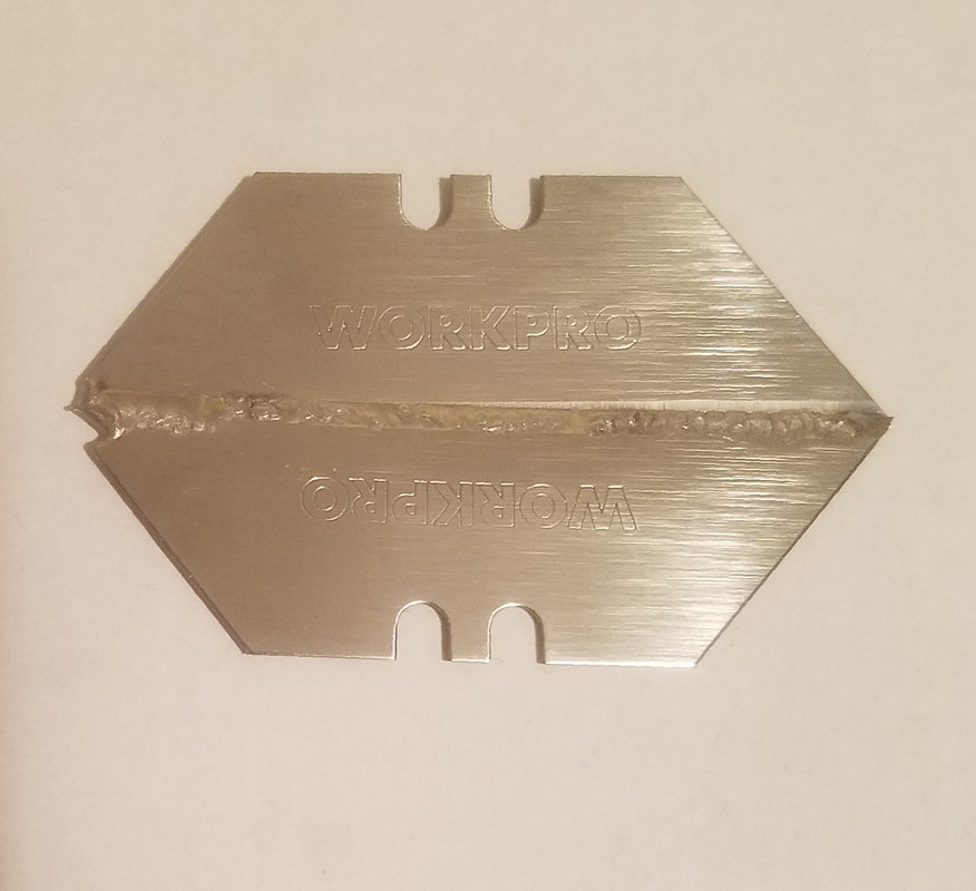

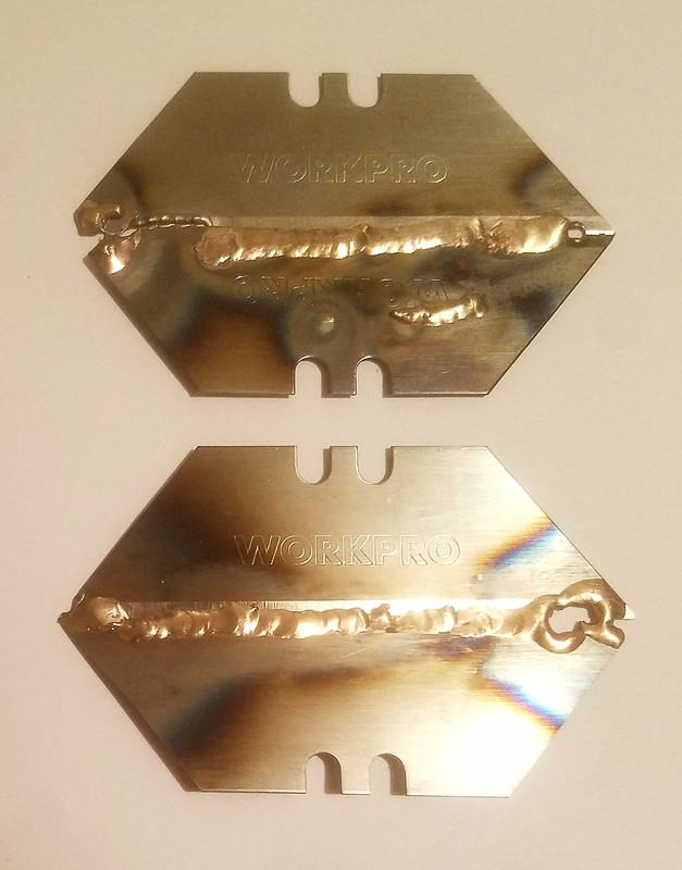

The 2 videos I saw showed razor blades being welded end to end. The utility blades I have are 0.021" thick, so that isn't so impressive. I decided to try edge to edge.
Tried welding and TIG brazing. Unfortunately, I didn't have any ER70S filler rod in 0.035". Tried some .045" rod, but it didn't want to melt. It worked, but not well. The welds you see here are fusion welds (no filler). Pretty difficult on the edge.
Will try again soon.

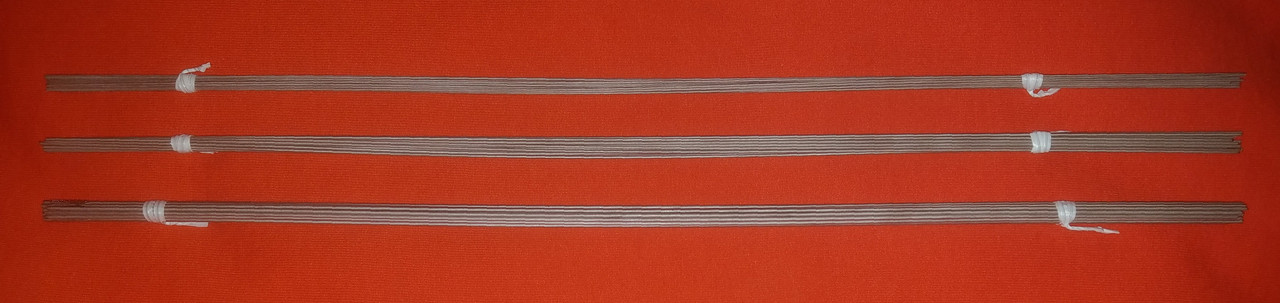

Titanium filler rod arrived. Got Grade 1 titanium in 3 sizes to try out.

Watched a couple more razor welding videos.
Next time, I'll use aluminum chill blocks and a needle grind on the tungsten.
Should have said I used 15 amps, 15 cfh argon, .040 2% Lan electrode. Tried a filler rod from the instructor. Was supposed to be .035 or .045 stainless. Couldn't get it to melt. Tried .045 ER70S rod which seemed to thick. Will try my own .035 308L filler rod next time. The brazing rod was .035 silicone bronze.

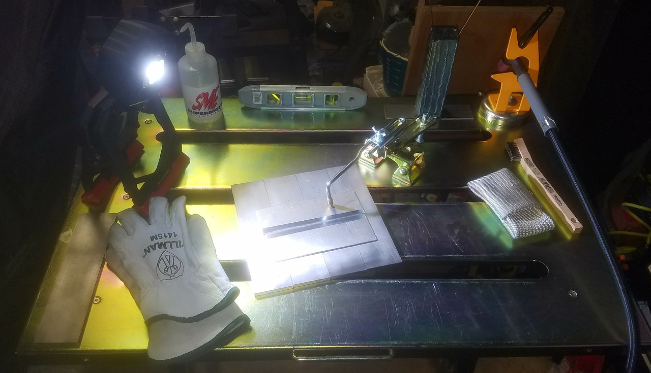

Tried to figure out why I can't see where I'm going when welding. Bad news is, it's not my hand position. I can see the puddle clearly, but everything outside the arc light is black.
I'll check the shade setting on my helmet, but I know I didn't set it very dark. I've always had poor night vision.

Kodokan wrote: ↑Fri Apr 29, 2022 10:01 am Tried to figure out why I can't see where I'm going when welding. Bad news is, it's not my hand position. I can see the puddle clearly, but everything outside the arc light is black.
A good, strong, work-light illuminating the area you work on could help a lot there.
Also make sure there's as little light as possible coming in from the back of your helmet (eg. a roof light shining down behind/above you) and getting you light reflection from the lense on the inside. That can also ruin your vision for seeing low contrast features outside the arc and puddle itself. As a test you can clip a rag or similar to the back of your helmet to see if it improves things.

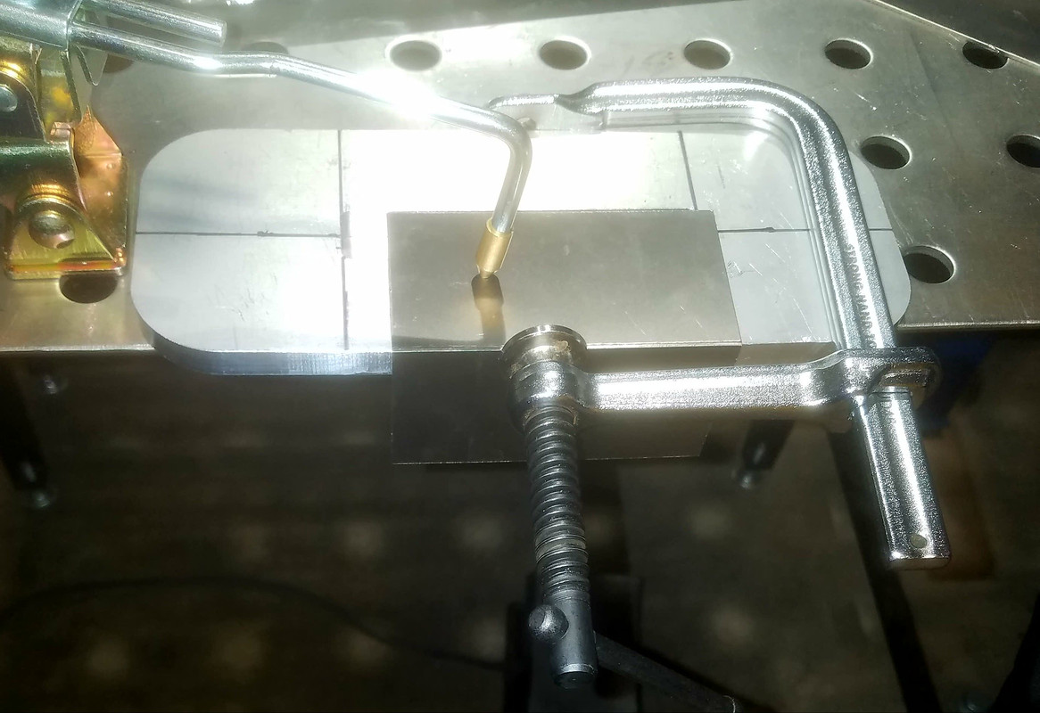

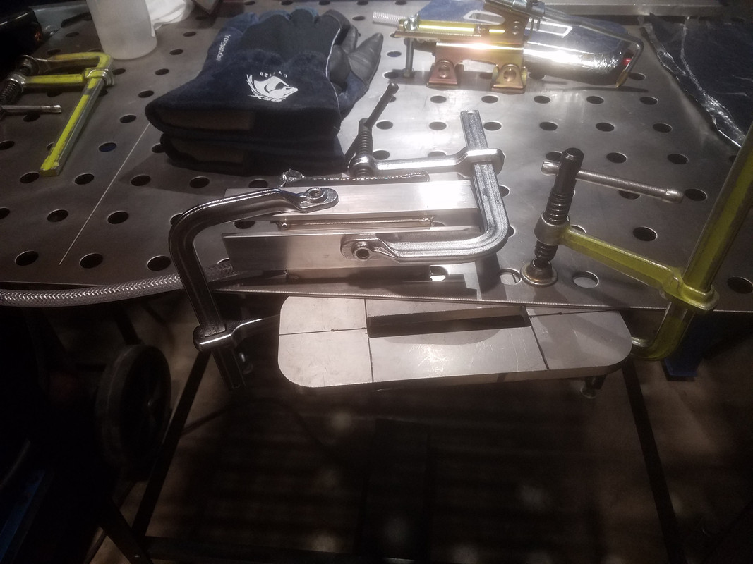

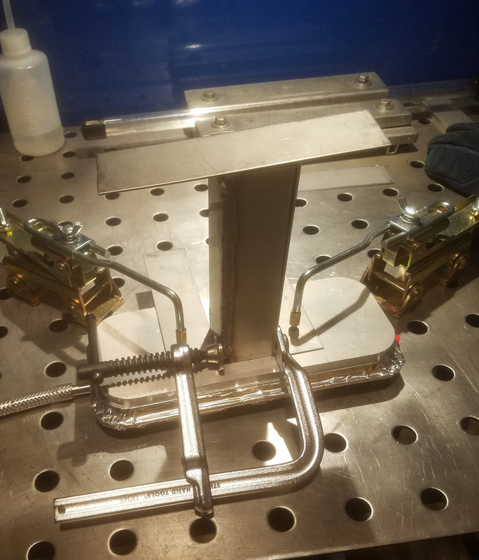

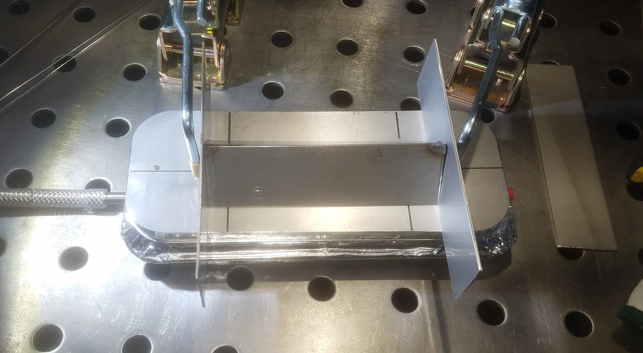

I posted pics of my DIY purging fixture, and how I do the corner weld setup. Here are a few more.
Purging flat tacks on titanium:
Used the top plate to hold and cool titanium for corner weld tacking:
Purging stainless for vertical corner welds:
My clamps don't fit through the holes in the welding table at school, so I have to clamp near the edge. I use the purging top plate as a shelf to support my hand/wrist. Here, I set up titanium corner welds with aluminum chill blocks. The ends are sealed with heavy aluminum foil, and the purge tube goes in one side.

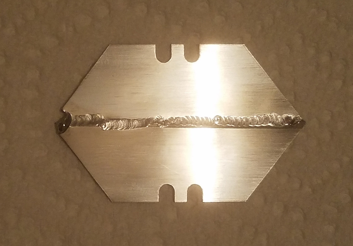

Figured out a setup for razor blades. Need all the help I can get, for a good outcome.

Arno wrote: ↑Mon May 02, 2022 1:00 am A good, strong, work-light illuminating the area you work on could help a lot there.
Bye, Arno.
Thanks, Arno.
I guess I forgot to mention that I use a very good work light. Bought it after my very first day of welding class. It's super bright, but only helps a little when welding. Sometimes, I can't get it into the right position, or it makes a shadow on the welding area. Happy to have it, though.
Once, I was welding in my open garage, with the sun at my back. So much light was coming in the back of the helmet, I could hardly see through the lens. I threw a rag over my head, and problem solved. Haven't thought about it at school, so I'll check it out. Thanks much for your help.

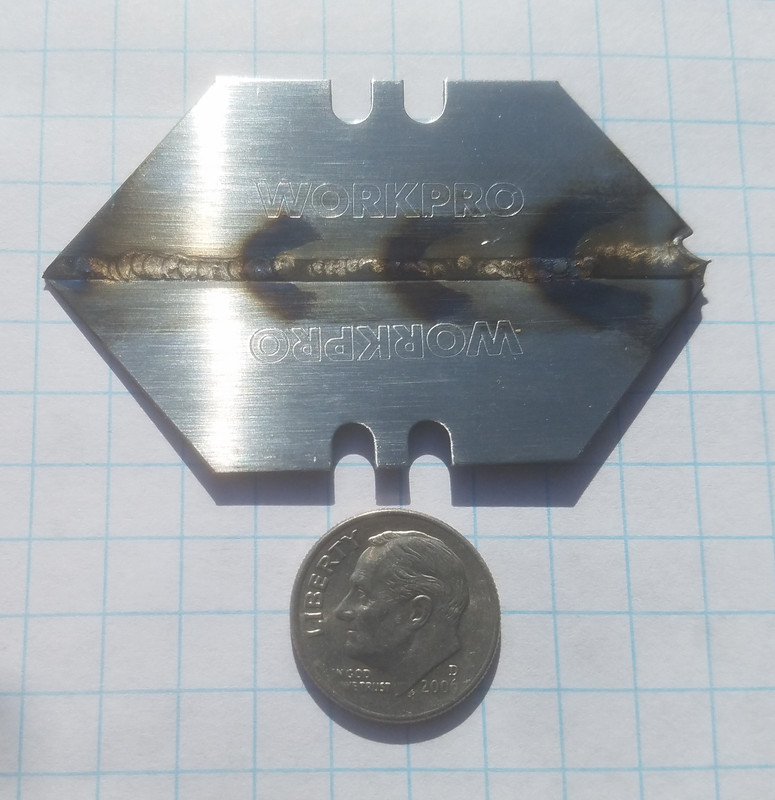

2mm dimes.
The larger cup I used takes a 3/32" tungsten. I would have preferred an 0.040" size, or at least a 1/16". Need more practice, but happy with my progress.

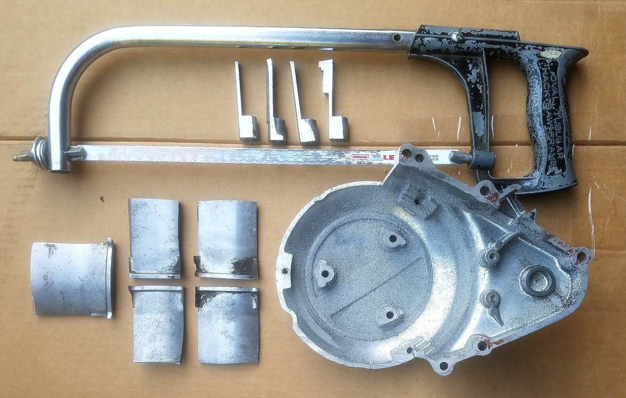

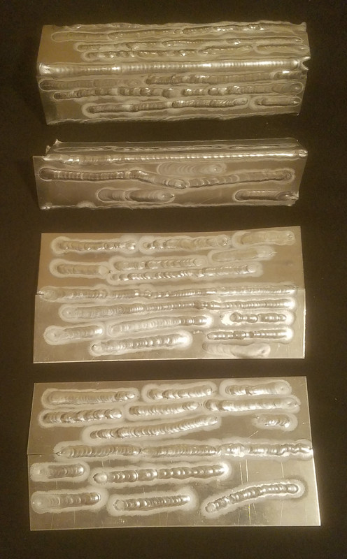

I wanted to try welding some cast aluminum, so a friend gave me a couple of motorcycle engine covers.
I don't have an ultrasonic cleaner, or even a parts washer. I could spend a lot of time with acetone and a brush, but it's not going to clean out the decades of grime from the screw holes. Decided to get a workout and cut some (easy to clean) coupons by hand, since I'm just practicing/learning.
Well, it's definitely different. Started at 125 amps, then 100, ended up at 65 which might be a bit low. Instructor gave me some unknown number filler rod which was shit. I used 4043, but the beads look porous. Was trying to get some 4047, but it's pretty hard to find. Next time, I'll try 5056 filler for comparison.
For sure, it's the most difficult type of welding I've tried. The large craters are where I tried the shit rod. Still have more cast aluminum to work on. Also want to try welding cast aluminum to billet.
I cleaned the coupons with acetone, but probably should have used Scotch-Brite, too. Will do, next time.

Welding cast motorcycle parts is a real treat. Some things you can do to help:
- Preheat them. Don’t just clean them with chemicals and wire brushes, but use some heat to help drive the impurities out of the part before you ever light up an arc.
- Run a pass with the arc over the area to be welded. This too will help “prep” the surface before you begin adding filler.
- Peen each pass, even the “prep” pass. Peening helps drive porosity out of the weld in between passes.
- Manage the heat input. The longer/more time you spend with an arc on the part, air trapped inside the casting will expand and cause “blisters” in the parent part and shows as porosity. These old motorcycle parts were not high quality castings from high grade alloys. So expect there to be heaps of trash and grime in them.
- Avoid 4043 for cast parts. It works well on nearly everything else, and can in a pinch, but 4047 or 4943 work much, much better. I don’t like 5356 for cast either, it just doesn’t seem suitable as a filler.
- Brush and chemically clean between each pass. With cast, there’s just no substitute for constant cleaning.

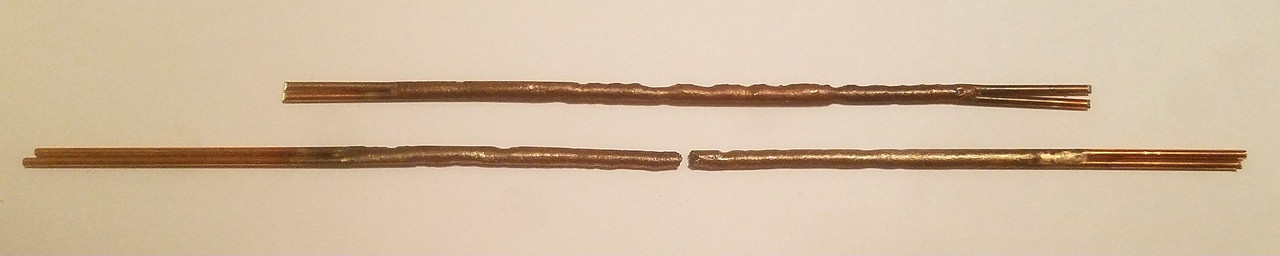

Thought of a good challenge for school tomorrow.
Will try to TIG braze two 1/16" ER70 rods together lengthwise.

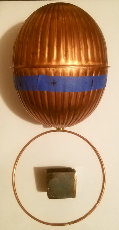

Also bought a copper toilet float to try TIG brazing.
Thinner than rice paper, Grasshopper.

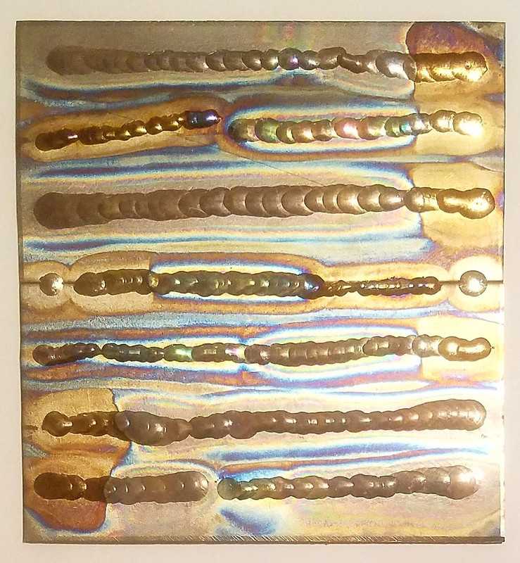

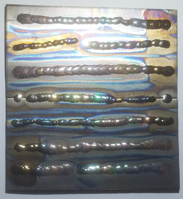

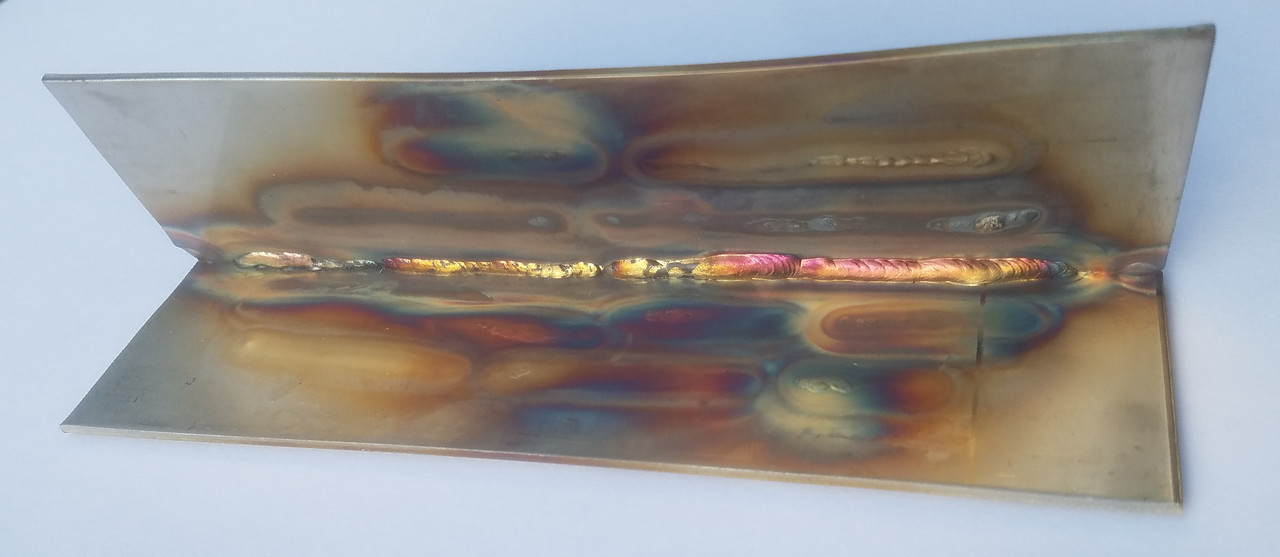

Forgot to post my first attempt at welding titanium. Used 2mm grade 2 titanium, 1/16" grade 1 filler rod, 3/32 2% Lanth tungsten, 20 CFH argon, 1/2" cup, 100 amps.
Didn't get much penetration, but that's normal for me. Have to say that titanium is the most enjoyable metal to weld. Puddle and filler rod flow super smooth.
Can't get good pics with my phone. The coupon finish is flat/unpolished, so after welding the HAZ colors are flat. But, the welds are as shiny as can be. They shimmer, glisten, and sparkle under the light- with no cleaning, whatsoever.
Pretty sure a good titanium weld should look like the third one from the top. Colorless/silver in appearance. Will probably take some time to get it figured out.

Tried brazing the 1/16" filler rods. One was okay. One got brittle, and broke after welding. Need more practice. Deleted the finished pics by accident, then lost the pieces, as well.

Ordered some brass tire valve parts to cut up and fabricate a burner. Should be here in a week. The air ship propeller is coming on a slow boat from China. Probably a month before it arrives.
Took a ridiculous amount of time to get the upper harness ring round and flat. Must have bent it a hundred times with my bare hands. Very happy the brazing went well. Looks like there's a small kink, but that's where the numbers are stamped.

Okay, so back to where I was. Trying out some brazing on very small parts.
These ER70 rods measure 0.059". Tried to add enough silicone bronze filler to flow completely around the rods. Without melting or burning the rods, of course. Already posted a pic of the setup.
First try was lumpy. Second try cracked in the middle. Must have got it too hot.
Still pleased with the results.

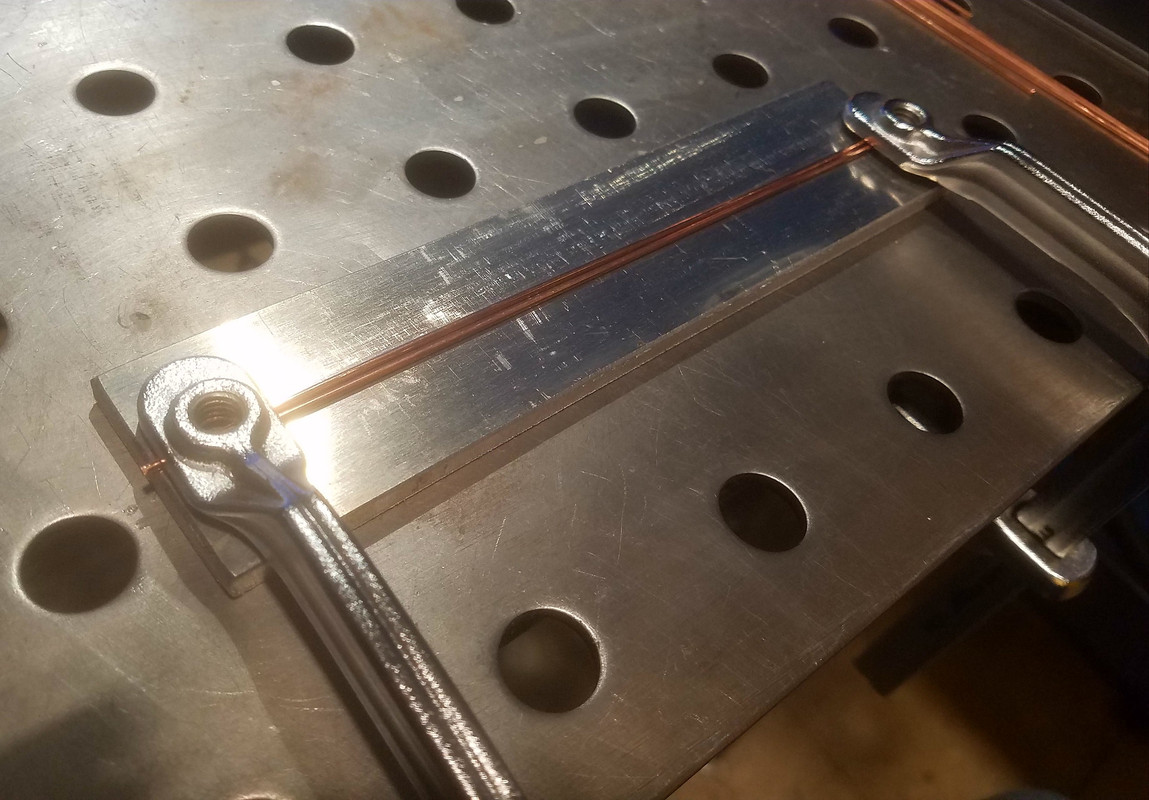

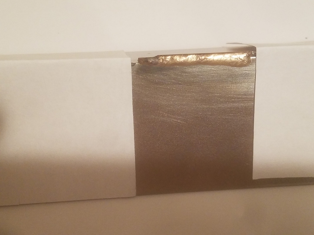

So with those rods I TIG brazed, I applied the bronze on top and let it flow all around and onto the bottom. I was curious if I could control the flow, so I did a little experiment.
I placed a 1/16 inch rod onto an unwelded corner joint. Then applied silicone bronze to one side without letting it flow to the other side. Pics aren't very good, but the experiment worked great.
Bronze applied to one side.
No flow onto the other side.
