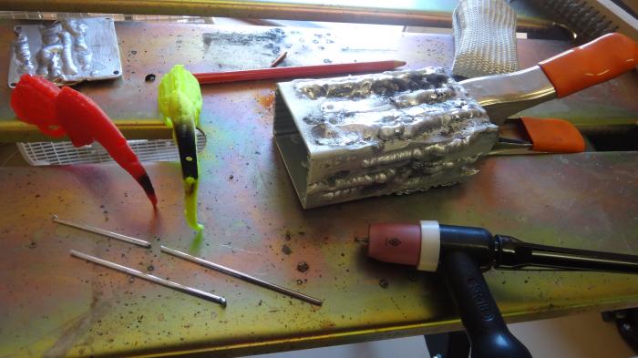

Finally got my Everlast 256Si TIG / Stick / Plasma with the water cooler! This thing is pretty awesome! The HF start though on AC is interesting, kinda sounds like a wicked wet fart. ya know the one you run to check your drawers afterwards.
Very pleased with the unit but I'm a n00b so my opinion really doesn't matter yet.
Either way here's some of my results and I'm curious about the aluminum bead closest to the camera. The one in the center I think started out horrible (right to left travel) but then I sped my travel up real quick which you can see where it gets flat and I had a re-grind when I started that one too. I then slowed down just a bit and you can see the final end of that travel with the center bead on the far left side.
The last bead is the closest to the camera and I started out slow but then picked up the pace near the end doing the pause, dip, move technique. I'm thinking this looks good and would be considered an adequate weld but I'd be curious what the experts got to say. I'm not sure how the end of either weld appears since I see what I'd assume is oxides. I paused, added a fair amount of filler, removed the rod, then tapered down the foot pedal for about 1-2 seconds then held for post flow.
The steel looks like I did not have enough Amps for the thickness even when I mashed it too full throttle.
I was running the unit at 100Amps for Aluminum (1/8" thick ) and 90 for the steel (1/2" thick). The aluminum was running probably about 2/3 foot pedal so I'd guess about 60-80 Amps.
You can see the rest of the horror I dished out to this aluminum project box I picked up at Fry's about 8 years ago. That's where I started and what I learned from all this was I was going too slow, had WAY too much Amps with the pedal mashed for most of it, and probably the most valuable lesson I think I've learned so far is tungsten grinding. I did a horrible job at grinding at first where I had an uneven grind all around and even a flat spot for a couple of the re-grinds (lots of re-grinding). When I had the flat spot the arc mostly wanted to arc to the gas cup which was scary. Once I gave it a proper grind with a decent tip, things went much better and that's how I was able to lay some actual beads.
I found the steel to be much more forgiving with the tungsten grinding but still I had horrible results on my other test piece which again was running way too hot and the arc was still not friendly. Once I had a good grind again, it seemed to hold much more what I'd expect it to do, but again I think I didn't have enough heat for the 1/2 thick piece.
I did use my TIG Monster Claws for some of this job especially the last bead and it worked out great IMO. I melted the shit out of my first claw but that's when I was camping out on the spots for way too long with way too much power. Once I figured out a faster travel speed helped out, the TIG Monster Claw held up really well. I've done about 30 minutes under the hood total and so far it seems they're not melting on me any more. This thing is pretty awesome and I'm looking forward to Oscar and Rick's review since I sent them each a set but from the n00b, I'm not sure if I could have made that last bead on the aluminum as nicely as I think it is without the claw. I used Jody's TIG finger for some of the points where I could rest my finger easily and this thing works pretty nicely too. Still, just a n00b but maybe I'll be a true TIGger one day
So in the end I'd be curious to get some criticism on my progress. Be as cruel as you'd like, you won't hurt my feelings
One other question is how often should I be re-grinding tungsten assuming I'm not f'in up? Do I need to re-grind when switching materials and is it more important going from steel to aluminum or from aluminum to steel, or just never/always?

Not bad..really. Too cold on the mild steel but your doing ok on the aluminum. You have the idea, you just need more seat time and you'll get there.
As far as re-grinding tungsten...Tungsten breaks down as you use it and forms nodules that could cause your arc to wander or become unstable. You won't learn how to weld easily with crapped up tungsten but you will make life easier on yourself if you practice with a fresh grind. After you get your wings, then you will get the feel for welding with a crapped up electrode and you will just deal with it. Sometimes you can dip in steel and keep on going but when you dip in aluminum, you need to stop and regrind as you will not be able to continue. And don't be afraid to crack off the end of your tungsten rather than trying to grind off a dipped mess.
You're gonna F up some tungsten when you're learning but then one day it will all come full circle for you and a pack of tungsten will last you a long time. Part of the learning process and we ALL had to go thru it. Try different grinds and have you will see the differences so don't be afraid to experiment.

Entity-Unknown "I was running the unit at 100Amps for Aluminum (1/8" thick ) and 90 for the steel (1/2" thick). The aluminum was running probably about 2/3 foot pedal so I'd guess about 60-80 Amps."
Those amps are really, really low.
1/8" aluminum, 150 amps - more when starting the puddle - it should be formed in 3 seconds or less.
1/8" steel, 125 amps.
Those amps will give you enough heat to pick up travel speed.

Rock on guys! Very helpful and insightful for this hobbyist who'd never get paid to lay beads.
I've been re-grinding almost every run, and I've tried a few different grinding angles. I think I need to start taking a picture of the grind and logging the results in a book or something. I think the tungsten is probably the most important part that we control that a n00b needs to think about before TIGin.
I'll try kickin up the amps a bit and see how it goes but those amp settings for aluminum is what was tearing it up with. I had the worst tungsten grinds then too so it might just be the n00b perception (multiple factors for failure) so I'll give that a try now that I'm gettin at least something that resembles a weld rather than radiation burn.
So two things that were interesting to find out as well... Running without the gas turned on almost destroyed the entire stick out of the tungsten, and created what reminds of of cyanide powder on the inside of the cup, gas lense, and all over the aluminum. Perhaps if you crushed up tylenol, got it all nice n pasty, covered the whole area and let it dry you have the same results I had. Absolutely zero arc control and a complete mess.

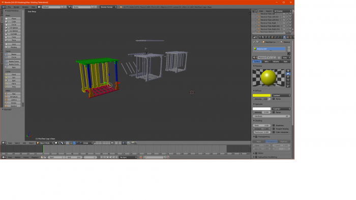

One day when I know WTF I'm doing I'll be stick'in this table together. The general bill is looking about $800 for the steel to build. Haven't decided yet on C-stock or tubing for the top yet but I think C-channel will be the winner. TBD!

You will be alot more comfortable with a good table. You don't need to go crazy on cost to get a good one either. Other than that you just need seat time. Jody's vids are awesome and I still go back and watch them because there is always something I pick up that I missed the first time. I got back into tig about 2 years ago after a 15 year layoff and even though I sorta remembered how to tig, Jody's vids got me up and running in a few weeks and now I am very cofident again but I wish I got more tig work . I have a stainless job tomorrow that I am pretty excited about but other than that its mundane mig all the time. You're gonna have a lot of fun and even more fun that hobby welding is when you start making money at it.

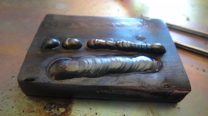

So a bit more practice before I run out of gas and before I called it a day. Time to hang out with my true love. I think I'm progressing pretty well for a beginner but I've got a long ripply road ahead of me with hopefully the least amount of bird turds running along that beaded path.
You all are awesome and I appreciate the insight. I wouldn't be able to have gotten this far without the educational videos and reading all the posts I have before I got started. I'm kinda sad I didn't get into this sooner but I've got many years of happy welding ahead of me. Can't wait to be a true TIGger
- Here's the 1/2" steel with the 2nd bead run using 138 Amps at the unit and probably 3/4 pedal. IMO it's my best bead yet! DC is so quiet too.....
- DSC03656.JPG (30.56 KiB) Viewed 1872 times
- I think I'm getting decently better. Just trying different things. It looks like I've got some good tie in but not consistent enough. Def a lot less bird turds. I dipped once and you can't miss that one but mostly looks like I've got good arc length, I think.
The big question I have here is does it look like I'm feeding too much rod? TIG Monster Claw is makin it easy but I think I'm dumpin too much in? - DSC03655.JPG (41.11 KiB) Viewed 1872 times

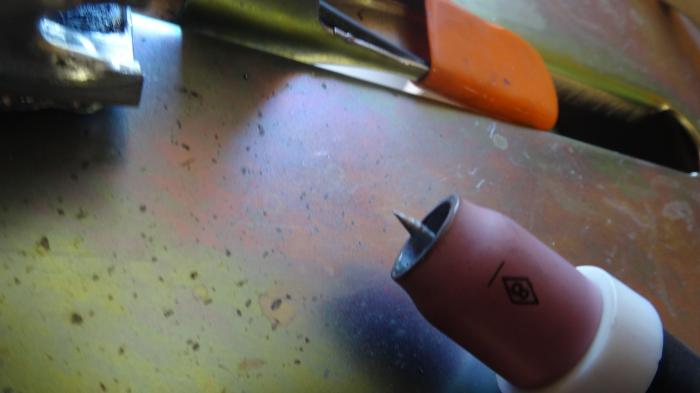

- That's my stick out and taper for the tungsten. Look about where I should be?

You need WAY more amps for 1/2" steel than what you are using thats why your weld is so cold. You want to form a puddle instantly and later on when you do stainless and thicker aluminum, you will know why. Remember Jody's rule...1 amp for every 1/1000th. Up to .125 the rule works pretty good and after that it is just a guideline. You should be using around 250 amps for 1/2" steel. I do that thickness with less amps but I bevel the metal and do a root and hot pass. You really need alot of amps for aluminum as it conducts heat so fast. Also I assume you are using 3/32" tungsten? 250 amps is way too much amps for that size electrode. You would be better using 1/8". Get thinner steel if you can and follow the rule. I usually go 10 or 15 amps above the rule and just use the pedal to control the amps. try to stay with smaller amperages and get used to feathering the pedal before you move onto thick stuff.
You will be a true tigger before you know it. One day it will just click and then you will be all cocky and shit

You called the 3/32 tungsten nailer! I bumped it to 150 for the steel and it doesn't look as pretty, very dull. I do have thinner steel. My local metal shop, AZ metals sells variety packs for $20 for the curious welder in mind. They even divvy them out in a way that suits your n00b needs such as more round stock over flat/square stock but still give you a mix of both. So I do have a variety of pieces to work with, I just got comfy with the 1/2 stock from when I started stickin. Lots of "stick"in.... I'm thinkin I got more than enough Amps because if I hold too long say from the hose getting caught up or me suckin at feeding, I burn through. I also noticed I have 14/16 gauge aluminum not 1/8 so I'm certain the Amps won't be at 250 but that's my fault for telling a bad story.
Feathering gave me some interesting results and perked a lot of ideas. I've got sewing experience so the pedal makes some sense with controlling the arc. I think my tungsten grind angles is still playing the biggest part in my quality of welds beyond operator control. I never thought it'd be so important but I'm thinking of all things to be concerned about, the grinding might be the most important. Am I wrong?

Is the stickout and grind angle I posted before about what I'd want with an inverter and running 1/2 or less steel/aluminum? I've had a variety of qualities in my welds but haven't had enough experience to observe what's been working and what hasn't.

So my real questions I have left with any criticism someone's willing to dish out.....
Is there a theory behind ambient temperature such as 106 degrees Fahrenheit being cause to adjust say 10- Amps? That's a random figure but I think a reasonable guess...????
With my progression, from a professional stand point would I be capable of making an aluminum fire prop that can handle kerosene/white gas flames and be functionally stable? Or do I have a long ripply road ahead before I could even think of that?
Lastly, I posted a pic from my Everlast manual regarding tungsten grinding. From the n00b to the n00bs that might be reading this, I think this is very important and Everlast did a wonderful job of explaining the procedure.
- Everlast Manual excerpt regarding tungsten grinding Do's n Don'ts. I really gotta say this Everlast manual has been very educational. RTFM!

- More of step, feather n pause n feed but on larger piece. More dips than I've done before...
- DSC03662.JPG (39.9 KiB) Viewed 1173 times
- Day 3 1.5 hours. Testing step, pause n feed n feather pedal, then rinse n repeat.
- DSC03660.JPG (30.51 KiB) Viewed 1173 times

What are your welding parameters? What type of tungsten are you using? The grind of your tungsten is important but not as much as torch angle and arc length etc...There are several things that all need to mesh to get a good weld. Jody has an excellent video about the 3 most common things that people do wrong when tig welding. I am too lazy to post the link because I want you to research his videos and watch them all.
IMHO...and I think others would agree, you should not be attempting do weld aluminum at this stage in your learning. Aluminum isn't hard to weld it is just different because when things go bad on aluminum, they go bad really quick so I recommend staying with thinner steel for right now so that you get your muscle memory and timing and pedal control and all the other things you need to be good at to turn out good welds. Don't try to run before you can walk, so to speak.
You can see in the last pic how the metal has just melted away. That is because the heat has nowhere to go and builds up and the metal just drops out. You need to be good on the pedal to weld aluminum and that is a skill that takes some time to develope.
None of us here invented tig welding and none of us were born with the natural ability to tig weld...ALL of us had to learn and advancing in the learning process requires progressive steps from beginning to mastery.
Ok...now that I beat you up a little bit ..get some thin steel and start there. Don't go for the big amps yet because big amps means more heat you are pouring into your base metal and more things will go wrong. First we crawl, then we walk.
Like most, you want to get good at welding and that is commendable but it just takes time and if you afford yourself that time you will progress faster than if you keep having to unlearn mistakes. All the bells and whistles on todays machines will NEVER replace the basic skills that the "torch nut"(the weldor) has to acquire to be competent at his craft.

Thanks guys! I promise I've got at least 30+ hours of pure Youtube time not including all the research. If there's a video about basics, common mistakes, how to, beginners, aluminum, steel, stainless steel, I've watched it from Jody and the other guys out there which I've watched several times over and will still continue to watch even after I think I got it right Oh yeah Jody's Aluminum welding drill is probably the best yet, straight to the point, and I've watched that at least 5 or 6 times too! I've got tons of notes I've taken so I've got about at least 2 straight weeks of total time before I ever turned the machine on. I'm good at research and I'm far from done
I think it's all the research and the little play time I've had that's helped me read my welds. I've certainly gained from ya'lls replies here too.
So for the thickness, the aluminum is actually 16 gauge once I measured it finally. The filler rod I'm using is all 3/32 4043 for Aluminum and ER70S2 for the mild steel. The amps were 100 for aluminum with about 1/2 to full pedal depending on what I was practicing and what I was feeling out. Same story for steel except 120 Amps for that almost 1/2" thick piece.
I can actually say that hole in the latest were actually from the first rounds I did when I was destroying everything. I just keep using the same piece and try to work around that hole till I feel I'm ready to try filling in that hole with a copper backing plate. The last welding run in those pics had no burn throughs and the edges that were melted were almost all from the original runs but I think I had a couple points where I toasted the edges up a bit with that real small piece. So there really was improvement! I'm seeing the benefit of cleaning the part up after a bunch of bad runs too but that was part of what I wanted to see would happen.
I'm really liking doing the work on steel. I've got a license plate the MVD tells me I must destroy which I think is stainless steel...Maybe? I'm gonna clean that off and destroy it for them. Hopefully it's stainless but I guess I'll find out when I start adding filler.
When I grinded the tungsten with the bottom of the arbor like what the Everlast manual says not to do, I had the worst arc control with the arc all over the place and all I got was the radiation burns. Once I grinded it right, I haven't changed much and I've at least melted metal rather than burn the crap out of it all over the place.
As for all those fancy bells n whistles... I'm afraid to touch them for now. Tempted to turn on that pulse just to prove a point of pedal control to myself but I refuse for now. I'm liking the 100% manual process which is just how I generally like to do most work as is.
I'll definitely practice more with the steel since I agree I'm finding more simplicty and consistency when trying to learn things. I've also learned it's really important to let things cool down a bit before I keep doing runs, otherwise I'd say the part is getting too hot and since I'm keeping the same Amps, I'm just tearin stuff up or easily dumping too much filler in to keep that bead a bead. When I first start and have a good pause between runs, I'm finding things to be more consistent until I get hasty then everything shows I was hasty.
I think I'm gettin the hang of it but still have a long way to go and at this point need some fresh pieces of metal to work with but I'll still keep stacking the beads on these pieces as I clean them up too
