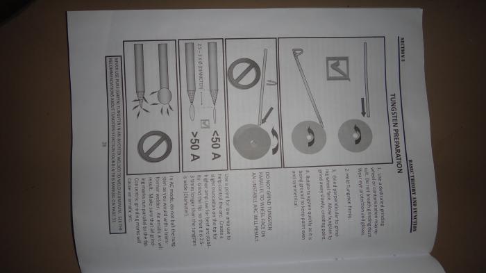

I'm a n00b with zero skill but I did learn a bit about the tungsten grind being very critical for any decent arc control especially on AC. When I first started grinding I used the bottom of the arbor and had very inconsistent grind patterns, even some flat spots. When running on AC my arc seemed to spend most of it's time arc'ing to the cup rather than the plate unless I really mashed the pedal that it was like 25% of the time I had arc to the plate. I had basically what looked like radiation burns all over my aluminum and the cup looked horrible amongst a balled tip, and some nasty crap all over the inside of the gas lens, cup, and tungsten.
I RTFM'd and it said I was grinding with the wrong side of the arbor. I should be using the top. I haven't changed any parameters on my machine but since I started grinding using this method I have generally had a decent arc. I still gotta figure out the taper and I'm using a fine point despite their suggestion of a slightly nubbed end for 50+ Amps, but I've actually been able to melt metal and even got some half way decent runs. My tip doesn't ball either so if I've learnd'ed enough properly, I think it's fair to say I'm doing ok otherwise I'd be ballin. Still much to learn but this bit in the manual seemed to be the most important thing for me to even get started.
Again, still a n00b with zero skill but I've been switching between aluminum and steel with a re-grind almost always. Honestly if the tip looked good and I didn't regrind before swapping material, I didn't notice too much issue. As long as I gently grinded off any crap that got on the tungsten from dipping in the aluminum and kept a decent point with what looks like fresh tungsten (even after a few runs) not scaly tungsten, things generally seemed to work out ok beyond what the operator is capable of. It didn't even seem to contaminate the work much but don't take my word on that. The only real contamination I've noticed that surfaces is almost always because I'm not really cleaning my part much as I keep practicing. Seems helpful because I'm seeing the differences between dipping the tip vs. bad cleaning practices. My observations tell me the pepper crap that surfaces is bad cleaning, and the white halo turned to black is always from dipping.
The rest of these experts will give you way better advice but for the n00b having a lot of this fresh in mind I thought this might be helpful too
- Everlast Manual for Tungsten Grinding

Ah I see. No, the fine scratches the scotchbrite leaves are much much finer than those left by an aluminum oxide grinding wheel. A fine-grit diamond wheel likely does much better of course. I will say though, after scotchbrite'ing myself, it's much too time consuming to get acceptable results in a short amount of time. That is why I resorted to power tools. Takes but a few seconds.maker of things wrote:snapping off is what I have been doing after co-mingling aluminum and tungsten. Sometimes I just get some of the oxide on the tungsten all the way up to the cup and it never occurred to me to try just scouring it off until I thought I saw Jody do it in a video.Rick_H wrote: If your getting a bunch or contamination on the tungsten it is best to snap or cut it off and regrind. If you use a grinder or grinding wheel and grind off the blob you are just impregnating the stone which in turn will put it back on your tungsten when you sharpen
Oscar, I am aware of the potential issues with grinding around the rotational axis so I always grind properly, was wondering if the fine scratches the scotchbrite leaves would do the same thing. Based on the responses so far I'm going to go out on a limb a state that I must have misinterpreted what I saw or thought I saw in the video.
