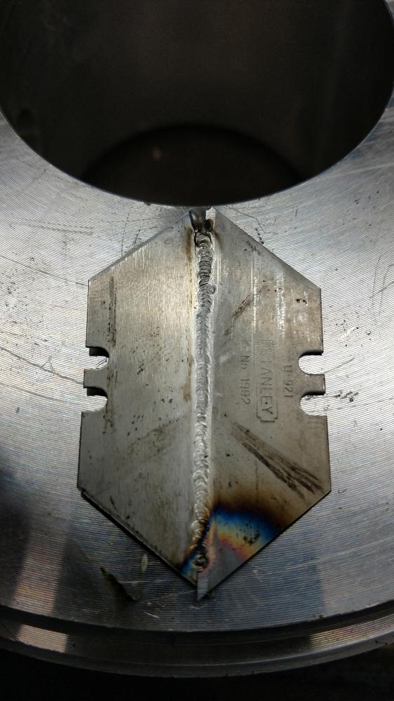

HTP 221 set on 14 amps with .040 2% lanthinated. #20 flex head torch with a gas lens and #8 cup. 18-20 cfh. Blades leaning on each other. No filler. Lost a little bit of shielding near the end , probably could have compensated with torch angle.
- 20160813_211201.jpg (28.78 KiB) Viewed 3570 times
Hey...thats cheating

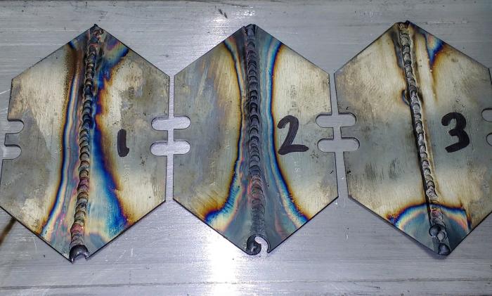

1/16" tung, jumbo lens, .030" filler l used blades out of our disposal bin lol not sure on amps, used my foot pedal

I'll put my attempt here too. 15 amps .040 2% lanth gas kens #8. .035 mig wire filler. #6 shade. I'm going to need to devise a stand or something to get the work area a bit higher. Maybe it's just inexperience at really low amps combined with middle age, but I had a heck of a time seeing the work area. Feel like I need to get my face right in there to see the puddle.
