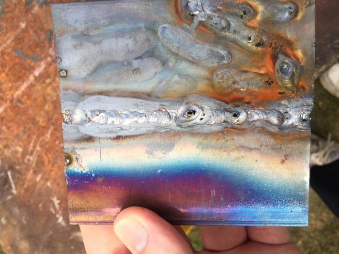

I tried to use my new AHP Alpha tig today and yesterday. No luck. But, I've never tig welded. So, I expected as much. So, this is what I am trying to use.

I hold the thing over the metal and nothing happens. I mean, I can not get a puddle to start. Once, it burnt a hole through the metal. haha
I realized the metal I am using, is not 1/8. That is what I planned on learning with. I got a 1/8 piece of aluminum. BUT, I thought I would try on metal, to not waste that aluminum piece. But, after thinking, I do not think the metal I am using, is thick enough. It is much smaller than 1/8. I mean, I could fit three or four pieces on top of one another, to be as thick as the 1/8 aluminum. Could that be the problem?
Mind you, I know nothing about tig welding. I set the start amps to like 25. I set the main amps to that as well and the ending amps at like 120. I've no clue about AC freq. I set that at different settings. I did the same for the AC balance. For the post flow, I set it at like 15.
So, first, I just have the tip of the tungsten out. I watched a video on youtube and realized it had to be out more. It is now. I can see the light and I hold it right over the metal. SOMETIMES, I do see a puddle. But, then the arc stops. I am not trying to put the other rod of stuff into the puddle. I am simply trying to get used to starting a puddle and continuing it for a bit. My neighbor was there one. He told me to try the tig rod. I did. It left like, a ball in the other puddle. That seems to me, to mean that the temp was not high enough. Am I wrong? I am going to just say screw it, and try the aluminum tomorrow.
Also, I turn the gas all the way up. There is a nob on the gas thing, I pressed the foot pedal and the ball went all the way to the top. I turned that nob down and the ball was at 20. Then, I tried to tig. It is odd to me. What would cause me to not be able to get a puddle going? I hold the thing right over the metal. Not a thing happens. I have the AHP, hooked to a Bobcat 250. It should be noted, until I make the thing that I need, the AHP is plugged in with the adapter, which cuts the amps down to 100 something. But, should I not still be able to get something going, on 1/8 aluminum or less than 1/8 steel?

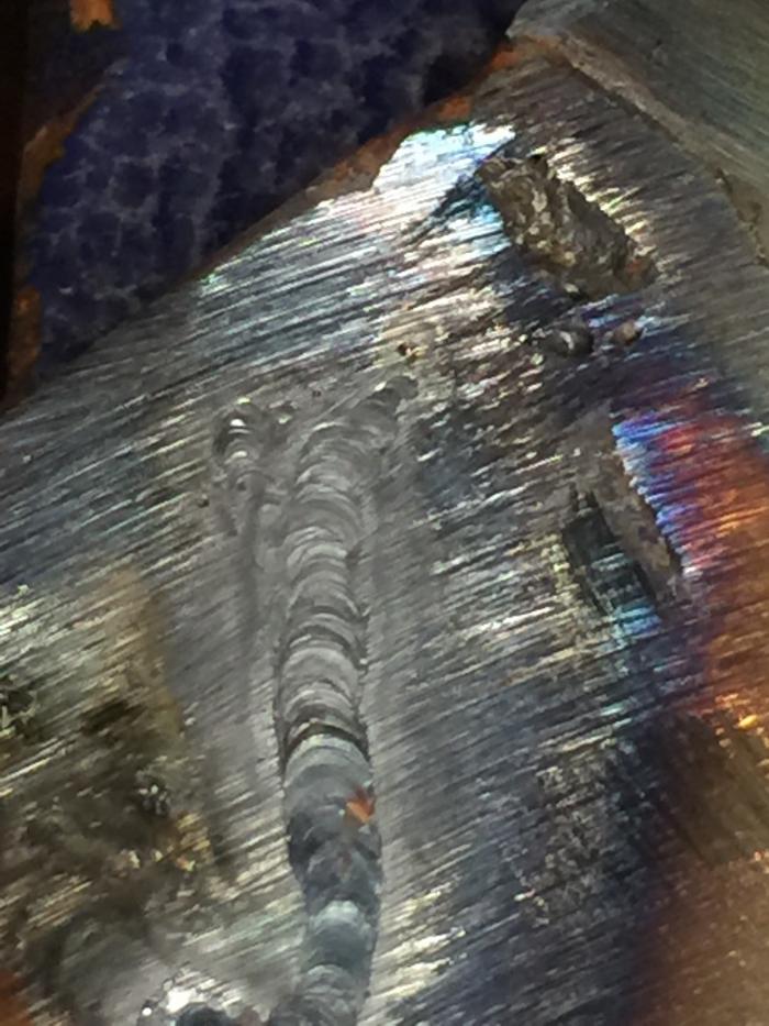

As you can see, haha, no luck. It went well at first. Then, I went in and ate dinner and not a thing worked.
I thought I had dust in my glasses and or helmet. I took them off, only to realize that it was almost dark out.
When I went back out, I could not get a puddle at all. I was standing up. Then, I sat and my gun kept falling on my table, thus ruining the thing inside of it. I went through like 5 of those things.
I am not ging to do it tomorrow. It is supposed to rain.

you have massive amounts of atmospheric contamination and/or you are trying to weld with a contaminated or improperly prepped tungsten.
Also, do not "sand" metal until it's shiny. GRIND it until it's shiny.
Watch every single video on the welding tips and tricks channel on you tube. Even if it's MIG or tig welding. By the time you're done, you'll know what to do. If you dont, then you need serious help, lol.
Btw, I hope you can see the arc and the puddle separately through a good lens. Can you see the puddle similar to this:

It should be like the second one. Make sure your lens is new, scratch free, and your eyes are within 8-12" of the arc. Don't even worry about joining two pieces of steel or aluminum together right now. You need to learn how the tig welding process works and how your machine works. You literally need to start from square 1.

Ok, that is helpful stuff. It is odd. I sharpened all my things with a grinder I got from Harbor Freight. Nothing has even been on the grinder before. I could tell something was up. The arc never looks straight. It is like, all over the place.
I know I should not have tired two pieces. But, they were there. haha
I just wrote this on word. I will post it here.
Alright, in sleepy mode. I don’t feel like watching a bunch of welding stuff, until midnight tonight. I have a movie and Simpsons to watch. Haha
Two things I wanted to say about the tig welding thing. I noticed them and thought they may be important. Would the post flow being too high, make either of these happen?
First, when I take my foot off of the pedal, that comes with the AHP Alpha tig, the weld does not stop. I mean, I held the thing there for a while, until I just had to pull it away. Should it not have stopped? Maybe the post flow is too high? MAYBE, the starting amps are up too much?
Then, when I bled the line, (if that is what it is called) to get the extra argon out of the line, I had to hit the foot pedal, like 4 – 6 times, before the ball would not go up to 15 or 20. Why would that happen? Is it normal for that much argon to be in the line?

Too much post flow time will never hurt. Too much post flow pressure will. I've been getting away with 8CFH with aluminum, steel, and stainless without much issue but I am using a gas lens. I even had a normal setup and had no problems but I think atmospheric conditions can have an effect. Basically 8-15 CFH is usually perfect. I've heard 20 is getting close to bein too high unless you have like a #10 or bigger cup. I'm gonna guess that if you can feel a breeze of gas coming out, it's too much. If you can feel a gentle blow then you're probably fine. Don't point it at your face to feel it
As for clipping your tungsten, I personally would not do it but if you're a perfectionist and/or want to remove any possibility of contamination playing a role, clip it. If you're moving up to food grade welding or doing welds that will have someone's life in the balance then clip every time. This is an experience/personal preference thing to me
Now if your machine continues to run the arc after releasing the pedal then you've got a pedal problem. If your gas just continues to run then that's post flow and all is well. Seriously though, if your arc continues after releasing the pedal, do not weld anymore until you get that replaced. Your home, possessions, (family?), and life are more important than practice and that is not something to wing it with. If it's a new welder with a warranty, get it replaced. If there's no warranty then I'd say now is a wonderful time to get your self a fancy SSC pedal. You can contact SSC and tell them your machine and build year and they'll likely have the correct pin out and connector. I'm VERY pleased with my new SSC and have yet to read a single complaint about them.

i do not know what the features and setting are on a alpha welder
are but one day i inadvertently hit the 4t button on my hpt 221
(torch switch setting) while using a foot pedal. the arc continued
to stay lit after releasing the pedal. food for thought.

I'm betting this, they say NOT to use the 4t setting with the foot pedal, which means it is likely possible tomotox wrote:i do not know what the features and setting are on a alpha welder

have 4t active with the pedal, even though it shouldnt be.
Glow-
If I read your post right, sounds like you might be welding outside?
Do not do that, the wind will carry off the argon and mess with you big time

Cool, well, it has a 5 year warranty. But, I had no luck when I first ordered from AHP. That is why I canceled and got it from Amazon. Not at all worth returning for the pedal. I found a place that had one for the 2015 and 2016 version for like, $175. I will just get that. They also have a tig torch stand that I think would be rather useful.

Oh, I just read the no outside thing. haha I have no choice. I can not weld in the shed thing I have. It is to small. There was no wind yesterday. But, it was cloudy. Also, I believe I had the machine set to 4t.

I just read something else. Wow, I am sloooow today. I believe I have the thing set to 4t. LOL All good stuff. I shall fix. It is raining now. It's good. I have to exercise. Plus, I have 10 minutes left from yesterday, that I did for my brothers wedding and and 44 minutes extra to do for Friday when the rehearsal is. haha I like having things done. I am weird that way.

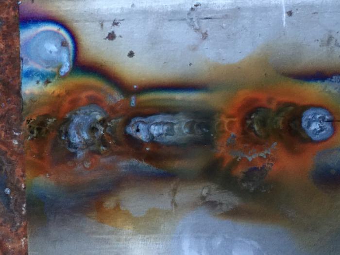

Yeah if you have it at 4T you will have all sorts of problems. Since it was on, I'd assume your welder and pedal are probably fine, just an operator/settings issue. Don't feel bad everyone was guilty for at least one bad setting in their TIG life
If you haven't spent an evening reading every page in your manual, now would be a great time too
I know with my Everlast even on 2T/Pedal I must set the up/down slope to 0 otherwise you get weird behavior when using the pedal. If not using the pedal then you'll have the bonus of having the up/down slopes but you probably wanna figure out what you find works for you in regards to Amps and travel speed then you can start playin with all those fancy features.
If you're stuck outside, then you might consider a 10x10 gazebo. Walmart has the Coleman one which I've had for about 8 years and it works great. Harbor Freight has one too and with those 20% off coupons, it could make it worth while. You CAN set it up with a single person but it takes a bit and you have to walk around and move one leg out just a bit at a time or you'll twist the frame. It cost me about $80 and I bought the Coleman side walls for about $15 for each wall. You can just but tarps for the sides which will be cheaper but you don't get the fancy clips but it's not a big deal. Alternatively you can put yourself against a wall and wall yourself off with a creative tarp setup.
If you ever see rust on steel, yellow on aluminum, or black sugar on stainless steel appear immediately when you start TIG'in you've got gas issues and if you have the bottle on, Argon in the bottle, and at least 8CFH, then chances are it's ambient air flow, not a machine/bottle flow issue. I have my cheapo box fan running sometimes down below my table and haven't had an issue but I'm pretty sure if I aimed it up, things would not go well but I'm also in a garage. When you're outside there is always air movement even if there is "no wind". That's just how our Earth works

Yea long story short you have it on 4T and not 2T. That's why watching videos will undoubtedly get you on the right track the quickest. But you will also pick up so much more, you will learn what other settings do, which you need to know before you just randomly and blindly start turning knobs. You'd be making it that much more difficult for us to help if you if you don't know what you did, because you won't know or will be mixed up with the terminology that you could have straightened out before-hand.
Rip the knobs off the thing and set your amperage, cfh , AC or DC, tungsten size and weld. Skip the bells and whistles...permanently if you can.

Yes, I don't care about all the stuff right now. However, I do need to know what to set the stuff on. I suppose that is trial and error. I ordered a book today. It was a penny. haha Gas Tungsten Arc Welding Handbook. So, I will see what I learn from that.
So, these are pictures of what I tried today. It seems like I did get something going. BUT, should the puddles not be larger than this? LOL I have the size 5 thing on the gun. If I changed that, would it make a difference, or is it a setting on the machine that would?
