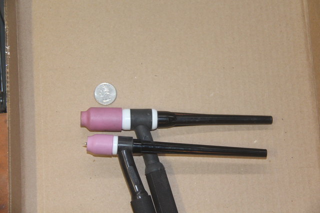

Hi,
I've got a WP17 and a CK20. The CK 20 is physically smaller.
WP17 is towards the top of the picture and the CK20 is towards the bottom of the picture
WP17 is closer to the quarter.
I got SuperFlex cables with the CK20 and it's a great setup.

That doesn't sound right, the 20 should not be larger than the 17. My CK 20 is a hair larger than the Weldcraft 9 (the middle rubber cylinder is a tiny bit larger in diameter, I guess to accommodate the waterflow, but it also seems to be coated in nicer, thicker rubber so might just be that).AR15DCM wrote:Other than appearing slightly larger than the 17, the 20 is water cooled
The only reason to use the 17 is if you need the portability of using the welder without a cooler. Now that I have a cooler it will require having my nuts in a vice and my family at gun point for me to give up the 20.
It's not clear from your question, but you shouldn't use the water cooled torch at all without the cooler running. Using a water cooled torch is so much more comfortable, even at modest current settings, that you will never go back once you use one. You don't have to worry about how close to the head you hold the torch, you won't have to put it down before you're finished, you can wear a lighter glove, and you won't need as much postflow to cool the tungsten. Having said all that, at home I only have an air cooled 17 torch because I don't want to buy a cooler, and I need to be able to take my setup out into the barn or field easily.AR15DCM wrote: Two different torches cam with my welder, a 17 air cooled and a 20 water cooled. Other than appearing slightly larger than the 17, the 20 is water cooled but is there any other advantage working with either torch?

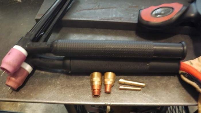

Is it just me or do both torches in the comparison photo appear to have gas lens's fitted with incorrect insulators ?
how can you see it from where you're at without a picture?cj737 wrote:except the torch is clearly labeled as a 20.Oscar wrote:He probably has an 18, and thinks it's a 20.
Somewhat correct. The 17 does not have the correct insulator. The 20 seems to have the correct insulator, albeit it looks "off" because it has a slightly larger diameter than the cup.noddybrian wrote:Is it just me or do both torches in the comparison photo appear to have gas lens's fitted with incorrect insulators ?

Sorry for sidetracking AR15DCM, once you get a real good look at them, I think that will settle it all.AR15DCM wrote:Hi,
Actually the 17 torch I have is like a CK with a Roto head torch and superflex hose. I have not even taken them out of the packaging yet LOL... well just enough to look at them a little bit anyway. I figure that until I get a argon gas tank there is no use really. But I will get them out tomorrow or Wednesday to take some pics. It has been too cold to get out in the garage and mess with it.

I got them out this morning and took at a look at them. Both are the same size with the exception of the handle where the water line runs through it making it slight larger in diameter. But the end of the torches where the gas lense, alumina cups screw in are the same size.Oscar wrote:Sorry for sidetracking AR15DCM, once you get a real good look at them, I think that will settle it all.AR15DCM wrote:Hi,
