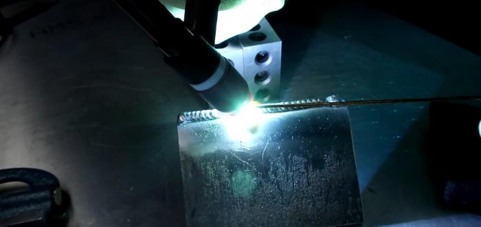

In a recent thread it was suggested to use silicon bronze to repair a pin hole in aluminum, so I thought I give a try to see what happens. I welded two 1/8" Al flats, drilled a hole and went for it.
Making the silbrz weld, notice green tint
AL_SilBrz 2.jpg (20.49 KiB) Viewed 3523 times
completed repair
completed repair

Since the aluminum melts at a lower temp that should be expected-silicon bronze and aluminum mixing kind of like steel and aluminum it isn't gonna work to well. I feel bad you had to ruin such a nice bead.
That is some nasty aluminum you have there though.

I tried yesterday too since I had it out. But tried on DC and it just wandered and rolled it up

5th Street Fab wrote:I tried yesterday too since I had it out. But tried on DC and it just wandered and rolled it up
I did use Dc for the Silbrz weld

Hmm just looked really dull figured it was ac, I might try that and see if anything different happens
