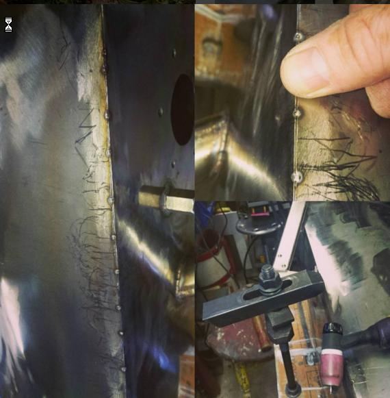

I am setting up a custom computer case for myself and I wanted to do something special. I am using 16 gauge stainless 304 as the two side panels and the front. The welds were going to be part of the artwork on the case however I have run into a bit of an issue. I made a few test pieces to weld so I could hammer down exactly the look I wanted for the outside corner joints but everything I have tried at this point always comes out with a dull grey finish. My goal was to have the dis-coloration in the weld part of the overall look. I have tried multiple travel speeds, higher and lower amps, pulse, changes in gas flow, different size tungsten and adding filler or autogenous welds. Nothing has given me the right look and I am out of ideas. I will include pictures of what my goal was as well as the current look of the welds. All of the welds I have done so far will still look good after wire brushing, but that was not my intention.

Sorry, Amperage 50-70, tungsten 1/16 and 3/32, #7 gas lens and 10-20 cfhwasted welder wrote:what amperage are you set at and what size tungsten and cup are you using?
If it's dull grey and you want it shiny then you are getting it too hot. You can try turning up your amps and moving faster. That sounds contradictory but it works on SS. If that's not an option then you need to make shorter welds say about 1 inch long and then let the parts cool compleatly between welds.
Try pulse if you have it and you need some chill blocks to draw the heat out of the SS. Some thick aluminum or copper. Also, welding outside corners splits you gas and draws in air so set up some type of dam along your weld line to trap argon. This should all help you with your color.
- 5th Street Fab
Chill blocks help. And fusing with no filler helps a lot too. Make a good fit up and tack every inch with small tacks. Pulse is nice but not necessary. Just tack move to the edge of that puddle and tack again.and continue moving. Stainless warps a lot. Clamp it down. I like to Clamp on each side and place a small piece of metal under the center to precurve it in the opposite direction.
^^^ This is really good advice. Because what you are welding is so thin, you're putting too much heat into it and drawing contamination in from the backside. Your travel speed looks really slow too. Once SS gets hot, don't d!ckbeat, move. If the fit is decent, small filler wire is all you need. I'd even recommend 0.045 wire for these corners. Stuffing the backside with tinfoil will help trap the Argon and prevent "sugaring".exnailpounder wrote:...you need some chill blocks to draw the heat out of the SS.
As soon as you stop welding, scrub the bead with a clean, stainless steel brush. It will polish up your weld very nicely, even if its grey. But pick up your speed would be my strongest advice. I made some SS brackets yesterday in fact from 1/8" and used my Fupa 12 cup, outside corners. First I've used it, and was very pleased with the outcome. Don't know whether it was the "key" but it didn't hurt.

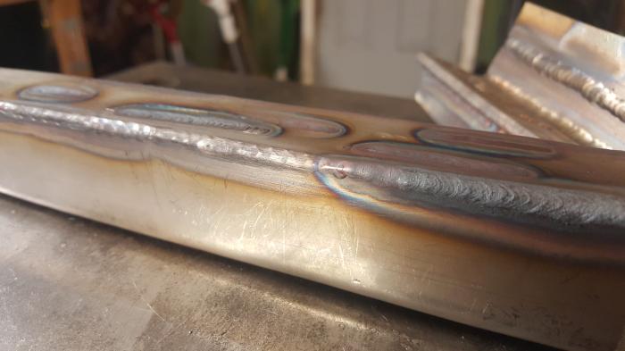

Not getting into the debate but here's 16 gauge SS tacked closely and then fused without filler. Roughly 40-45 amps with a #8 cup and gaslens and 1/16" tungsten. Not moving exceptionally fast. To get more ripple I would experiment with a slow pulse.
No chillblocks were used but purged. Used a light and mirror to check inside and I got full pen. Removed all colors with a SS Dremel brush after

Thank you for the info I think I found my key setup. First I added a makeshift gas dam that makes a valley where I can contain the gas. I haven't been able to fine tune the pulse function to my pace so for now I will just stick to flexing the pedal. That gave me much more heat control and a better looking weld. Then I added a piece of aluminum angle to act as a jig for the stainless sheets and it came out pretty damn well. Next time I get a chance I will add pictures of the test welds. Now as long as I dont F*** up the actual project I think I will be in the clear and pictures will follow.

The color will remain unless you subject the case to extreme temps, or brush it with a stainless brush to remove the coloring and polish it up. Because stainless doesn't oxidize, you don't need to "clear coat" it to preserve it.
The best thing you can do to help yourself get good color along the bead (including your setup changes) is to do short runs. Force yourself to stop and let the pieces cool. The accumulating heat will change the color the longer you weld and the last segment will be much hotter than your beginning.
Do you have any intention to weld the inside corner? Its probably completely unnecessary, but if you do, understand that heat will effect the color of the outside bead. Just stating it in case you were thinking it, and had not considered it.

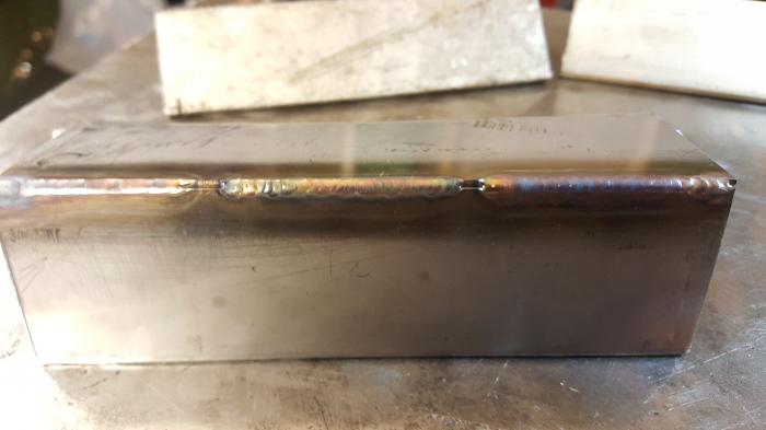

Here are the test pieces I have the the one farthest to the right is just me controlling the foot pedal on an aluminium chill block the middle is the same thing but with gas dams and the furthest one is everything but with pulse ( not set right). Thank you for all the help!

Looking much better! Middle one looks real nice!408cheytac wrote:Here are the test pieces I have the the one farthest to the right is just me controlling the foot pedal on an aluminium chill block the middle is the same thing but with gas dams and the furthest one is everything but with pulse ( not set right). Thank you for all the help!

I apologize for my pissing contest. Here's some pics and settings and techniques I used today that should help for 16 gauge also however you'll need more amperage.
This is all 22 gauge stainless. No backing no chill blocks no purge.
This is the tack move to the edge of the puddle and tack method. With no filler. I make a tack step off the pedal move forward and hit the pedal again, it's an easy way to control heat input.
35 amps maybe? Can't remember anymore.
Pulse at 10 background 10 on time 30ish amps 5-7 seconds pulse and a very fast pace.
This is with 1/16" filler. Same method I used before I tack and add a small amount of filler let off the pedal move forward and tack and add filler again. Very simple and effective just slow.
Tack move tack method
Just remember fit up is key especially with fusion welds.
More of the tack move tack method.
Anyways I apologize and I hope this helps. I'm not posting these for any other reason then to help.
