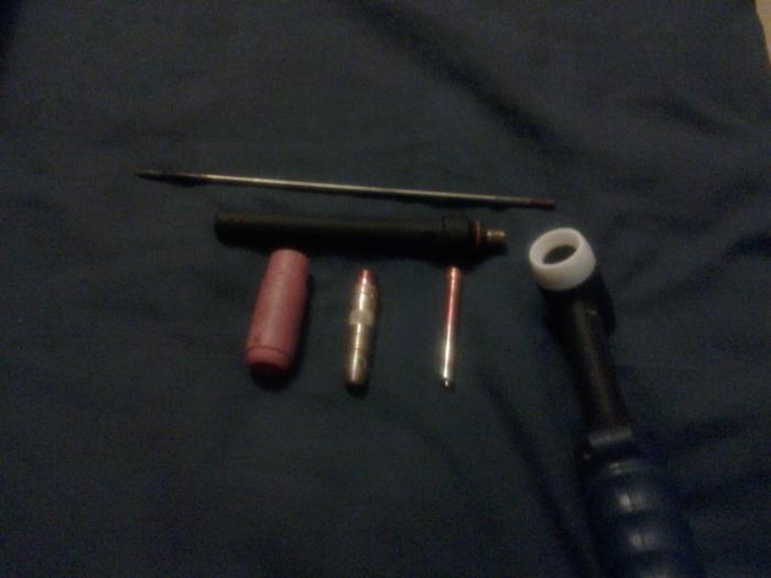

My welder arrived Monday, and I finally got to fool with it tonight. I am trying to assemble the torch. I have a stupid question.
The torch is a size 17, and it came with three collets. The first tungsten I ground was 1/8", so I figured I would assemble the torch with that, using the biggest collet. When I tried to do it, the tungsten fit in the collet fine, but it would not go through the bore of the collet body.
What's going on? I just assumed that three collets with the same OD meant all would work with the same collet body, but I don't think I can get the tungsten through the body without drilling it out.

Chips O'Toole wrote:My welder arrived Monday, and I finally got to fool with it tonight. I am trying to assemble the torch. I have a stupid question.
It could be the wrong sized collet for the tungsten, but you aren't supposed to drill anything. My collets are marked for each size up near the top.
One way to assemble is to remove backing cap/tungsten cover and insert collet, then tungsten, then tighten down the back cap/tungsten cover. On mine (cheap abicore binzel that comes with chinese machines) the back cap tightens and snugs up the collet and tungsten. If the back cap is on it will be hard or impossible to put the collet and/or tungsten in.

Chips O'Toole wrote:The collet fits fine. The collet BODY is too tight.
For any given size tungsten you'll need a collet body and collet for that size, if your 1/8" tungsten is too big (in diameter)for the collet body then the collet body is for a smaller tungsten.

If this makes it easier, (please pardon the multiple posts)
Binzel torch disassembled:
PeteM
    Sat Dec 03, 2016 11:28 am
    Pittsburgh
Step 1: attach this item to front of torch
PeteM
    Pittsburgh
Step 2: Insert collet through rear of torch (hehehe)
PeteM
    Pittsburgh
Step 3: Push tungsten through collet
PeteM
    Pittsburgh
Step 4: Cup of your choice on the front, adjust stick out a little, place back cap on the back. Snug down back cap to tighten up the tungsten so it doesn't get crazy on you.
PeteM
    Pittsburgh
I'd add step 5 and say Weld: and add a picture of some weld prn, but honestly mine just ain't that good.

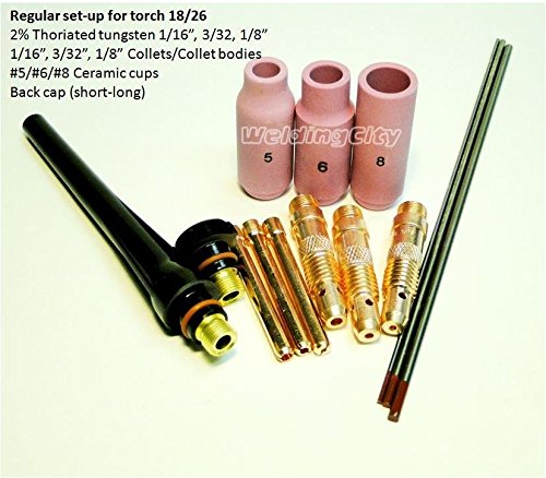

CanMoulder
    Wed Apr 22, 2015 1:02 pm
    Ontario Canada
each size tungsten has a specific collet body size
so if you change the tungsten size you have to change the collet and the body
https://images-na.ssl-images-amazon.com ... nWLQPL.jpg
also the paint on the end of the tungsten can be to large if trying to slide in from the open end
