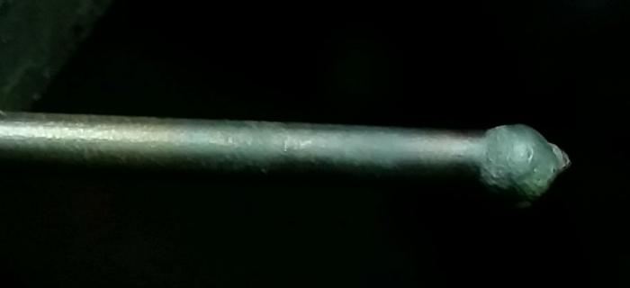

Galvanizing or other coatings usually cause my welds to spontaneously pop and blow metal on my tungsten. If you dipped it your tungsten in aluminum previously and didn't get it all ground out it will cause issues as well.

I am reading up, and I saw some things that looked relevant. One guy said you have to keep the tip of the filler inside the gas area. That was news to me. I was trying to move it away from the torch between dips, to keep the arc from melting it early. Someone else said too much heat causes grey welds.
I am running 163 amps by the display. The rule of thumb says 125, but that didn't seem to be enough. I'm wondering if something is obstructing the current.
The first half-inch of the tungsten always seems to be darkened, no matter what I do. Is that normal? I am posting a photo. The tungsten is balled up, but that didn't happen until I was nearly done. I was tired, and I said, "To hell with it. I am finishing this last inch, balled tungsten or not."
