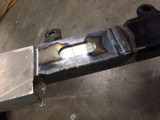

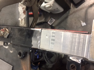

welded 1.png (112.63 KiB) Viewed 2323 times
welded 2.png (112.4 KiB) Viewed 2323 times
welded 3.png (112.08 KiB) Viewed 2323 times
All welded up I wet ahead and did a couple beads over the main weld just to fill in some metal. Not my best looking welds but hey I am a self taught (with Jody's Help) and only for about a year and a half. 120 amps 20cfh gas lens with a number 8 cup. Would there be anything you pros would have done different ?

Not weldporn quality, but you probably will grind most of it off anyway, and they should function just fine.
It looks like you got plenty of penetration.
