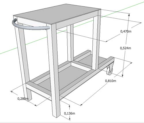

My first project has been putting together a welding trolley for the machine.

Excellent work on the "trolley", by the way. Is the drawing your work?

I made the drawing myself in "SketchUp", Googles free CAD software. Quite easy to learn (at least the basics of it). I just measured the length and width of the machine, then the height I thought would be a comfortable work height, and finally added some space in the back for the gas bottle.
Sketchup automatically displays all the measurements when you click the individual components with the measuring tool. You can display them in inches/feet or in the metric system as we use over here.
