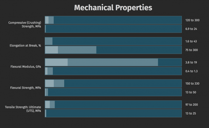

Would anyone know what the material is that the white cup isolators are made of?
Some sort of plastic.

@ Greybeard - both PEEK (polyetheretherkeotone) and PTFE (polytetraflouroethylene) are used as thermoplastic-based isolators for TIG torches.
In the two graphs below, PEEK is the upper bar while PTFE is the lower bar for a given Thermal Property or Mechanical Property.
We've used both materials for large diameter #20 cups....not the isolator, but the actual cup....that we subtractively (i.e. machined via lathe) manufactured as proof-of-concepts for low duty cycle & heat input on Titanium.
Note, both materials have near-identical Solidus (melting) melting temps, while PEEK slays PTFE 3:1 in the heat deflection temp property.

Huge thanks and thanks to all who replied!Arclight Ironworks wrote:@ Greybeard - both PEEK (polyetheretherkeotone) and PTFE (polytetraflouroethylene) are used as thermoplastic-based isolators for TIG torches.
