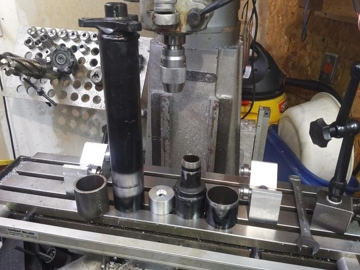

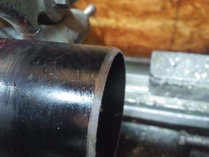

In the near future, I will be joining two 2.5" 095 wall mild tubes with a machined inner sleeve. I've requested it to be a tight hammer/press fit. The end result needs to be as straight as possible.
My plan right now is to fit it up straight, clamp some angle iron in each side, verifying that it's still wobble free. Then hit it with quick tacks on opposite sides, moving the clamps after cooling and continuing to do so around the perimeter, verifying that it's straight, and if it moves, hitting the tack on the "long" side with compressed air.
Then after I have an autogenous root, go over it with filler, with the pulser on about 50/50 in the positioner, maybe even less bg like 20-30, doing maybe a half inch at a time on opposite sides.
Any tips for success would be appreciated! I'm kind of hoping that the tight fitting sleeve and clamps will keep it straight but I've never done it this way before so I'm not sure what to expect.

Not a ridiculous tolerance but as close to no wobble as reasonably possible. It's a driveshaft section. The last one I did turned out well but I did it without a sleeve and I pretty much told the guy it wouldn't be straight but with the angle iron technique it actually turned out quite good, so much so that the owner of the shop that balanced it made a point to tell him that whoever did the shaft did a great job.

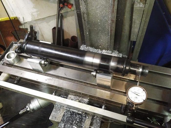

by BigD
