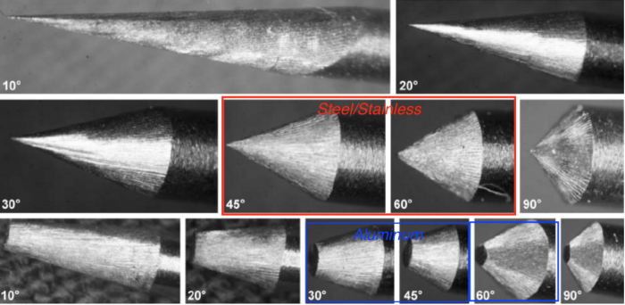

So most of my failures with Al has been due to too deep of penetration. Most of my welds were very wide and made arc control difficult where I'd have to start out real heavy on the pedal then taper off to almost nothing on the pedal for a good consistent weld.
In every situation I've made my tungsten grind to the equiv of the shape of pencil lead after you've finished with a fine point pencil sharpener. Recalling the arc width, it was VERY wide but I just assumed that was normal....
So what I'm gathering here is I've been doing it wrong all along (not the first time).
Recap: Are we saying a tungsten grind that matches a sharpened fine point pencil is bad for Al and instead I need a flattened end? I see the pics and that's exactly what I'm reading, just confirming a n00b's dumb ?

For the majority of cases, you'll optimize the Tungsten's arc stability and cathodic penetration effects by properly preparing and profiling the included angle to subtend ~ 30-45-60deg. An an option, you may slightly blunt the Tungsten's tip. In most cases, blunting the tip prior to welding out Aluminum aids in combating disintegration at the tip that primarily results from evaporation at LTE (local thermal equalibirum) within the plasma column during electron/ionic transfer. Note that blunting, if used for aluminum, should be small/small unlike shown in the image. IMPO. Using a larger diameter Tungsten (ie. 1/8") with REMs (rare-earth metal oxides), the propensity for erosion of the Tungsten {thermionic cathode} is significantly diminished sans a blunt tip. Lastly, there are certain cases where we profile the tip with two separate included angles.entity-unknown wrote:....Recap: Are we saying a tungsten grind that matches a sharpened fine point pencil is bad for Al and instead I need a flattened end?...
The image, captured from the body of literature, represent what we employ 90+ percent of the time for steel/stainless steel and aluminum. Again, with a smaller blunting (if used). We profile based on our application (i.e. joint geometry, position, etc), the type/thickness of the materials to be welded, and the filler selected.
You have to "test and learn" and determine what works for your welding style and your application.
- Tungsten Profiles.png (194.4 KiB) Viewed 2284 times

So thinkin about this a bit more, I want to expand on my question... it really depends on the thickness and penetration. But for a poor man's example, I'd say a fine point for thick, deep penetration, and a fairly flat end for more fine work? Basically exactly opposite of what I'd expect from drawing with a pencil?
Edit 1: And I see ArcLight provided a very detailed explanation after I posted this Reading now.
Edit 2: So after reading the post, I think I actually comprehend what's going on. I'd say I'm a 30 to 45 degree'er usually I honestly have always approached this with the concept of drawing with a pencil but what I should be thinking of is how the surface of the tungsten tip aligns to the welding area.
So if you were all my professors (I pretend you are ) these are the three ?s I'd ask to confirm what I read from ArcLight above:
So the sharper the tip, the less parallel the tip surface where the electrons leave the electrode is to the welding area, then the result is a wider arc which would equate to more heat with less initial penetration, so more heat is required to weld? Kinda like having a really bad arc gap and/or torch angle?
Then without getting too deep into the angles, the more blunt tip will provide more focused arc/heat with deeper penetration per second with the ability to control arc width by controlling the angle of the tip i.e. sharper = wider ?
Lastly, a 90 degree torch angle is more important with a sharper tip than a blunt i.e. the blunt tip gives more room for torch angle with less negative impact to your weld in comparison ? Does this also give flexibility with arc gap?
