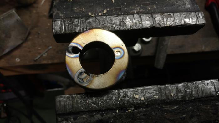

Strange thing today on my welding. I had some stainless door handle covers about 1 1/2" in diameter and 1/32" think. A bit like a thin walled bushing.
I thould it would be a good thing to weld them together to get some practice.
I can't say it went verry well. But i found out that a setting on my welder (Arc force) had influence on my tig welding. I thought (and read it in the manual) that it is a setting for stick welding.
![IMG_20180218_205452747.jpg](./download/file.php?id=14089&sid=3af0fb41eefbcbbdea2c8923dd8b98c9)
- IMG_20180218_205452747.jpg (34.02 KiB) Viewed 4347 times
The two holes are made with a second of arc power with everithing as low as it goes. th (accept arc force) The little dot is made acr force also as low as it gets. This way i can "weld on the 1/32 stainless. With the arc force high it's verry difficult.
Anybody the same experience with there machine? Or is it normal? I placed some pictures of the holes and spot and the machine and manual.

With arc force turned off--what's the result when quickly 'blipping' amp control?

Hmmm...I was under the impression that ARC force was something that was only done for stick.
I'll try adjusting mine, I had it set around 30% when I was tigging yesterday.
My machine is marked 'Stick" on the panel for ARC force. Maybe it depends on the implementation by the manufacture, but I don't think mine is active during tig.
I think it would be bad for tig to have ARC force as it compensates for low voltage when the arc gets short. With tig however, most people control the amperage with the pedal. I'm confused...

My TA 186 automatically bypasses the arc force in tig mode. But other machines I’ve used it did make a difference. Can’t remember what difference it made but I know some machines tell you to leave it turned all the way up or down depending on the manufacturer.

Arc force increases the amps as the arc length decreases. I would just turn it off and control the amps with your foot pedal

I had the same issue when learning to tig, really noticed when I tried aluminum. Arc force also known as "dig" on my machine, can be very useful for stick and mig but it about ruined my day when I was on a project and didn't realize that's where a good majority of my problems came from.

Thanks guys, good to know I'm not the only one with this experience. I'll keep the knob at 0% when I am tigging.

I've tried some aluminum and welding alu just got a hole lot easier! The difference is bet big. I got much more control. No more arc force when I'm tiigging!
