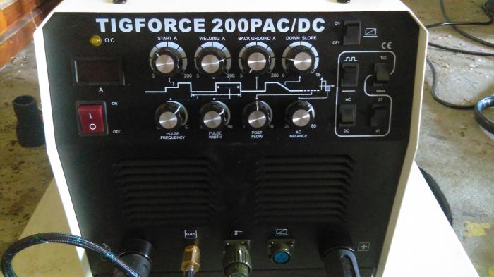

Hey guys thanks heaps for getting back to me. so with the tungsten I'm not sure what size it is as it was not mentioned and came with the machine but it only fits a small copper tip in the torch I will today if possible buy a set of tips so I have everything. I'm welding 3mm plate and 1.5mm square tubing when I do get a stablish arc it melts the tip quite quickly into a ball which from the vids tells me its either too hot from the setting or im getting too close but I cant seem to stop it from happening any thoughts?, I have checked the gas flow its at 20 on the argon gauge and I can feel plenty of gas coming out, one thing I have noticed is I have only two types of ceramic tips for the gas I'm wondering are they both too small and I'm getting insufficient gas coverage? I was using the small one I think its approx 4-5mm and the other is 8-10mm wide. I checked and the torch is plugged into the -ve terminal, the instructions seem clear on this, I will get the wire brush and re-clean the surface. I really don't know how to check for a defective AC? if possible I will try to get a short vid with it starting up and see what u guys think. once again thank you all for the info anything to further the cause is greatly appreciated you guys rock

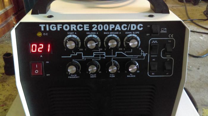

sounds like ac balance is way out.steve42 wrote:.........when I do get a stablish arc it melts the tip quite quickly into a ball ........
the dial is probably the other way around. set it at 30 and try it.
On nearly every Chinesium Tig I seen if there are any markings on the AC balance knob they are meaningless so advise of setting 30% based on quality domestic machines is'nt quite relevant - but it's certainly wrong side of center - rule of thumb on an import set it about 10 oclock - maybe down to 9oclock if metal is really clean - everything else looks OK except if learning I would'nt use 4T as it just complicates things till you have the basics sorted - though the settings shown will work fine - low initial amps so you can establish an arc & get a feel of where the torch is & get a good arc length followed by a decent high setting for the actual weld & a little down slope to taper off - if it were me trying to show someone that never welded I'd leave it on 2T & just set enough main amps to get a puddle fast & control heat with filler & travel speed on a larger test piece - when heat build up gets too much stop & cool metal - once comfortable this way with a good feel for amps required move on to using the foot pedal.

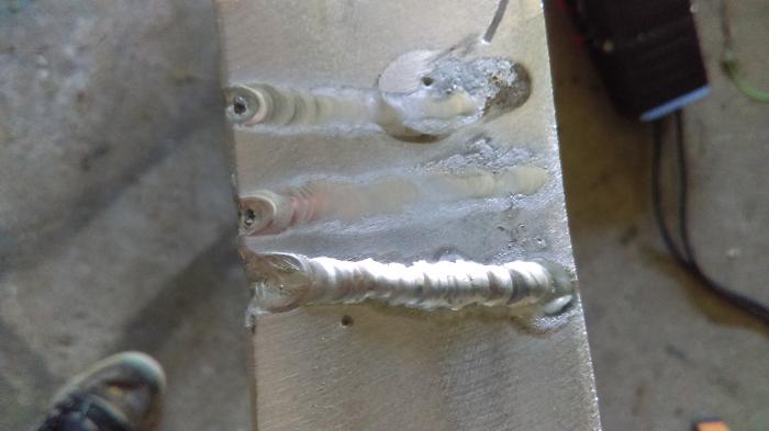

Ok so I switched to the size 8 cup, using lanthanated 2.4mm tungsten, gas at 18, and changed settings to no pulse, and I'm using the foot peddle and eureka !! I think the foot peddle made the biggest difference now just to get the desired cleaning action and we are good. so here is my first ever weld I did two lines with just the torch and they looked pretty clean so I tried with dipping the stick gonna need some practice a big thank you to everyone who commented I definitely would not have figured it out without your help of course all comments are welcome to help better the skill would be greatly appreciated thanks guys
