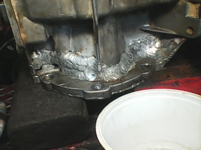

This is the gear box of a jeep , I used 3.2 lanthanated and the notes are like this , the tungsten does not ball when AC cleaning
is low and it splits at the tip.When cleaning is adequate then it balls. any ideas? The amperage was 170 A .
