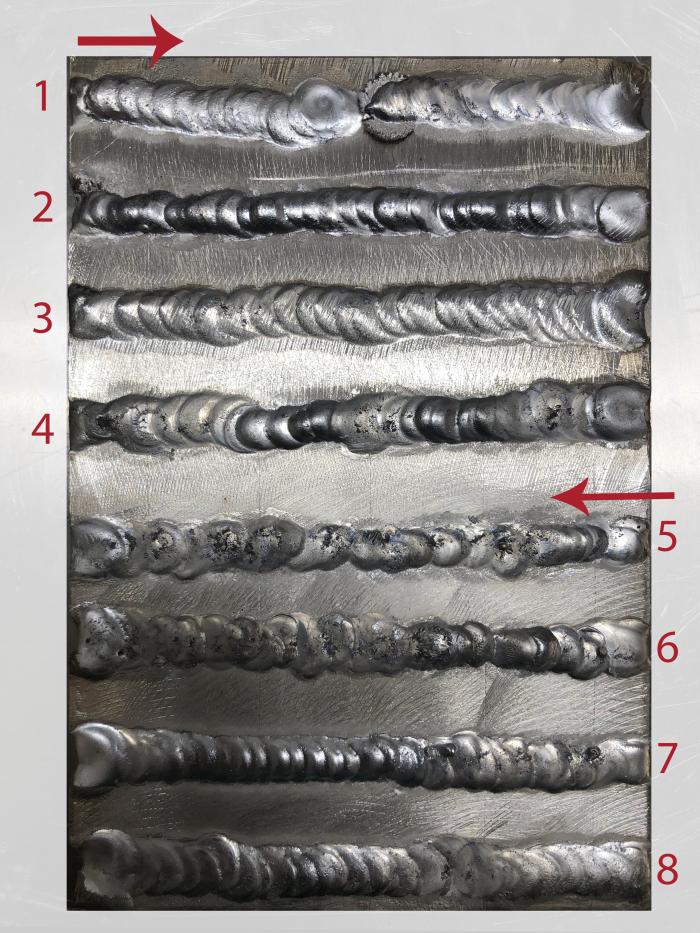

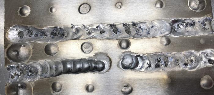

Hello, I am total noob in TIG, having just purchased my first TIG welder and finished a cart. Struggling with laying beads.
Setup:
* HTP Invertig at 150A, frequency 60Hz, balance 75%
* Argon 14cfh
* CK20 water cooled torch, size 7 cup, gas lens, 3/32" lanthanated electrode, stickout 0.31"
* Aluminum 1/8" plate, plastic sheet just removed yesterday, cleaned with Scotchbrite and a dedicated S/S brush.
* 1/16" 4043 filler
Ignore the bumps, this is the backside of a plate on which I practiced puddles laid out in a grid (following 6061.com's method)
[/list]
I could not keep the puddle wide enough (scribed lines are 3/8" apart) and could not feed the filler fast enough. Also the weld has black soot in it.
The second half of the second row is now 3/32" filler, and I feel it was easier to feed, but I still ramped up as I went along:
Then I reduced the current to 130 Amps:
Still looks porous, rough and mixed with black stuff. Any pointers are desperately needed, and greatly appreciated. Thank you!
For 1/8" plate, trying to fill a 3/8" wide gap (scribed line width) you need 1/8" filler. At least 3/32, but 1/8" is more practical. 1/16th is too thin for that amperage and fill width.
Reduce your scribe width to 1/8", use 3/32 filler, and have another go. 150A to start is fine, but you will want to back off that heat pretty soon after you get your bead running along.
The black soot looks to be 2 issues: The first is likely AC Balance is pretty high at 75%. That's not much cleaning action. Drop to 68% and see how it improves. Also, what grade of material is the "shiny new sheet"? Some aluminum is not easily welded and creates really crappy welds. The second likely issue is torch angle/length. Aluminum welding is not very tolerant like DC TIG for having a long arc, and a flat torch angle. Just check your torch is staying in position as you move along, and the arc length is equal to the filler diameter (or very close to it).
I agree. Bump the balance down to 65%, and make sure you have the torch on the negative output. It makes a difference on machines that are not 50/50 balance.cj737 wrote:For 1/8" plate, trying to fill a 3/8" wide gap (scribed line width) you need 1/8" filler. At least 3/32, but 1/8" is more practical. 1/16th is too thin for that amperage and fill width.
The aluminum, as was said, may not be an easily weldable aluminum alloy. It could also be a welable aluminum alloy, that has been anodized. That is not much gooder! Anodization is like a super extra thick oxide layer that does not "brush off" easily. Ever see those blue/red/colored Mag-light flashlights (or similar)? Well those "colors" are anodizations. It would take major brushing to really get all that off (compared to un-anodized aluminum). The problem with clear anodization, is that you can't see it, so if it's there, even if you brush it a little bit, it can still be there.
I also vote for excessive tungsten stickout past the cup, AND too much torch angle. It should be at most 15-20º from the vertical, when welding in the 1G horizontal flat position. Your only goal with 1st time TIG welding aluminum, is to get 1, just 1 clear shiny puddle. Not adding filler, not moving to get a bead going. Just 1 single proper, clean , shiny puddle with a little bit of etching around it. Nothing in your pictures indicates you have obtained this. Of course, when you left off the arc, and the puddle solidifies it will not necessarily be shiny/reflective, but none the less it will be clean with perhaps a hazy gray look to it.

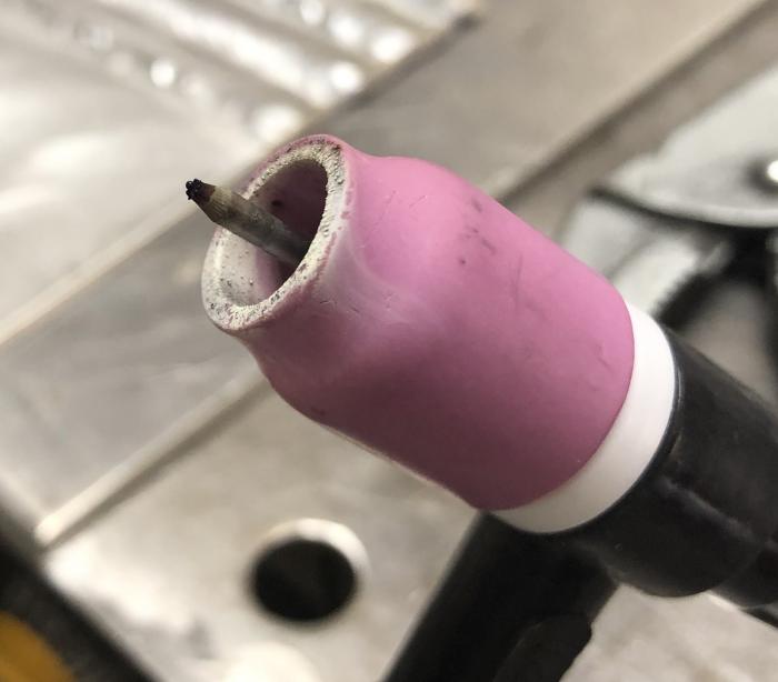

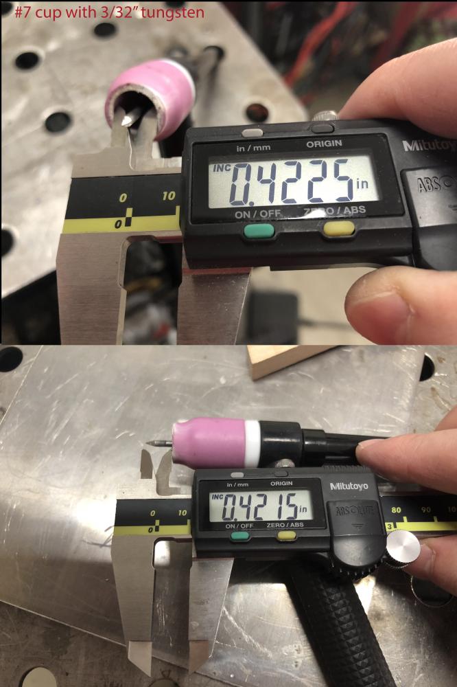

Much better. But I'd like to know where you got the "3x the diameter as stickout" that you mentioned. Tungsten stickout is generally guided by the orifice size of the cup your are using, whether it be a standard gas cup or a gas lens nozzle. Think about it---if you use a 1/8" tungsten (hypothetically), with the "rule" you mentioned, you would need a 3/8" stickout, but what if you're only using a #4 cup?? Then the stickout PLUS the arc length has the edge of the gas nozzle would be a good 1/2" from the weld puddle(!)
. In other words, that scenario simply does not work IMO.
The relative size of the gas nozzle dictates the maximum stickout that can be used. Of course gas lens cups allow for more stickout than regular cups, but generally speaking you don't want to extend the tip of the tungsten more than 1 [regular] up diameter (under perfect conditions and very high operator skill). If you factor in non-steady hand movement/jarring/shaking up and down, then you need to be even more conservative with the stick out.

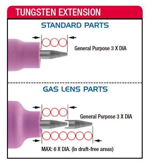

I don't know for sure how to dial the stickout, but the 3x tungsten diameter comes from the CK Worldwide "Technical Specifications for TIG Welding" (http://www.ckworldwide.com/technical_specs.pdf).Oscar wrote:But I'd like to know where you got the "3x the diameter as stickout" that you mentioned.

I see. As was said, what they fail to mention is that the 3x-tungsten-diameter is not what "it is supposed to be", but rather a maximum as a general rule, for an experienced welder under pristine, controlled conditions. By the time you factor in the arc length from the tip of the tungsten to the actual workpiece, it is really stretching it (the gas coverage) out, which when coupled with a shallow torch angle, leads to unfavorable welding conditions. IMO, it is better to govern one's self by the cup/nozzle diameter. Unless it's a gas lens, I tend to prefer:koenbro wrote:I don't know for sure how to dial the stickout, but the 3x tungsten diameter comes from the CK Worldwide "Technical Specifications for TIG Welding" (http://www.ckworldwide.com/technical_specs.pdf).Oscar wrote:But I'd like to know where you got the "3x the diameter as stickout" that you mentioned.
Standard gas nozzle:
- ½ to ¾ of the cup diameter for the tungsten stickout, so that when you factor in the arc length, you're roughly ~1 cup diameter from the edge-of-the-cup to the work piece.
- ½ to 1-½ cup diameters for the tungsten stickout, so when you factor in arc length, you end up no more than about 2 cup diameters from the work piece.

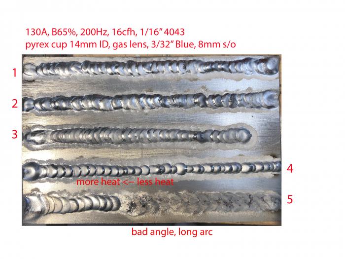

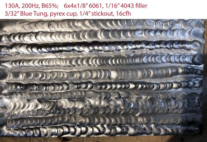

Impressions from Day #3 of TIG
So I continued to practice on 1/8" Aluminum (called my supplier and they said it's 6061). I am cutting 6x4" pieces here is the third from today:
I made a few changes: first, I increased the frequency to 200Hz and it seems the puddle is better (can't explain). Then I switched to a pyrex cup and had a blue Tungsten tip a few times, so increased the gas flow from just below 15 to just above 15 cfh.
Interestingly I only dipped the Tungsten once in the puddle, but touched the filler to the Tungsten countless times.

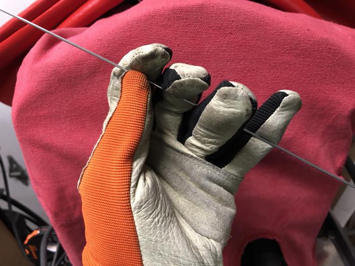

I struggled with several issues at the same time. First, I find feeding the wire consistently to be very difficult; between 3 pairs of gloves, have opted for thin HD mechanics gloves, that are not well shielded from heat. Otherwise I have zero tactile feel. Also finger positioning was hard, so ultimately I came up with this, because I can use the pinky to direct the wire into the puddle:
Second, I am struggling very much with the tempo. I guess experience will help, but in the meantime I bought a metronome (thank you Amazon same day delivery):

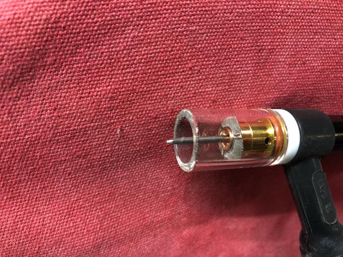

Finally, the pyrex vs the size 7 pink cup seem equivalent to me. Here is the former:
You folks are super helpful, and I learned a lot from the above suggestions. Any other thought is gratefully received.
- day 3.jpg (85.19 KiB) Viewed 3791 times
- feeding position.jpg (66.72 KiB) Viewed 3791 times

It is not a rule. Those are simply the guidelines that I personally use. It's not something that I consciously think about because it is only a small part of the puzzle. With TIG welding, everything plays a part. For example, gas flow also plays a huge part. Joint geometry also plays a huge part. Those distance guidelines are simply what my tungsten stickout ends up falling under, throughout various different welding conditions. TIG welding is like String Theory---there are at least 11 dimensions, no single one of which is solely responsible for the outcome of the final weld bead. When I'm adjusting tungsten stickout it is generally as short as possible, but long enough that I can see the arc at the end of the weld bead depending on the positioning of my head, which of course will vary with the joint geometry and physical positioning of one's own body. This is where doing "dry runs" helps out. Very generally speaking, I always go with the shortest tungsten stickout that I can manage, and still be able to complete the weld run, even if it is with a gas lens. This saves on shielding gas because the shorter the stickout AND arc length, the lower the gas flow you need for proper shielding (because the cup orifice as a whole is closer to the base metal), whether it be a standard cup/nozzle or gas lens nozzle.koenbro wrote:OK I will use this rule and give it a try tomorrow, thanks for the clarification. I have used today the stickout = cup diameter and here is the result:Oscar wrote: for a Gas lens:

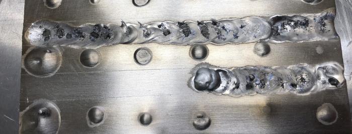

Day 4.
Played again with aluminum, and tried to improve consistency. In the meantime I forgot about proper angle:
But at least I realized immediately what am I doing wrong (or so I think).
Then tried to fine tune the heat:
Finally, tried to jam down on the filler:
Weld #8 is the best I have done so far. Taking a break now, as I've got to go to work today. Will report back with any progress. Thanks for all the help.
