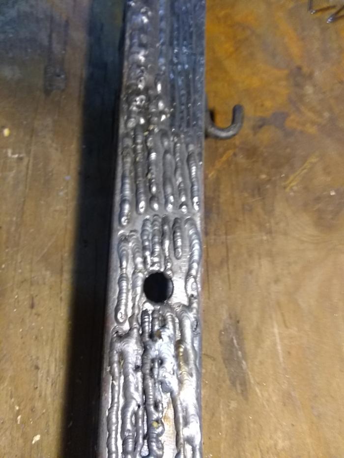

Today welding practice was great. Those tips on watching my tungsten arc color was right on. I concentrated on running beads with no filler . I noticed that if I set my amps exactly where i thought they should be it didnt leave me with any wiggle room, so i turned my amps up around 20 amps more than I need and it made a world of difference. The pedals power curve seems to all be in the last 10 percent , so if I turn my amps up the pedal is more manageable. I dont care for the pedal , its uncomfortable but does the job for now.
I was having some trouble with this square tube from a old ladder stand . It seemed like it wouldnt get a weld pool going , I noticed that it had a orange tint and smoked more than my other metal . The arc was white but it threw orange sparks sometimes.
All in all it was a good practice day.
Are you certain the ladder stand was steel? If so, it might have a galvanized coating on it. If so, DON’T weld it, the fumes from the coating being burnt off will kill you.it might have a zinc coatin, which isn’t great either, nor easy to weld through.
