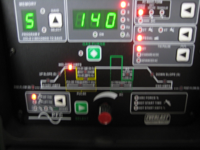

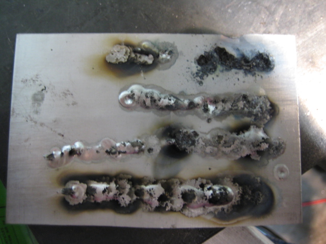

Heh guys, I made it out to the shop even and though the winter head cold is lingering, managed a couple test on 2 , 1/8 plate, 6061 coupons. , previously used and cleaned with stainless brush and further cleaned using 99.9% isopropol alcohol.
I started out at 140 amp ( pic 0012 ) setting on the 210ext, 100 hz , no pulse, 30 cleaning, ramp at 40, At this setting I almost blew a hole and could not form a puddle, it happened very fast. ( see top line on pic 0026..)
I dropped the amps to 100, ramp to 20, almost as bad. plenty of soot, start of a puddle.
I changed test plate, dropped to 80 and was a bit more successful but lots of soot. ( pic 0018 above )
So, I figure my home made, copper wire ground is not working and will have to look at that ,
My tungsten, Red, 3/32 had a ball by the 2nd attempt on plate 1. ( I have ordered blue 2% lanthanated, hope to have next week )
I was using the foot pedal, and last line on pic 18, I managed a bead of sorts..By this time the plate was really hot..
Your thoughts are welcome, thanks for taking the time.
- pic 0012 , settings,

If you're using the pedal you won't need the ramp time. Rely on the pedal for amp control up and down. Also like stated, there is the issue with gas coverage. And if it's aluminum you're welding, make sure you are on A/C with 2% lanthanated (blue) tungsten with a little stick out and keep as close to the material as you can without dipping. Try running a bead without filler a couple times to get used to the process. Have fun with it and practice ... a lot.

Don't shoot yourself in the foot, because all you'll be doing is chasing your tail. For example, you did not disclose that you are using some home made copper wire clamp in your first post. Do things, perhaps not like a professional, but at least how they're supposed to be, because you end up changing so many things you won't be able to figure out what's what, and end up with the inevitable issues. Call HTP and order their gas lens kits. They deal with CK worldwide, so they have good parts. You should call up Everlast to get tech support as they can also help you over the phone so you can properly set your machine and setup as a whole.
Once you get past the basics, you can be well on your way and simply "know" instead of wonder.
My first aluminum beads in the last 3 years or so when I tried out my Invertig 400. No extraneous soot, no ugliness, no non-sense. While your beads may not be straight, or evenly spaced out ripple pattern, your machine should be able to produce clean welds right off the bat.
