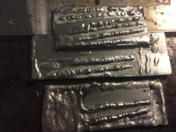

Day 4 with the new welder. Test coupons - 1/8 aluminum, wire-brushed and acetone wiped.
3/32 - 2% Lanth - 3/32 and 1/16 filler wire - mostly between 30 and 50 amps. #8 stubby gas lens - around 14-15 CFM
Primarily focused on cleaning affect, travel speed, feeding filler rod in a timely manner and not burning through the work piece. Burn-through has been a major issue. I adjusted the amperage way down and that seemed to help.
Probably the biggest coup was that all of these were done with the same electrode - which I never dipped and didn't have to re-grind. I didn't ball it at all. Just ground it - wiped it down and started working on the opposite side of the coupons from the day before - which looked a whole lot worse. Toward the end I started picking up some contamination and the tip of the electrode started to get black - but didn't melt or burn away.
Not trying to be the worlds best welder 4 days in - just trying to develop some good habits and discover a technique which works for me.

keep at it.studioq wrote:Day 4 with the new welder. Test coupons - 1/8 aluminum, wire-brushed and acetone wiped.
the reason your burning through is due to overheating the workpiece. need to cool it off before the next weld. handy to have multiple bits so you can weld on one while the others cool off.
unfortunately those welds are cold due to the horridly low amps. i would be adding at least another 100 amps to that.
1/16 filler is to small.
the werid thing is low amps tends to cause the work to overheat. thats because you spend so much more time welding.
keep the amps up high and increase travel speed.

Lengthy post coming:

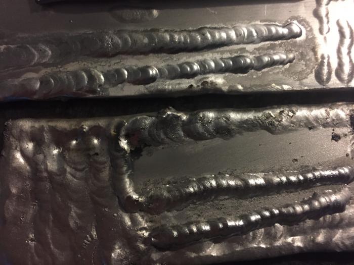

Your test pieces show some "long arcing". That why you have schmootz in some of your beads and not others. Forget trying to learn everything at once. Learn the fundamentals first.
Take a fresh piece of 6" long, 1/8" stock. Scribe a line 3/16" from the edge. Make parallel scribed lines to that, full length, edge-to-edge. Set your machine to 170 amps. Yes, 170. 60 or 120 Hz, 70% on your Balance. Now throw away the filler for the moment.
Understand, the pedal is just like the accelerator in your car. From 0-100% pedal, do it smoothly but deliberately. Not so rapidly you'd break traction leaving a light. But get it there. That will give your a puddle promptly.
With no filler, start at one end, get your puddle and wait until the width of the puddle grows to 3/16" wide. Then advance half the distance of the puddle width. Linger until the puddle grows to the scribe lines, advance, linger, advance linger. When the puddle begins to grow too quickly, ease off the pedal just like you would in traffic (establish and keep your following distance).
Take a pair of pliers, grab the stock, and drop it in a bucket of water to cool it. Retrieve it after a few seconds, wipe it off, and repeat. Do every "lane" with no filler until your puddle width is consistent and your "dimes" are overlapping.
Once you get that down, then it's time to repeat with filler. Get your puddle, add some filler until the puddle grows to the edges, then advance. When you advance, the filler you added should move forward with the torch. If not, add more filler next time before you advance.
This is a very mechanical drill. But it will teach you to watch the puddle, control the pedal, and move your torch consistently. The distance of your tungsten to the puddle should be 1.5x the diameter of your filler rod, no farther. You can get closer, but you'll run the risk of dipping your tungsten. If you do, stop, clean the tungsten, and start over. Don't weld with a fouled tungsten. Bad habit, don't start it.
Aluminum takes a lot more heat to weld. It takes a ton to break through the oxide layer but far less to melt the aluminum once you get going, so you will have to taper off the pedal.

small correction here. we generally don't use heat to break through the oxide layer. you can with helium but thats another conversation. the cleaning action is what we use to break it down.cj737 wrote: Aluminum takes a lot more heat to weld. It takes a ton to break through the oxide layer but far less to melt the aluminum once you get going, so you will have to taper off the pedal.
you need to taper off the pedal as the heat builds up in the work piece. the longer you weld the hotter it gets. you can do short runs without having to back off which is handy for when you don't have a foot pedal.
