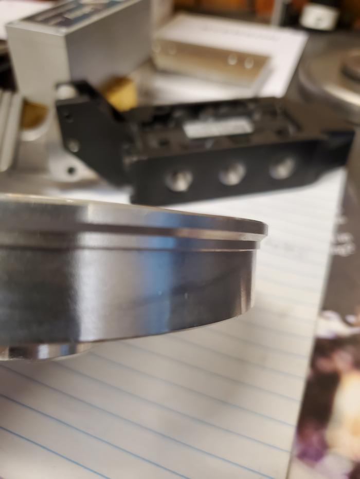

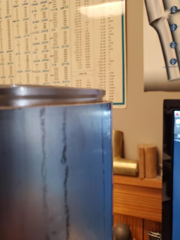

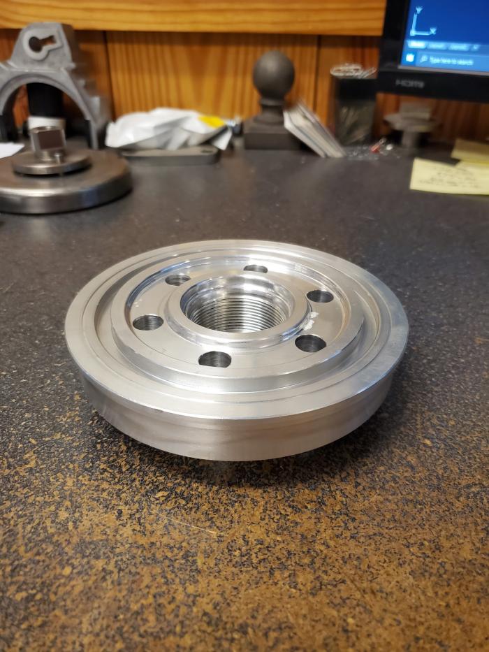

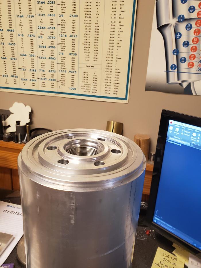

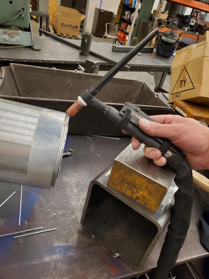

So I have a job here that I am hoping to get some advise on. These are aluminum filter cans, the tubes are appx. 5.563" diameter 1/4" wall with a square cut on the end. The caps,are appx. 13/16" thick and profiled to form a single bevel weld groove.
Im using a miller synchrowave 250,
red 1/8" tungsten balled using DC+
#6 gas lens
100% argon ( can mix in some helium if needed)
4043 filler
positioner
Going to preheat a little, clean it with a stainless wire brush and acetone then do 1 pass to fuse it then without stopping a second pass to add filler. These always come back from testing with leaks, at least 50% of them, whereas the shop our customer was using before us (out of business now) never had any leaks.
I havent tried any yet, I am hoping to get some advise on technique.
How should the torch be aimed at the groove?
Would it help if the can was beveled as well to create a v groove?
Should the tube be laying on its side or standing like in the pics?
Any advise at all is greatly appreciated.

You haven't said the pressure it'll hold. I would do it in one pass with 1/8 or 3/32 4943. Use enough heat to get penetration, dab filler as it sags.

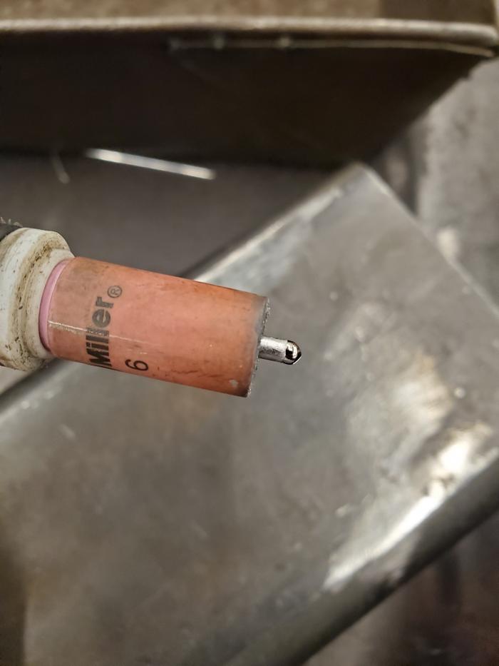

I am just using DC+ to ball the electrode.
Also I just noticed, I am using a standard #6 cup not a gas lens, all of my lenses are 3/32".

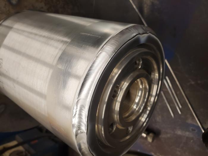

Oscar, yes I can do a root pass. That way seems to be working better for me than 1 pass.
I did 4 this way and they all passed the leak test.
I am trying to keep the torch around 11 to 12 o'clock on the tube and angle slightly towards the tube.

Looks good, but with a balled-tungsten that size, I would be thinking arc-wander might have caused incomplete root fusion. Are you using pure tungsten? I ask because if you can avoid it, you should. 2% lanthanated can hold a blunt end/tiny "ball" much better to get fusion straight "down" the axis/centerline of the tungsten, but only if your welder has the necessary adjustability. Keep in mind I'm just a hobbyist in welding/fabricating, but I do a lot of "testing" and research into welding and arc dynamics, so to speak. The larger the tungsten, the better the tip "holds" without erosion, generally speaking.
I would be aiming for a grind kinda like the 2nd from left-to-right in this pic, courtesy of weld.com that I found on google Images:

Using 2% thoriated, Started out gorund like the 2nd from the right in the pic (30 degree) and balled slightly, it completely balled itself after welding 1 housing so I just ran with it.

My bad! I missed the "red" part in the original post! Sorry about that. Also, 2% ceriated works pretty good. I just got some in 5/32" diameter for my new TIG.SMFRyan wrote:It worked that time! Oddly its showing up the first time you posted it as well now lol.

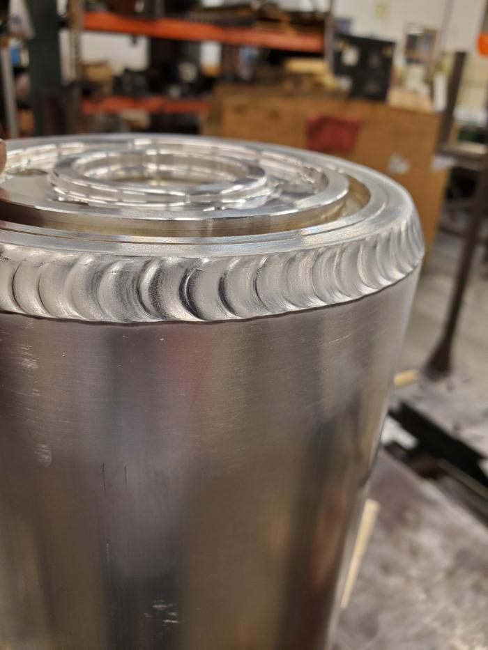

The store didnt have lanthinated but they had 2% ceriated so I tried those and what a huge difference...
The new setup I tried
3/32" ceriated w/ #6 gas lens
using some helium
set the ac balance around 7 and I feel like I could take even more cleaning out of it.
Dropped amperage down to around 175
The 3/32 electrode balled up quite a bit so I will try the 1/8" tomorrow.
using some helium
- 20200120_150720[47433]b.jpg (70.04 KiB) Viewed 4361 times
This is the fusion pass. Still doing 2 passes it just seems to make it look better in the end
Once I do a few more of these they should start looking better
